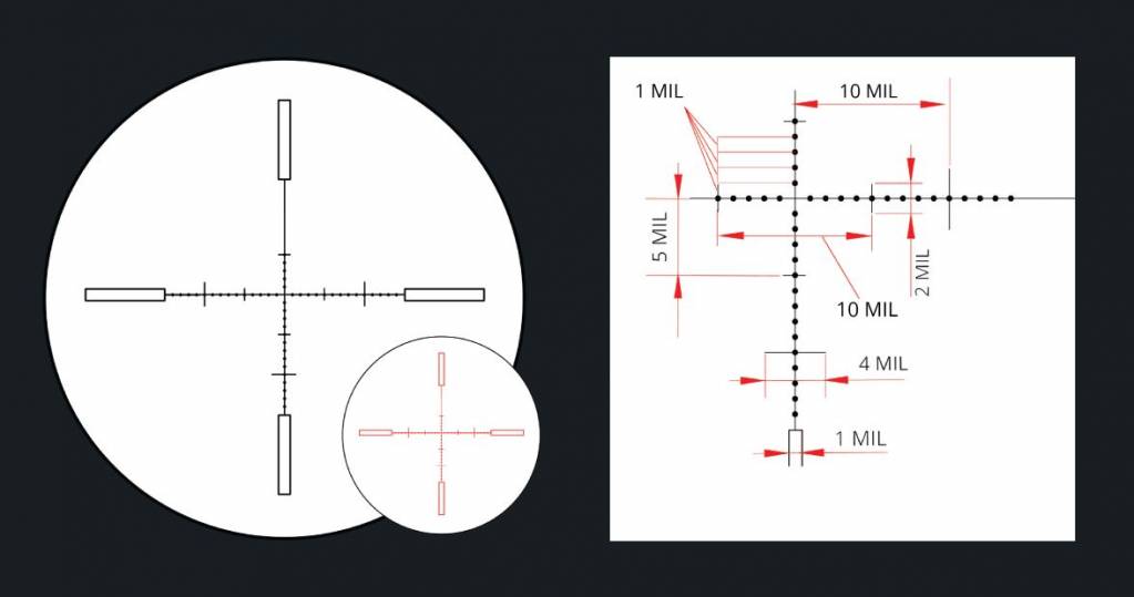

Dairyboy,
Thanks for your input...Nice Reticle as well. Sadly you lost me for my application on closer range:( FFP )...on 1X (large Field of view) because of FFP the Reticle / aiming point gets minuscule, However for mil dot dist. shooting I too like the Reticle on your Athlon. Yep, "Circle of Death" nicely put i.e. on a moving target anything within the "RED CIRCLE" Spray and Pray not so much! Jus' empty your Semi Auto Mag!.......... WhoYaaaaaaaaaa!
circles or chevrons are functional, like mil dots. they are not just designed to make the reticle easier to see. many are designed to use for movers,
so for example, for a man walking at a normal speed, you might put the edge of the circle, horseshoe, or chevron on him to lead him the proper amount. this is where FFP is important, because the reticle and that space is correct at any magnification. still works with SFP, but you have to be aware of what power you are at.
