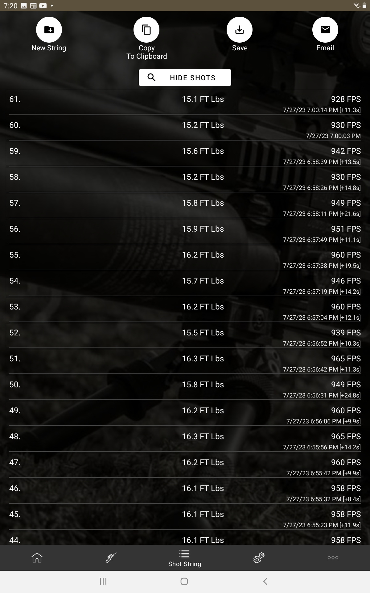

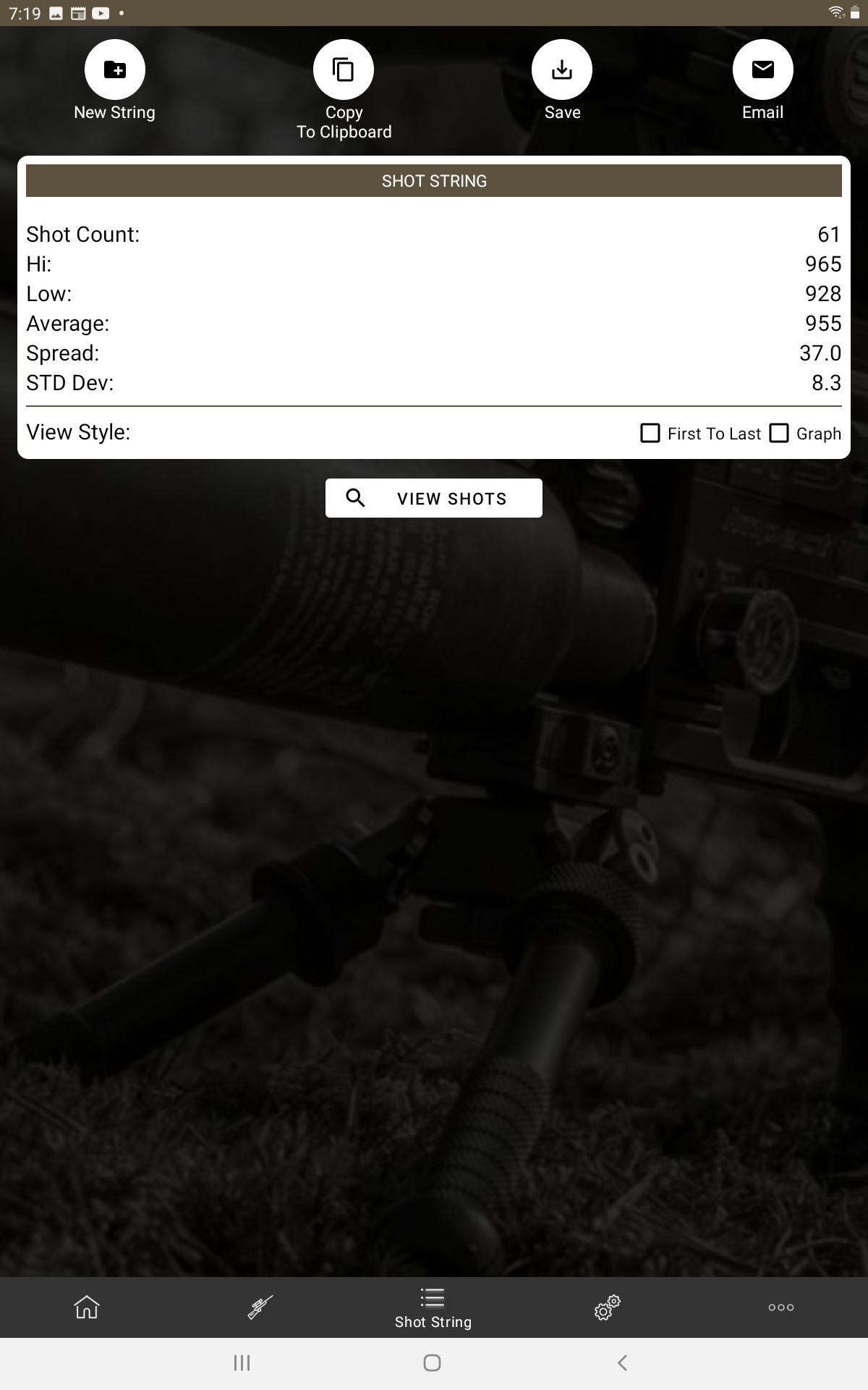

That’s great. Now we just need 19 more. Your gun is spot on for those 10.3’s. I noticed you posted the mini internet shot string. If your gun does that for all 60-70 shots and is accurate, it’s a keeper.

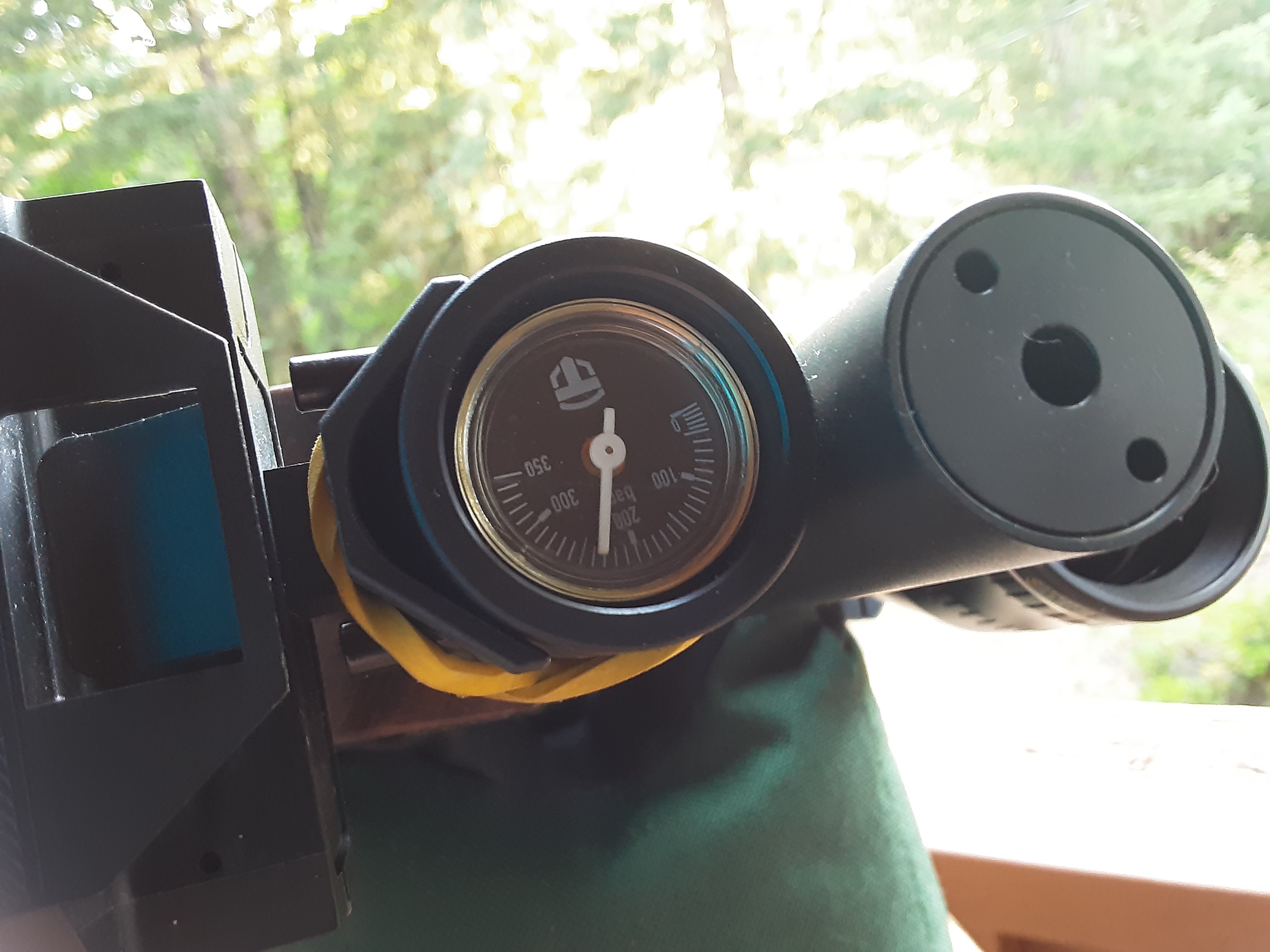

Here's a string from 230bar to 100bar. 250 bar is max fill pressure on the v1 Vets. CHPs 7.9g . The light crossman pellets are my worst for SDs, but there cheap. I usually don't use up my good ammo for checking full shot strings. If 20 rounds can't tell me what my SD is then there's something wrong. The vet really likes the 10.5s and haven't used anything heavier.
