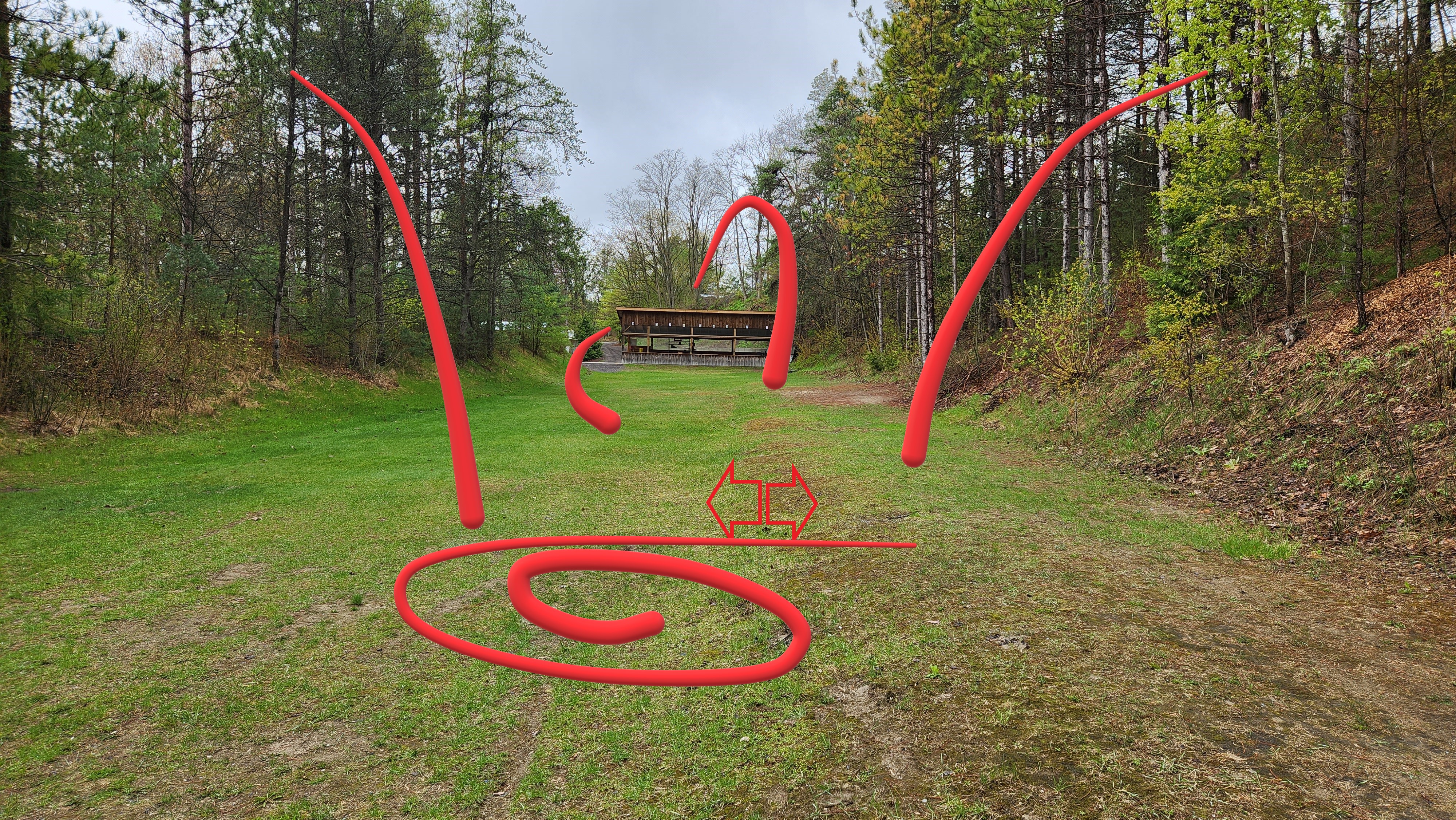

At my place the wind is pulsing, not a steady flow.
Also at my gun club the ranges were designed for pb's back about 70 or so years ago, high trees surrounding the shooting lanes, the wind hits from above and swirls inside.
Just one of the 100 M lane for example here, I tried placing many windflags... won't work...reading from grass or leafs and branches moving won't work neither. Pictured early in the spring, along the year is not a see through.
I would trade for a rain any day ;)
