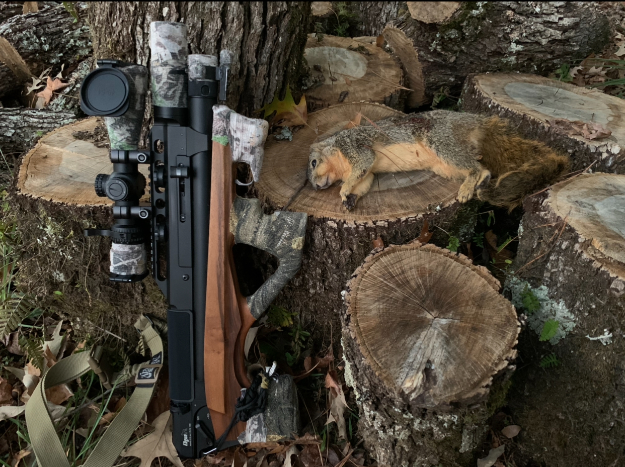

I figured a couple wraparounds on any part you'd want to protect when going out in the field would help to ward off unintended bumps & bangs with at least some protection & cushioning. A minute to put on, a minute to remove when done.
I'd be very interested to see some photos of a stock stocks wrapped up in this way.
If any of you have some, please post them.

You could always get some of that camo, wrap around "tape" like what's used for sprains in a medical setting. No adhesive on it but it sticks to itself. Just a thought.
FRESINIDER 9 Rolls Self Adhesive Wrap Athletic Tape Gauze, Breathable Elastic Cohesive Bandage for Sports Injury & Pet (7 Pcs 2"x 5 Yards + 2 Pcs 1" X 5 Yards) (German Woodland Camo) https://a.co/d/0oD5neE
This is the best wrap I’ve used.
GEAR AID Camo Form Self-Cling and Reusable Camouflage Wrap, 2” x 144” Roll https://a.co/d/bwLPxvp
