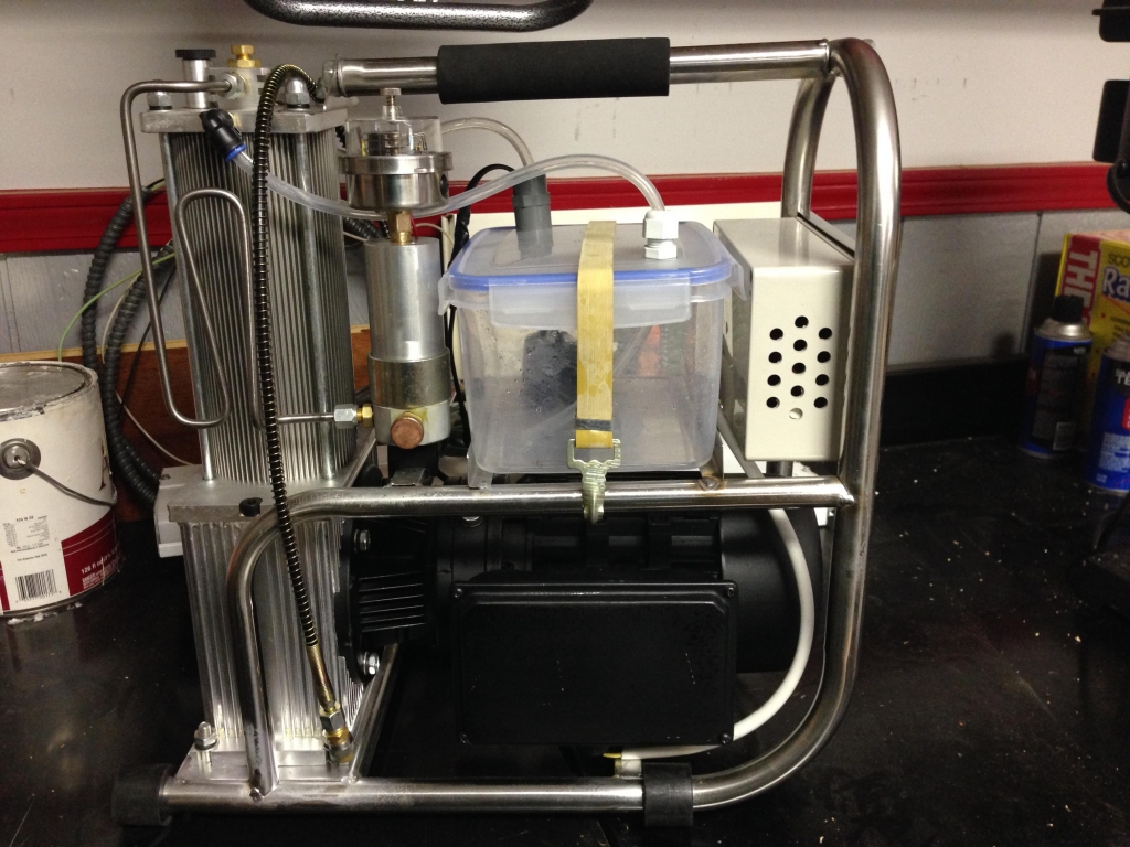

Well, I've had a PRE - Omega Air charger since 2014. No issues so far. Fill a guppy and tiger shark. I'd buy one again if I was looking for another compressor.
I've attached a photo of it right out of the box. I added a radiator, fan, hour meter and temp gauge very soon after purchase. Added the gold filter with molecular sieve about a year ago.
