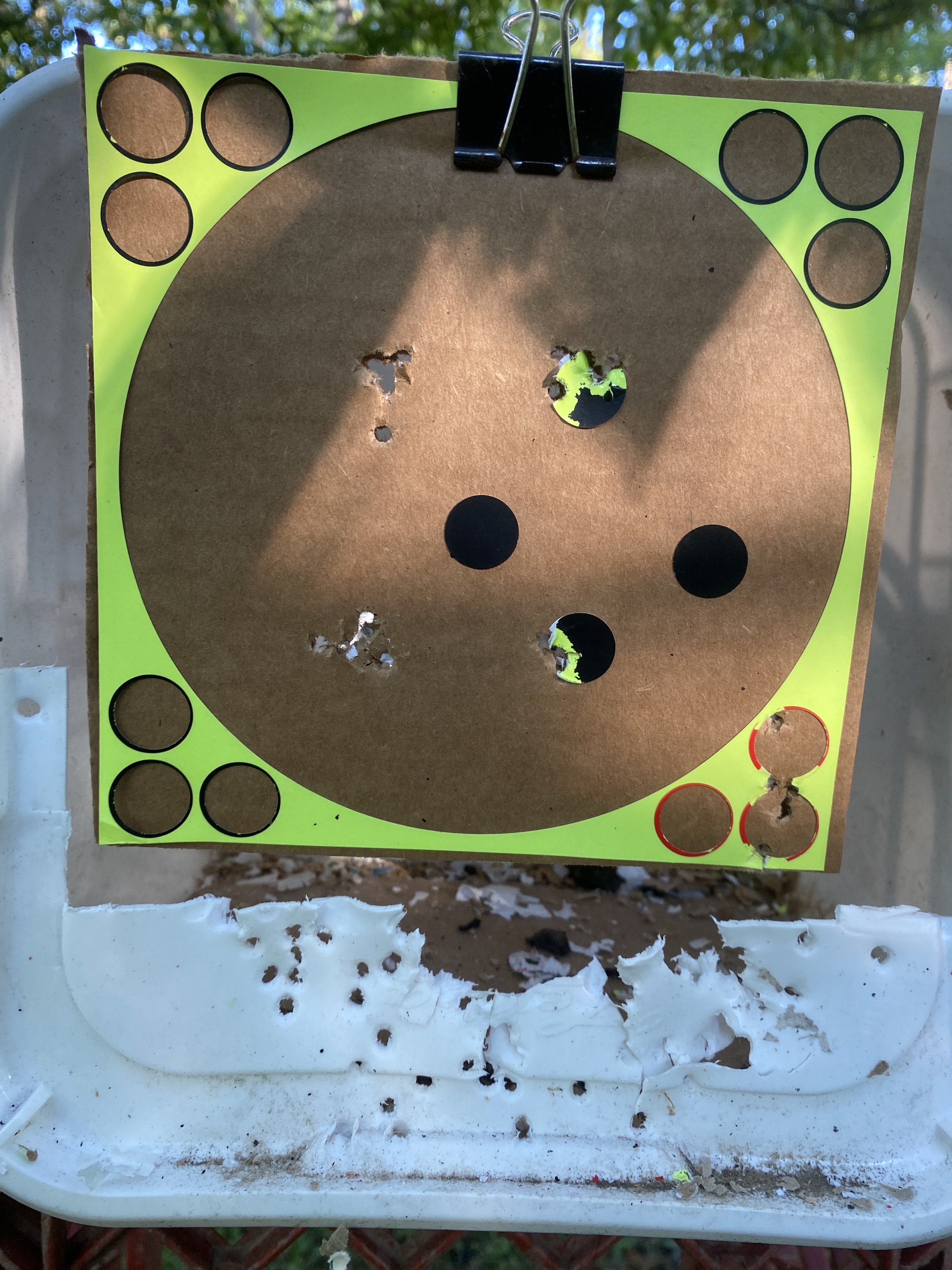

These groups casually sent after work CPHPs at 25 yards, definitely “pests approved” out to 50 yards. Not bench rest groups, but good enough for this pesting and plinking fool… BRK Pathfinder, TP on low…
Ahh, glad its not just my gun then. Thanks for sharing.

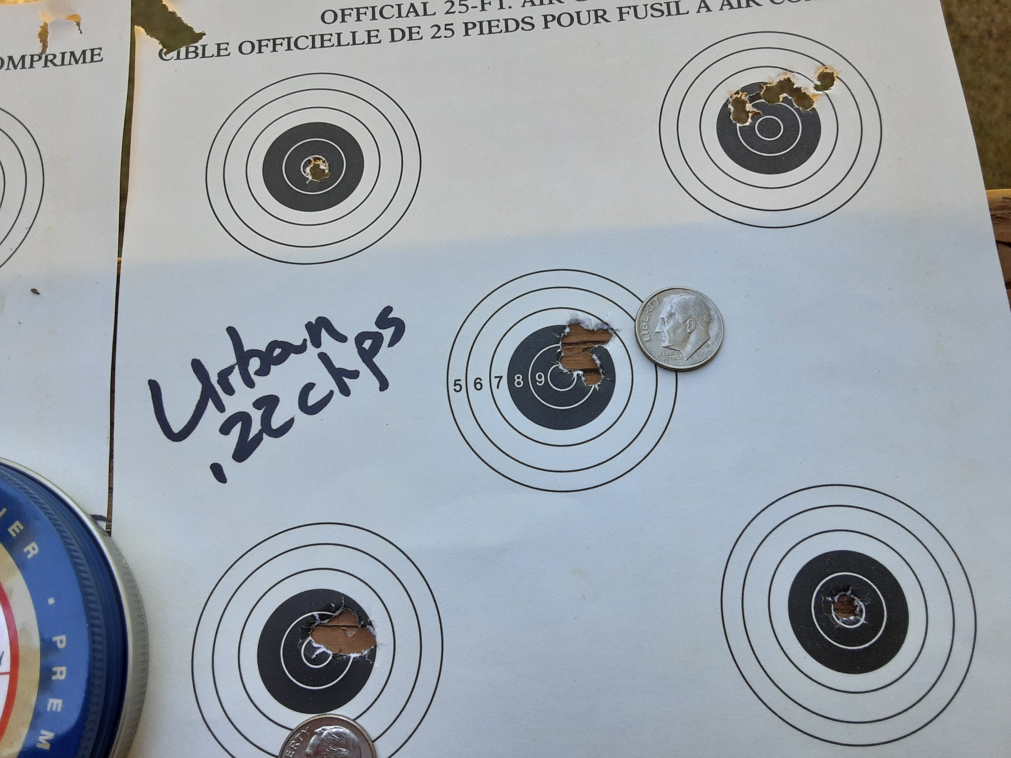

For 25-30 yards my Urban does ok with 14.3gr CPHPs at around 880 fps. The groups open up at 40-50y more than is acceptable, too me , for hunting. I am stocked deep for a doomsday situation and they do kill well . Just not my first choice in my higher power pcps or longer distances.
This target is at 25y .
