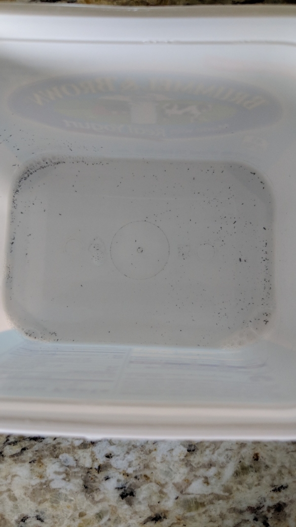

I washed the rest of my current open tin and a new tin (so about 700 pellets). I was quite surprised at the amount of what appeared to be small lead flecks that came off of the JSBs since I have never seen that in the bottom of an empty tin. What that tells me is that junk was mostly on, and perhaps in, the pellets. The
attached pic is what came out of the partial tin. There was proportionately more from the full tin.
