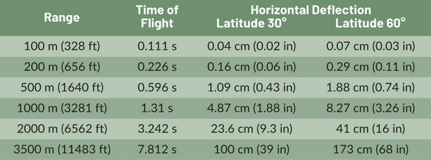

I can imagine this concept of spin drift working well, if the sensor input calibration is fine enough and it can fit in a sight system. I can see this used in an app with auto adjust reticle. I'm looking for sensors that can give me that level of precision output. The new sight doesn't have a cant issue to correct for. This is why I like learning from all the posts. More questions are raised than answered. Would left hand rifling counter the natural drift of the northern hemisphere? Don't blame me for the crazy questions, you guys lead me there!
Really depends how close to the equator or poles you are as well...way too complicated.

Yea, then add in twist rate changing the spin drift. Also the direction / azimuth you shoot INTO the earths rotation greatly matters. Definitely not a constant in every direction. Even your inclination angle will change the effect (vertical speed).

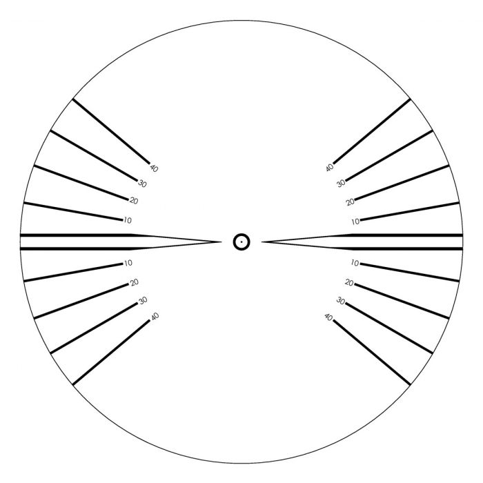

Just before I broke my wrist I used it a bit. I need more practice but it surely works. It will be a few months before I can shoot again so for now I cannot give specifics about it other than canting in the direction the wind is blowing from. The amount of cant I still need to experiment with.
Anybody with experience with it?
