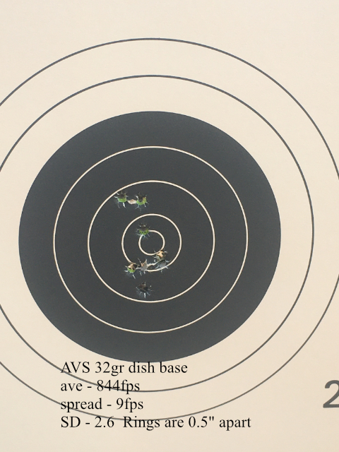

I just got back from the range and shot 6 different weights of .25 cal AVS slugs at 50yds on the factory tune. I shot the Leshiy 2 (350mm with a Tishina 200 moderator kit) off a Lead Sled. The best groups from the slugs were 32gr and 38gr. The best groups overall were with JSB 25.4gr and 34gr pellets.

AceRph - those results are pretty disappointing with the slugs. If the best group you can get with the L2 and JSB is over an inch at 50 yards then these guns are having some serious accuracy issues. I can't even get groups that small and there is always one or two flyers per mag.
Note - someone claimed 0.5" at 50 yards. No picture of the target so I'm calling B.S.

I have the L2 .25 350mm and so far I have not found a slug that’s accurate for me. I have tried nsa, vk, fx, jsb, and griffin. And all of them were loose in the mag. As for pellets the jsb mk2 34gr were the most accurate, the best group I got were 3/4” at 50 yards with winds blowing 15 mph. I haven’t played with my reg yet to see if shooting faster or slower will tighten up my groups.
