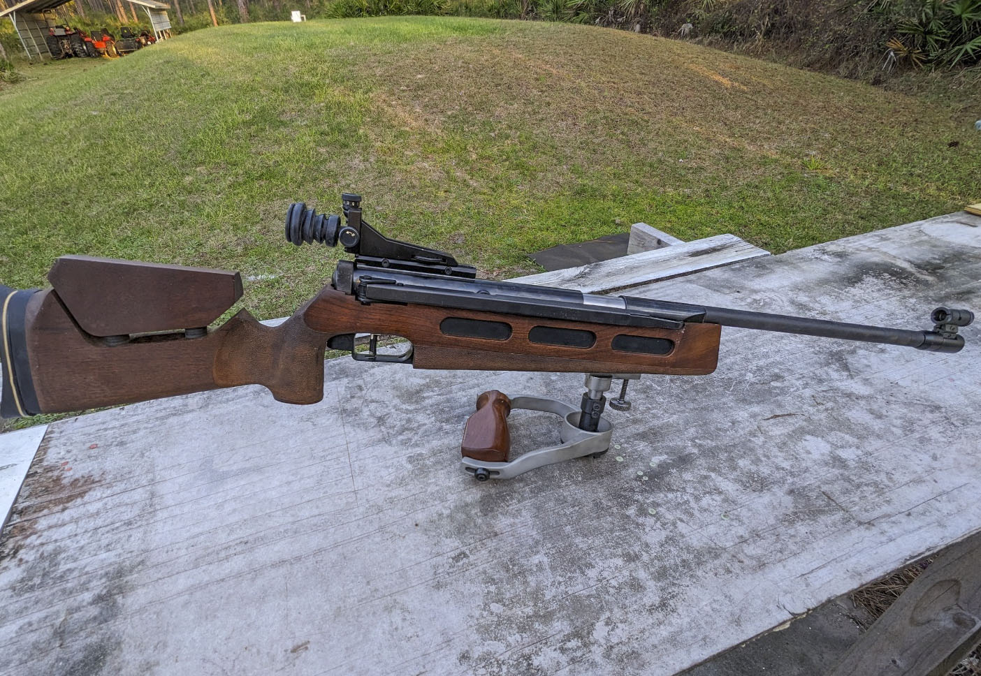

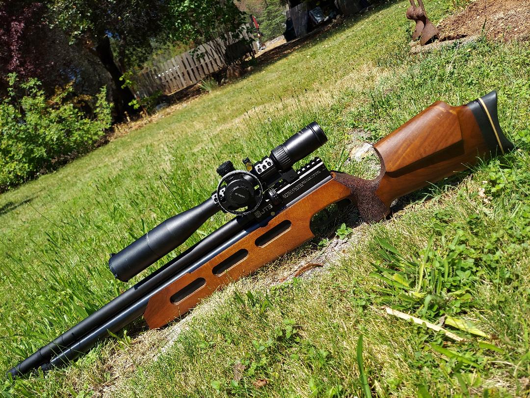

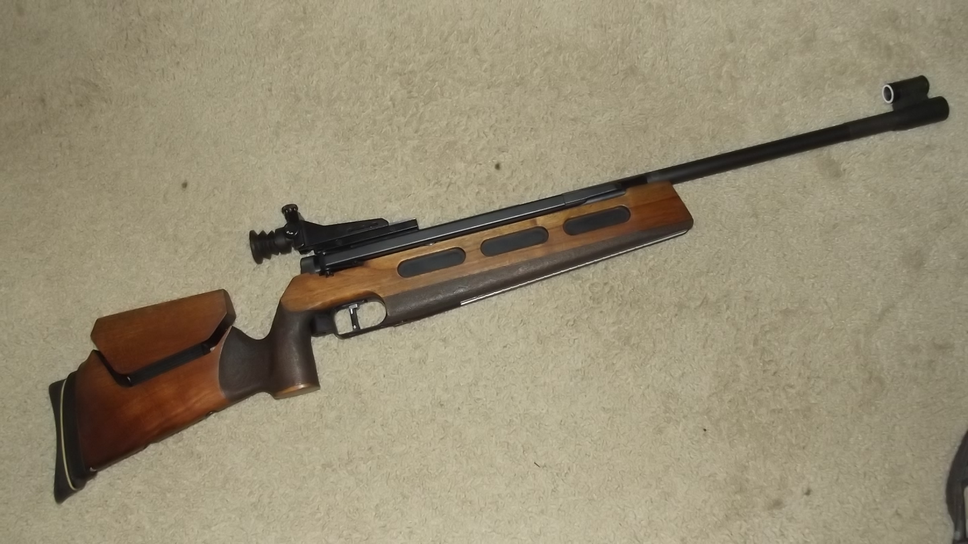

As a suggestion…Ruiz sports on eBay sells a LOT of the older parts you are looking for..nice old aluminum ball end butt hooks, and beautiful wooden handled palm rests. Also I may be able to repair your stock… if you can pm me with a photo or two, I could possibly make an assessment. Check out my post in General Discussion…Homemade stock to see how I milled the channel for the air tube. Anyhow..good luck John

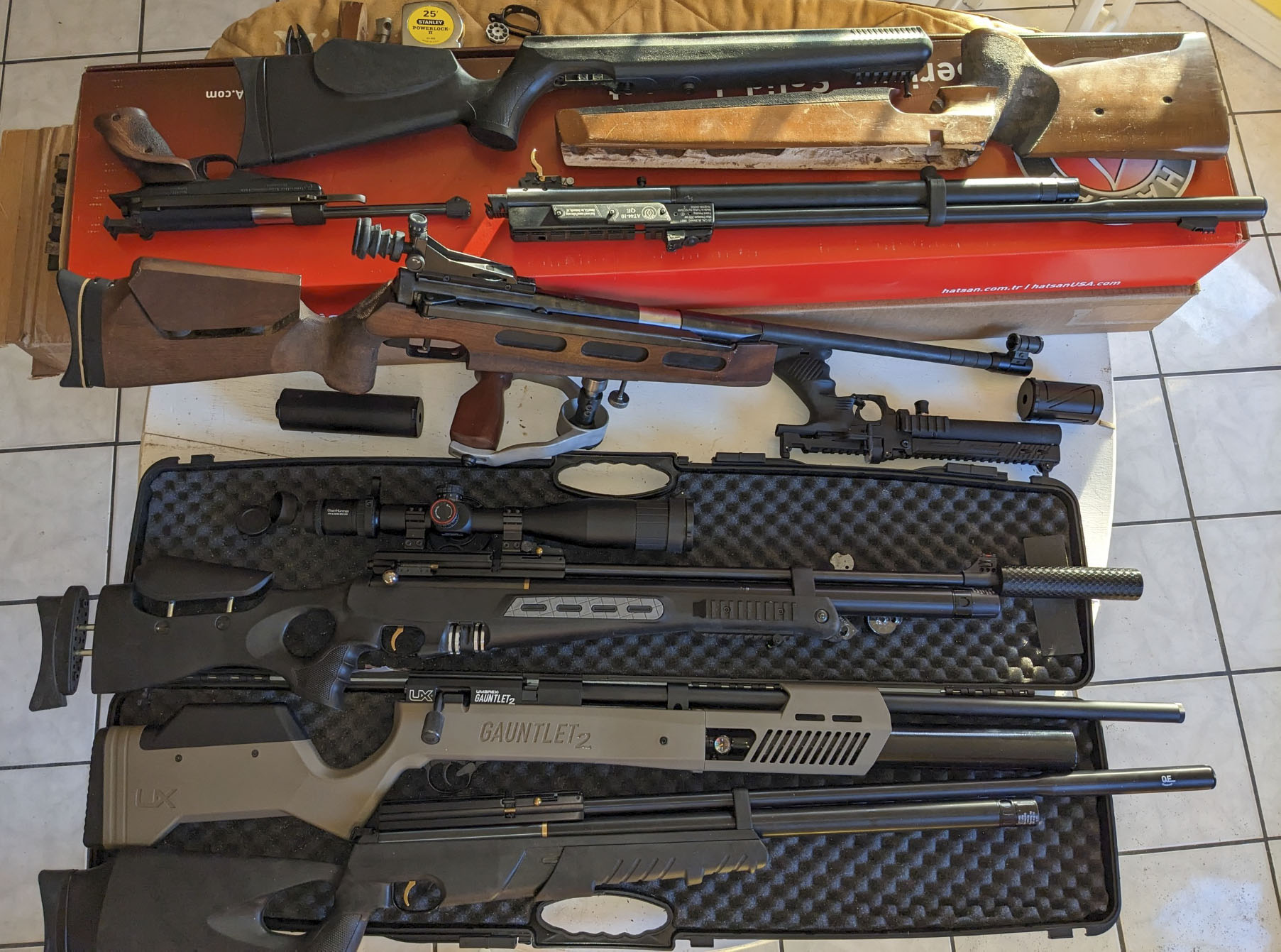

Attached photo of my 75, and the buggered stock is ontop of the red box. I havn't been a forum member long enough to PM.

From what I can see ….I think I could repair the stock you gouged…if you decide to go a different route..I would be happy to inlet it for you…if you’re in the area, look me up. Will send you a PM with my contact information. John
