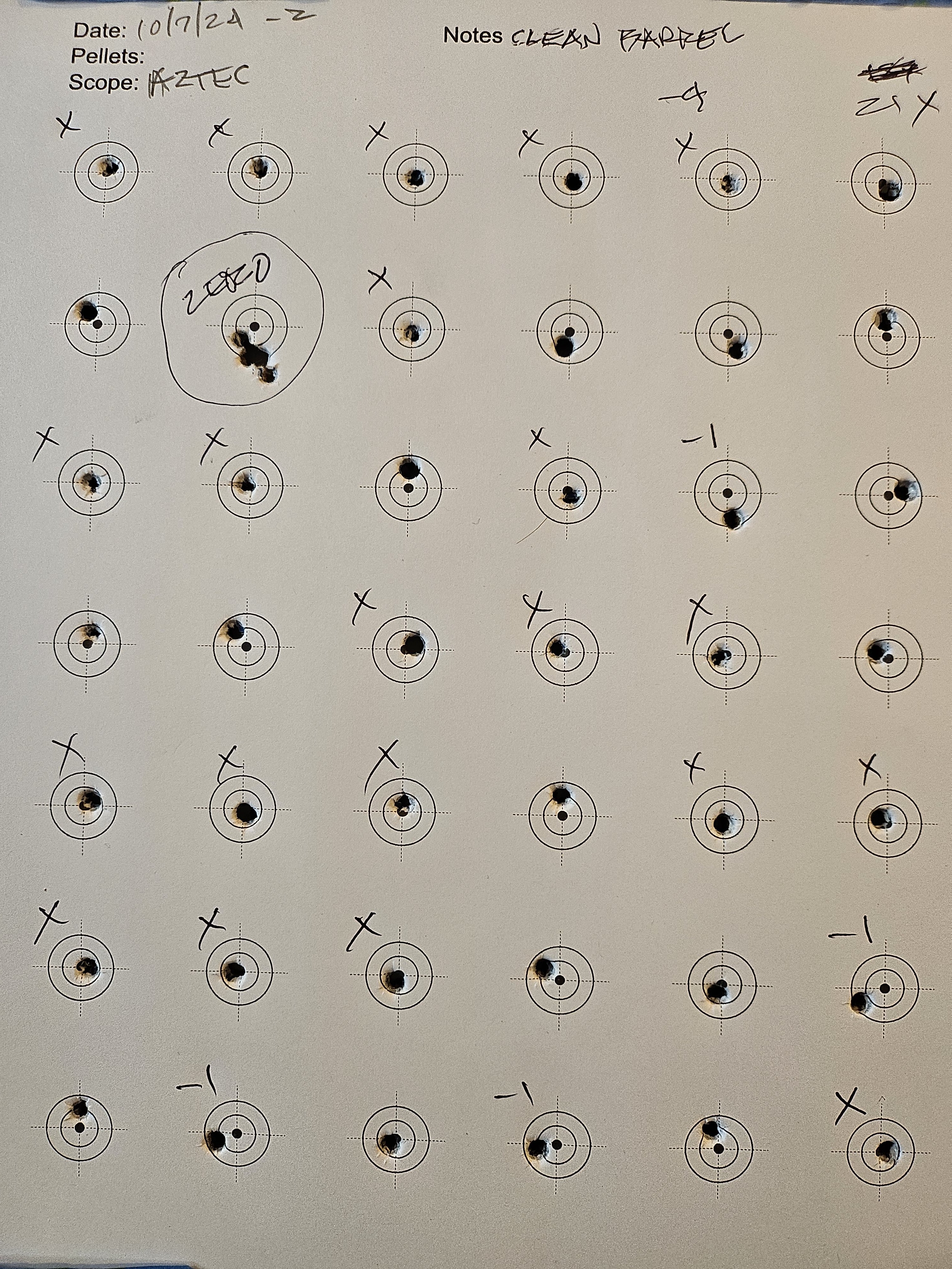

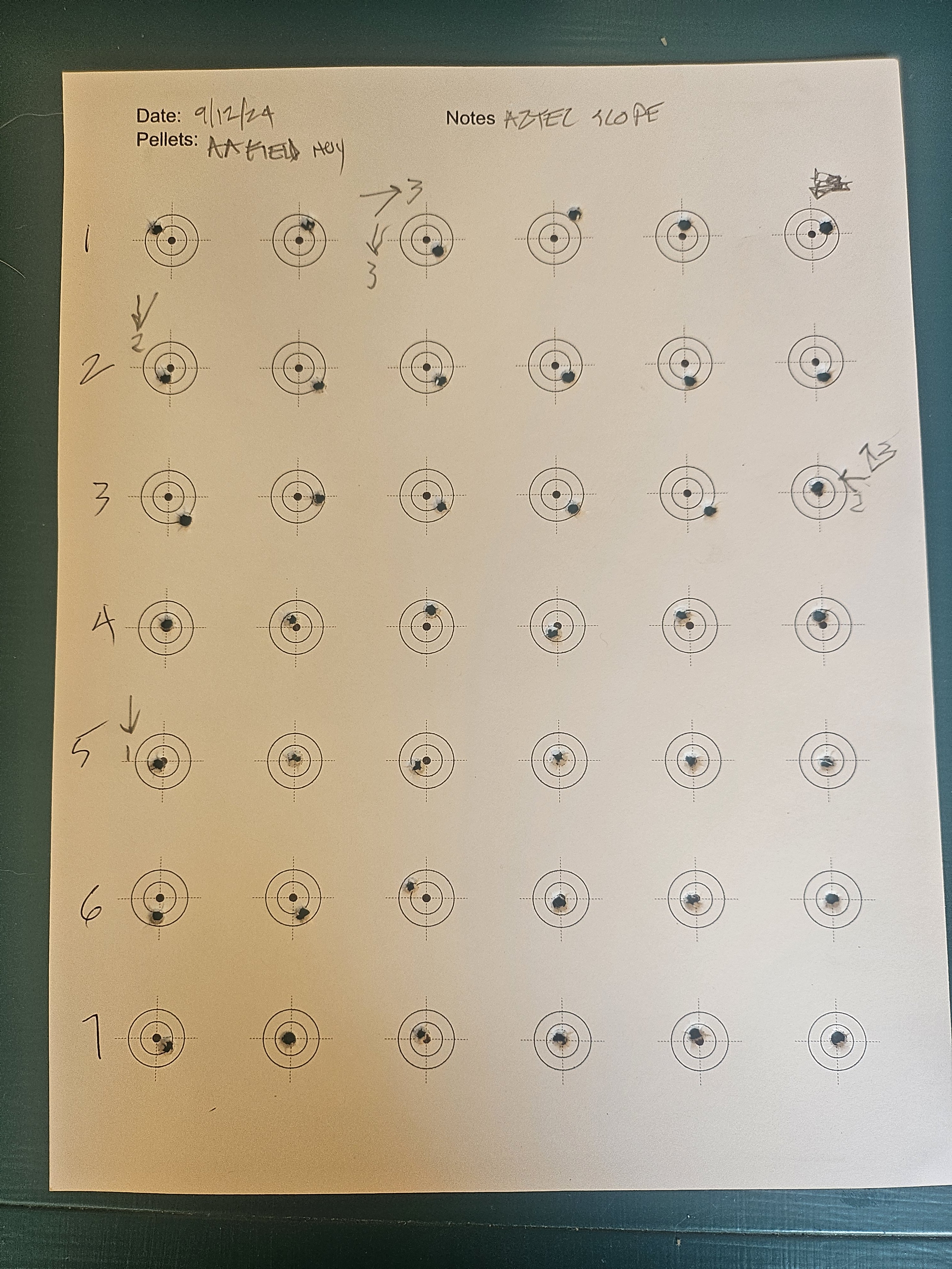

Today I was able to clearly document the problem I'm having. Shot a bunch of targets from 25 yards on the bench. Top row I'm trying to zero. Finally give up at the start of row 2. The scope immediately shifts low right. I kept shooting the bull and every shot goes exactly in the same place.
On row 5 i finally adjusted the scope and got back on center. There are 3 weird shots on row 6 but everything else is either an x or a 10. The problem is clearly not me or the gun. This is the most precise shooting I've ever seen from any gun I've owned.
Now, can I find a scope that will stay still?

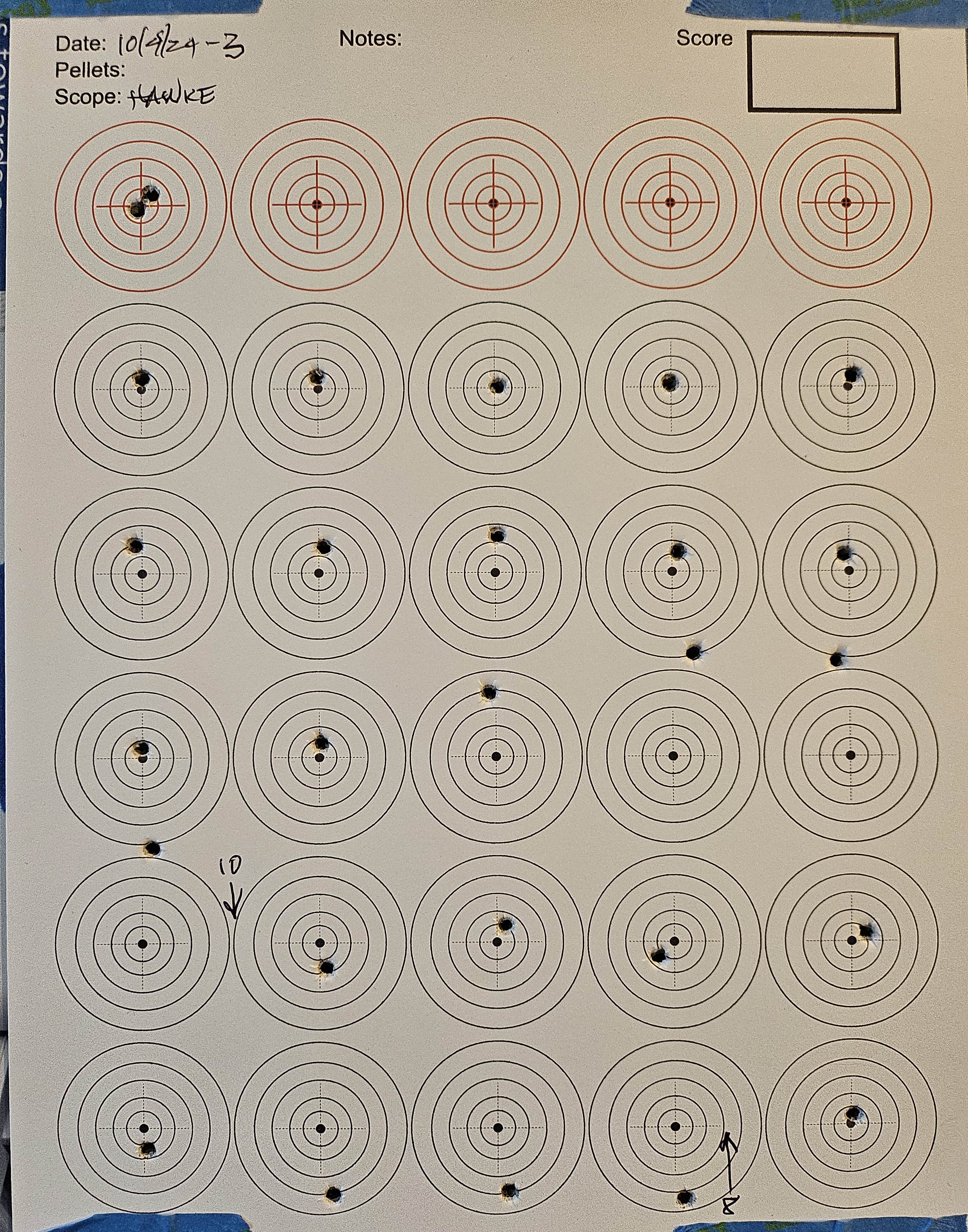

I'm shooting my 97 right now. It's one pellet on top of the other at 25. Every 50 shots or so it moves an inch across the paper and starts another tiny hole. I'm getting good at cranking it back on the dot. But that's the kind of practice I can do without.
I have had good luck with the Hawkes. They do a great job and are a value. When they start blowing your patterns it gets frustrating.
A good scope and mounts are more important than an accurate rifle. An accurate rifle with $h!tty scope and mounts is an abomination. I'm going to get the leupold for the HW97 and I might try a Sightron on my 95. They are too darn accurate to fiddle with scope problems.

It seems like after a couple thousand shots without cleaning my barrel I get more flyers. I can still shoot great 3-5 shot groups but if I shoot 20 shot strings few will be off a half inch or more. With a clean barrel the same 20 shot string is a lot tighter. One hole.
....or so it seems.
I pull a dry patch through my guns fairly often. I'll use some penetrant if the patch is very dirty. It's not really about accuracy. It's about a super dusty environment.
If I was shooting long strings on paper I'd probably clean more often. It's tough to hit a tiny dot repeatedly. That's quite a feat to shoot a target like that!
I thought you were only supposed to clean infrequently. I never cleaned my barrel much before, but I started getting wild flyers all over the place. I was blaming my scope but then I cleaned the barrel and it went away immediately. Just a few days later it started again. Same thing. Now I'm counting how many pellets before it starts again. Interesting to see if it recurs at any particular interval. I'm shooting pretty standard air arms heavies made by jsb.
It also probably depends on the barrel.
Definitely. Probably a few other factors too.
I clean the beer catalyzed hand cheese off the Hatsans almost daily. I feed every pellet with fingers that look like fajitas. We shoot in a sand pit that is mostly clean sharp silica.
No telling what kind of abrasive, adhesive goo gets in there. No telling when it starts to affect accuracy either.
A pellet rifle does not have to be cleaned very often. Or at all. It just depends on the gun and all the rest of the factors involved. It may never need cleaning in one case. In another it may need cleaning often.
A guy who shoots paper for accuracy would really know what's best for his situation. A plinker might not notice. Unless I'm shooting targets at the limits of my rifles capability I generally don't notice a slip in accuracy. If I do a good cleaning is the first thing I do.
