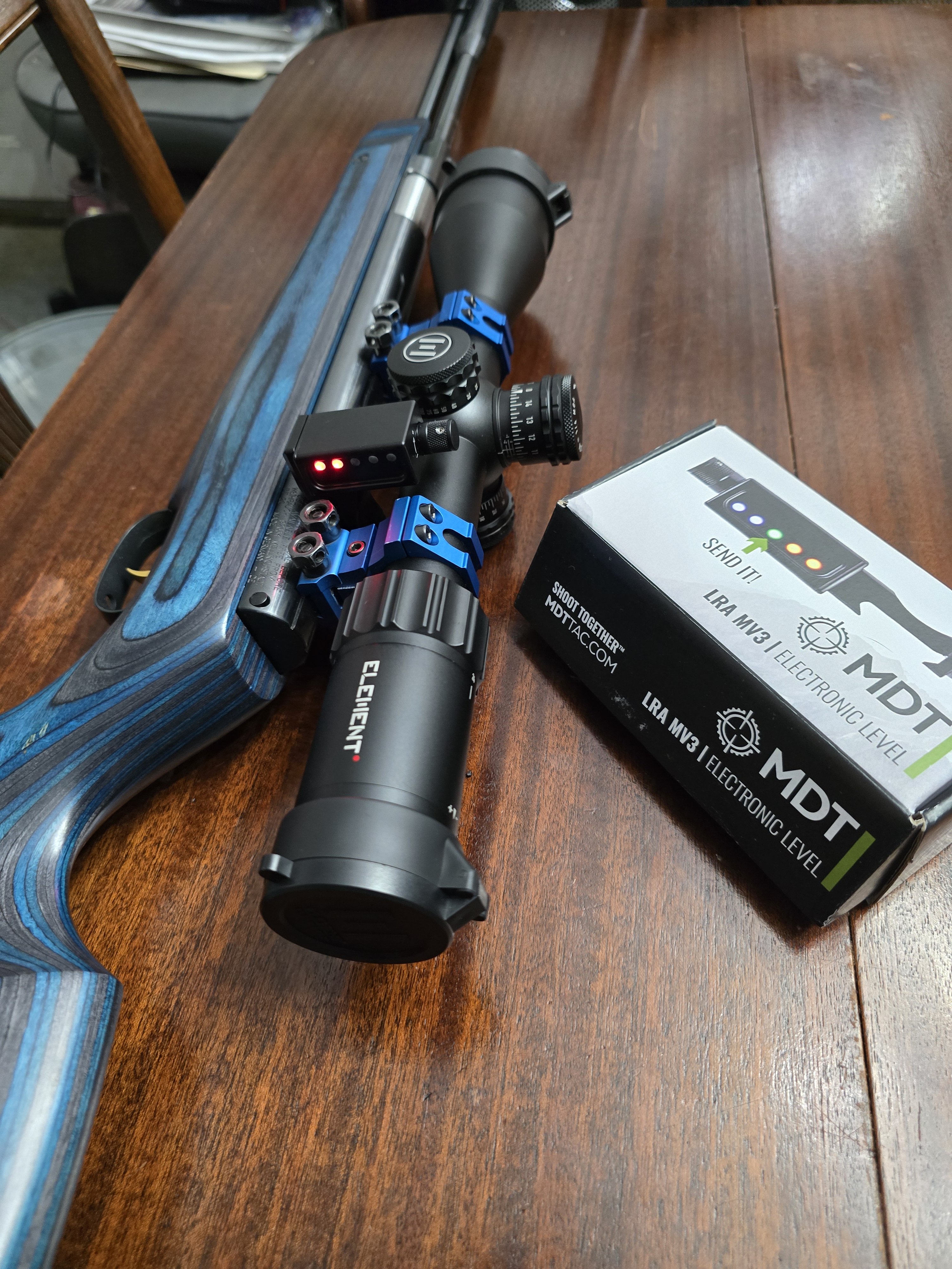

I have been on the same page trying to deal with "cant" error.
I have been shooting 75 yards at plinking targets and occasionally drop back to the thirty Yards range, so I need accuracy and mobility. I use two different shoulder bags for switching ranges.
I wound up purchasing an "MDT, Send It" unit and realigning my scope to match it with a plum-Bob out at 75y.
Now I am having elevation problems as I try to figure out repeatability on my check weld and grip. 👍

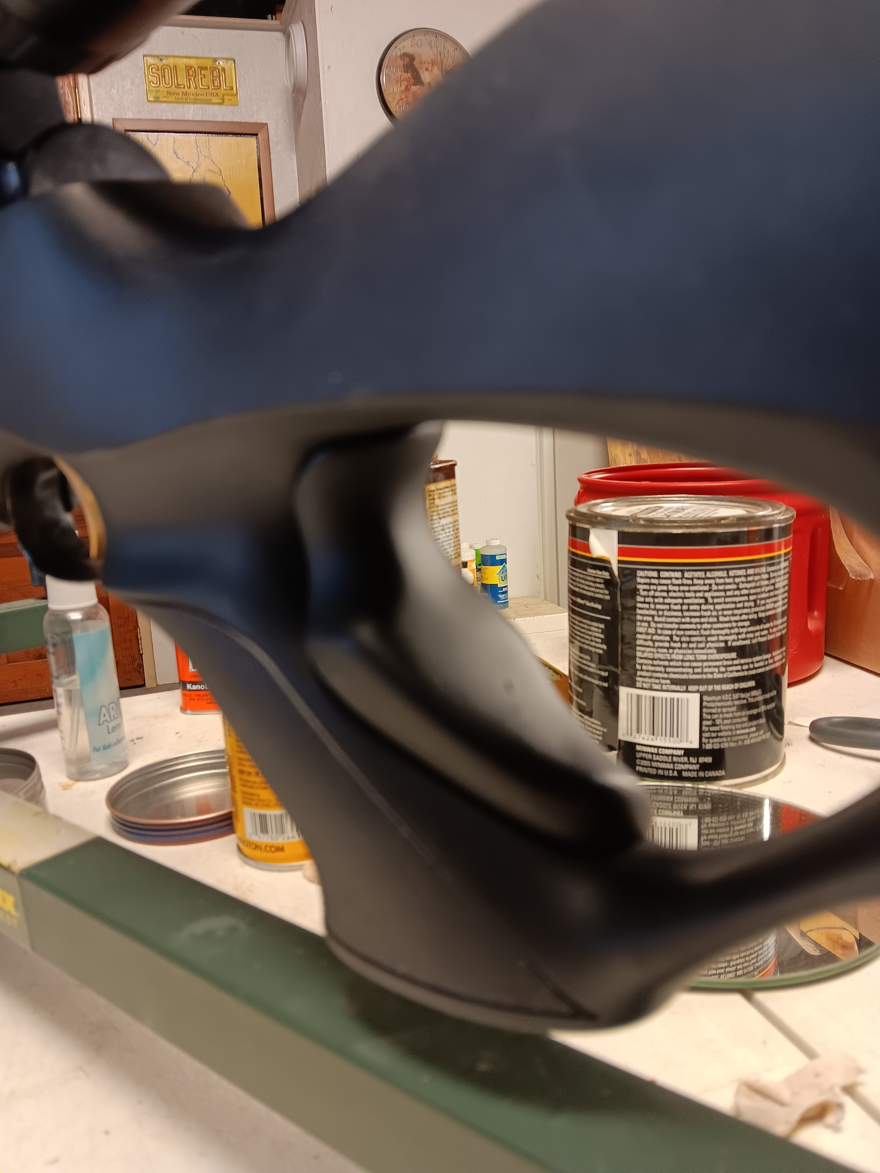

My 97k was WAY too skinny in the grip. Trigger position was always an issue. I couldn't get my hand on the rifle when my finger was on the trigger. Getting a consistent position without drag on the trigger hand was impossible.

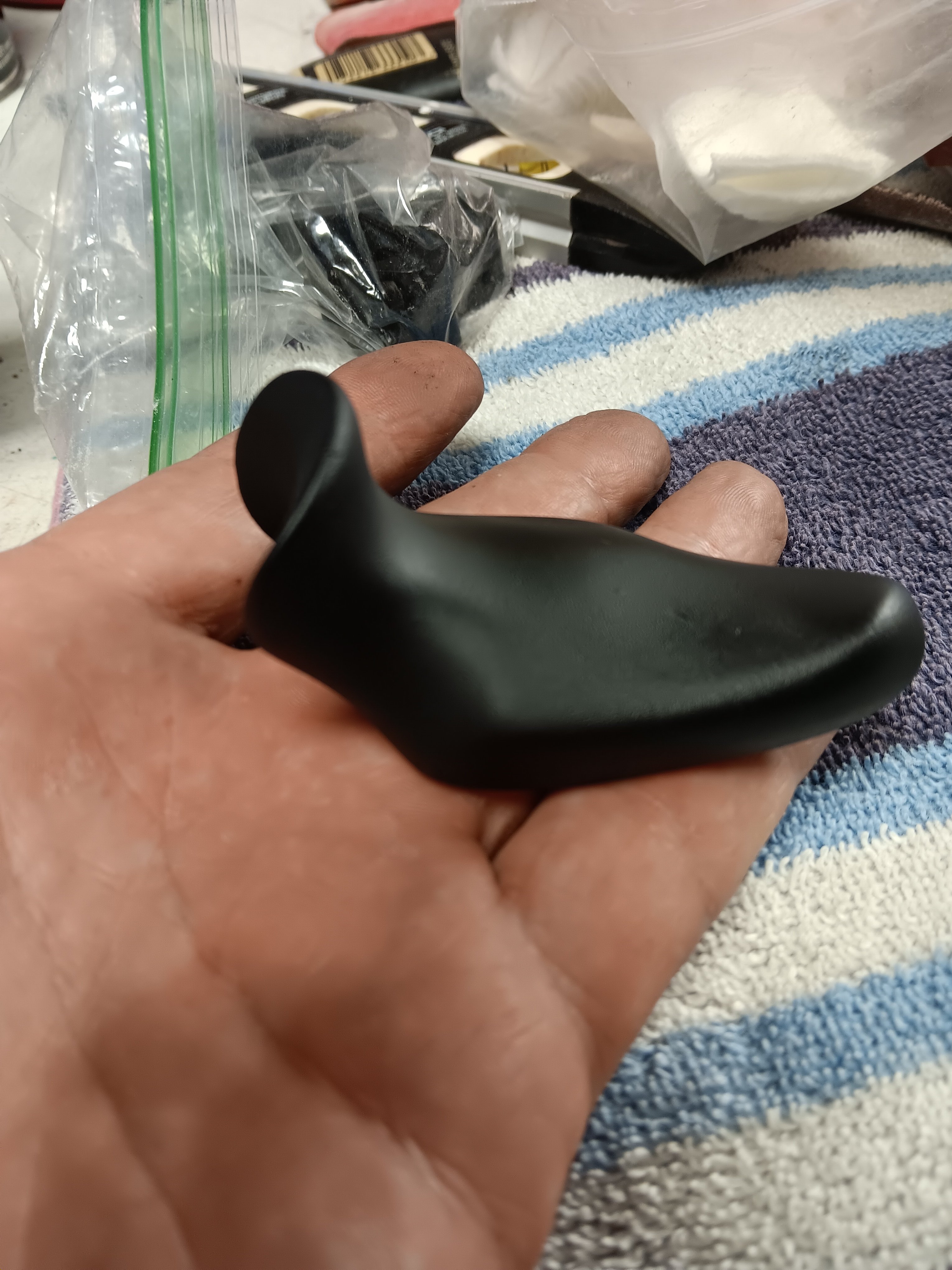

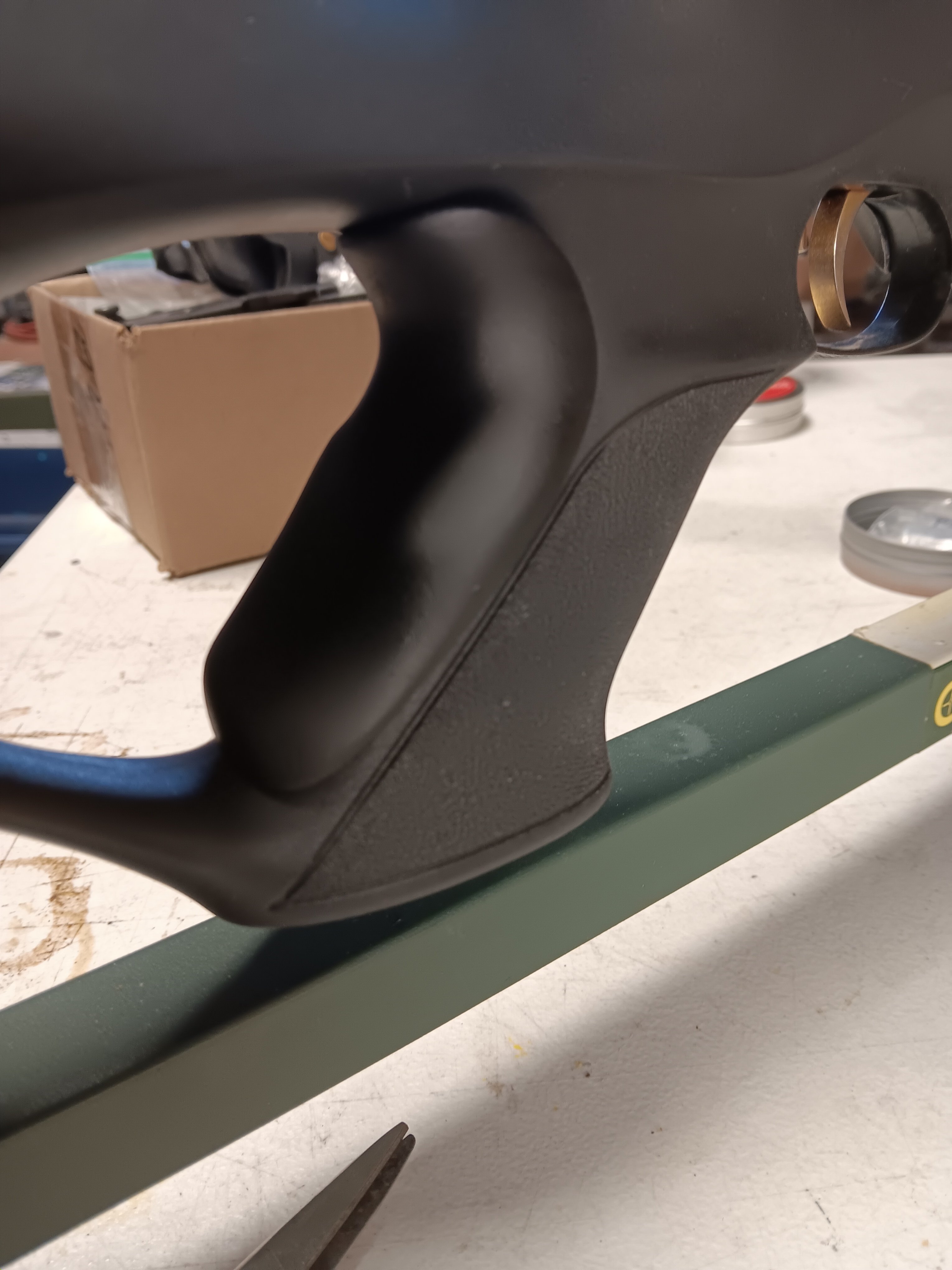

Easy fix. A form fitted grip shoe. Trigger control improved by 1000% and my groups are much more precise. It made holding the rifle properly much easier. My finger indexes the trigger the same every time and my palm is squarely behind the recoil rather than dragging down the side or hooking my finger.
It made a huge difference in offhand shot control. The rifle is heavy and you need both hands to shoot it. Before when I mounted the rifle I always had to correct the cant because I had no contact on the grip. Now the rifle comes up straight and solid. I can hold a shot much longer and have a lot more control. Trigger timing is easy without all that slack in the grip too.

Bob will you elaborate on the form fitted shoe, how to or where to get. Thanks

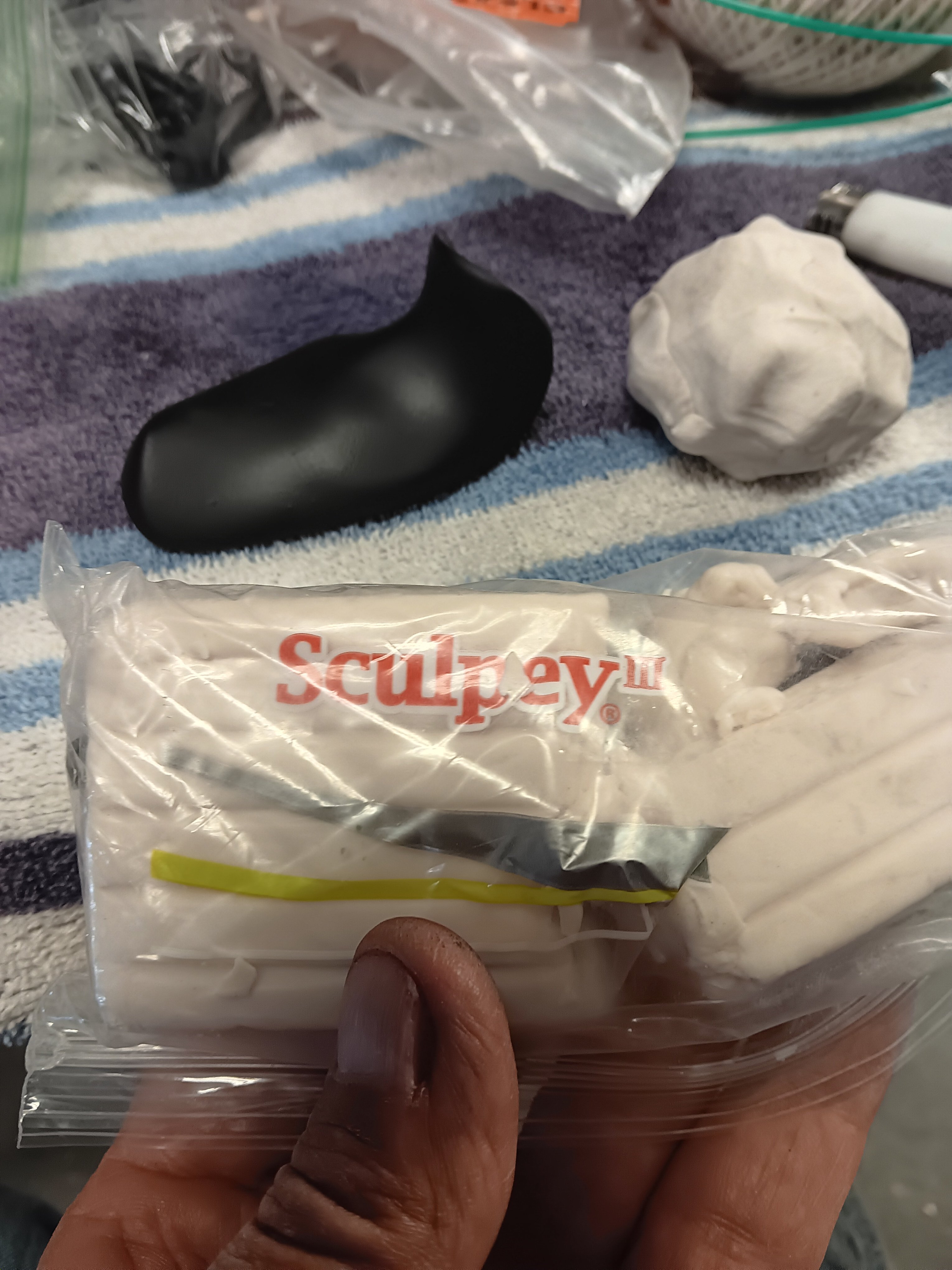

I made it. It's PVC clay.
I used modeling clay for a mock up to see exactly what I needed. Then got a lump of PVC clay and formed it.
Here is the clay. You can get it in any color and mix it to get any pattern. I used flesh colored clay because that's what I had. After it's baked it gets solid. I profiled the finished shoe with 120 grit paper and sprayed it with flat black to match the stock.
Easy as pie and fits the rifle like a new set of dentures. Weighs next to nothing.
I've made dozens of these for semi auto pistols and revolvers. Rifle grips too. It's the cats meow. Your hands work it into a perfect fit. When you grab the rifle it feels like a new pair of shoes and your finger lays on the trigger in the same spot always.
