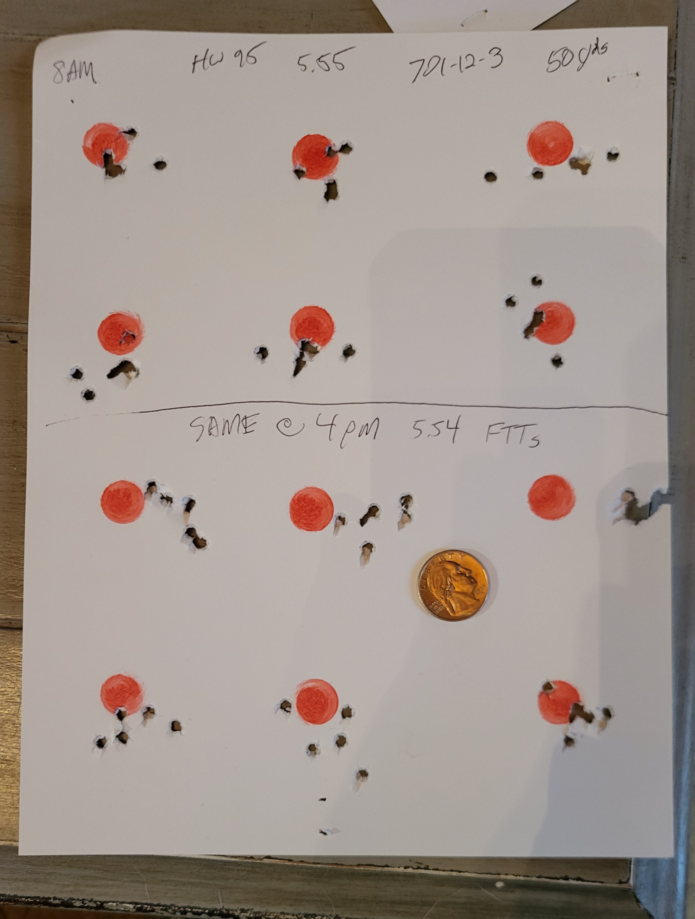

Here's what I'm getting. I'll get one or two good groups out of the page. And the rest is all over the place. I normally shoot in the morning or late afternoon when the wind is nil. This morning I must of had a slight cross wind with the 95 because the gun was shooting a bit right this afternoon. I went 8 clicks left on the last three groups. The R1 was shot in near dead calm.

All looks within acceptable accuracy limits to me, especially for break barrels. I've always felt the under levers were a bit better at distance, because of their added weight. I think your green laminate needs a brother in .22cal 😁
But really, about nearly every group there looks to have at least 4 of 5 shots on a nickel @50y ...with a spring piston gun. Most folks probably put 4 of 5 on a fifty cent piece @ 50y. I'd maybe look to experiment with different rest materials if you want to tighten grouping further, I'm sure you and those guns are more than capable.
These groups look great to me. I have crazy wind to deal with at my range. There are at least four different wind currents between me and the target at 55 yards. I have simple marking tape tied to arrows for flags. Many times they are all moving and usually in different directions. Once in awhile in the morning it is calm. Next time the stars align and the flags are not moving, I will shoot some groups.
