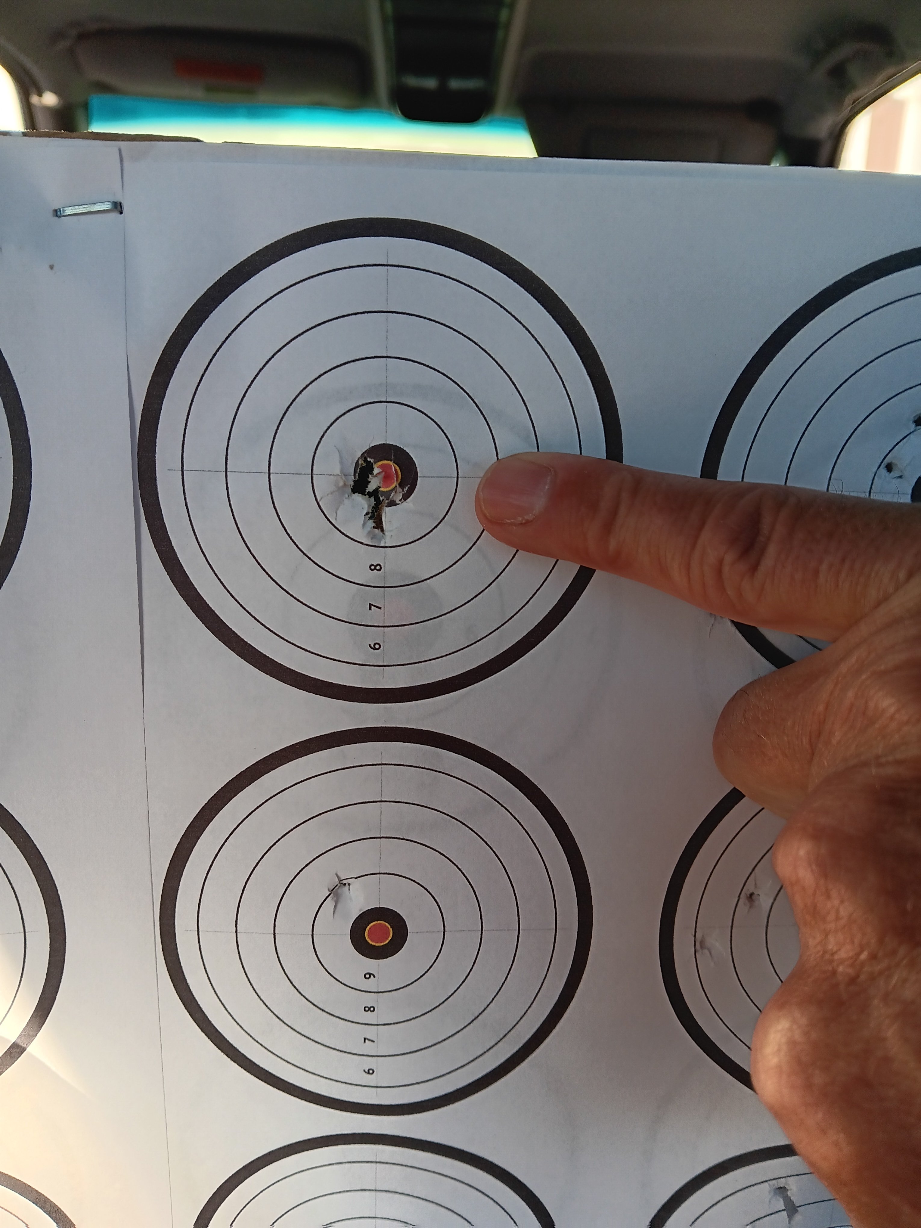

Well sort of. I tried the tripod thing a little this morning. I shot my old reliable 20 cal R9 to make the comparison. The first two rows were shot in my traditional hand hold. Only 1/3 were wider than a quarter center to center. And those that couldn't were close. It's about what I expect from a decent springer.
Then I switched to the tripod mid page. First row. The three groups were with the gun rested slighty ahead of center of gravity. The next row was shot at the CoG. One third of both rows were slightly wider than a quarter ctc. However the groups were clusterd tighter in general with the tripod.
The tripod definitely shows promise. The gun was only settled on an old gun towel. I'd probably get better results with a different buffer and practice. I will say that it takes longer to return to battery and doesn't feel like real shooting to me. It is probably a good way to test accuracy potential.

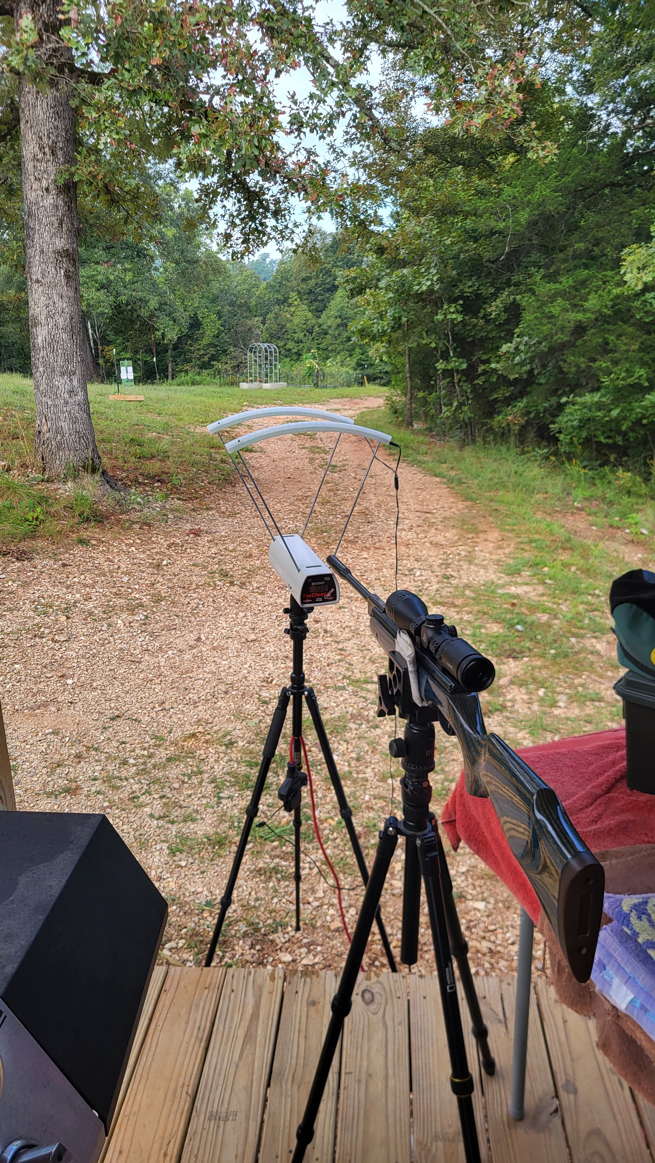

I put the rest BEHIND the CG a little making the rifle a bit front heavy. Not much. Just enough to force the rearward recoil to lift the weight of the gun.
Shooting off a tripod. Here's how I do it. Maybe something I say you can use...
I find my foot position and my elbows locking into my knees are the key to accuracy. My patterns are tighter with heavy canvas pants that don't slide under my elbows. I get my feet planted just right and both my elbows locked on my knees. I get my body angle perfect and fuss with the tripod height. I close my eyes and mount the gun. Then open them. If I'm not on target I adjust my position or height.
I never bring the gun "on target" from a rest. I always bring me "on target" behind the gun. I don't shoot unless the whole ergonomic scene is settled to perfection and the gun naturally centers on the target.
After the shot goes off the gun will settle back on target. If it dosent something needs to adjust. Follow through with the shot until the pellet reaches the target. Notice where your crosshairs wind up after the shot. Use that to improve your shooting position.
After the shot the tripod will move. You will scoot around loading the gun. The whole process starts anew with every shot. Close your eyes. Mount the rifle. Adjust as needed.
