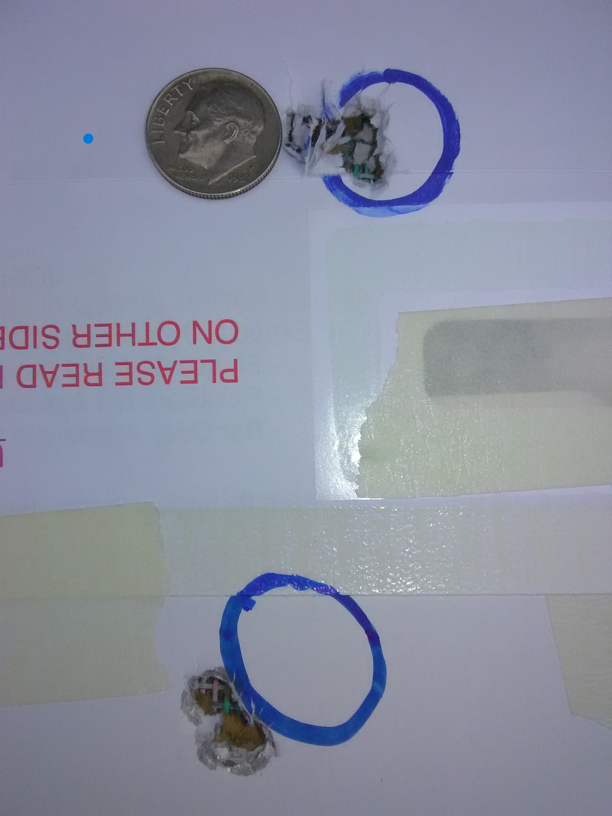

Preliminary testing complete, Uragan 2 and Vulcan 3 don't group this pellet, FX Wildcat MK3 Sniper, does. Wildcat is MK3 "Second Variation," single AMP reg, needs stock removal to adjust, tube reservoir. Shoots JSB 44.75 @ 851 FPS, SD 4.2 with Reg @150, Power Wheel maxed @7. Target (50 yd.) shows (3) JSB 44.75 in top group, (3) ZANS BR100 (56 grain) in lower. No chronograph work completed but impressed. WM

Preliminary testing complete, Uragan 2 and Vulcan 3 don't group this pellet, FX Wildcat MK3 Sniper, does. Wildcat is MK3 "Second Variation," single AMP reg, needs stock removal to adjust, tube reservoir. Shoots JSB 44.75 @ 851 FPS, SD 4.2 with Reg @150, Power Wheel maxed @7. Target (50 yd.) shows (3) JSB 44.75 in top group, (3) ZANS BR100 (56 grain) in lower. No chronograph work completed but impressed. WMView attachment 410552
