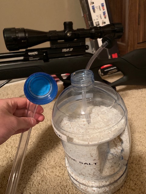

I use a desiccant filter I constructed which consists of a 2qt jug containing primarily calcium chloride salt with a dip tube that sits about 1/4" off the bottom. I use it with my Hill MK3 pump. The top of the jug contains a felt filter in the top that acts as a particulate filter. I do not use the moisture removal kit on the Hill MK3 I only use the pump attachment part of the kit. I attached an air hose quick disconnect - male on the Hill pump and female on the hose. When not in use I obstruct the dip tube. The system is hermetically sealed if the dip tube is obstructed which eliminates unnecessary use of the desiccant.
The calcium chloride salt I am using is popularly known as "damprid" and the MSDS sheet is available at https://damprid.com/wp-content/uploads/2017/07/DR_Moisture_Absorber_SDS-FG01K.pdf  I am not affiliated with "damprid" in any way and use it because it is an easily accessible way to acquire calcium chloride.
I use this system because it provides positive visual feedback for the current moisture level of the desiccant and works very well. Leaving a single granule of calcium chloride out in the ambient air will result in it becoming quite moist in a matter of seconds in my location. It also provides a large amount of medium for moisture removal and was inexpensive. After 10 pumping sessions there is a noticeable salt-moisture ball near the dip tube about the size of a half dollar and spherical in shape. I often pump from 70-100 bar to 200 bar. Upon completion I have never observed any sign of moisture around the bleed screw. I have filled the air gun on 3 occasions under a covered porch while it was raining with no fear of moisture ingress.

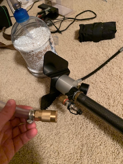

Quick disconnect fitting, the vinyl tubing is placed around the blue top, there is a nodule that sticks out that originally held a plastic drinking nipple. The fitting on the Hill MK3 is covered when not in use to prevent debris ingress.

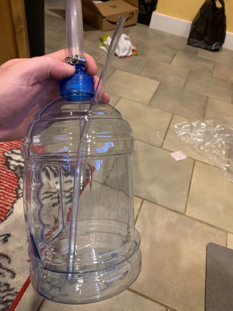

Initial construction of the bottle prior to filling with damprid ($10 USD 'bucket' in the RV section at major retail stores). The hole drilled into the bottle to accommodate the dip tube is smaller in diameter than the flexible tubing allowing for a seal to be formed. At the bottom of the dip tube that is sealed off at the very bottom there is a hole drilled the same diameter as the hole on the air intake for the Hill MK3.
The dip-tube thumb screw to seal the system off hermetically to keep the calcium chloride from processing moisture in the ambient air when not pumping is shown below. I had this part lying around but anything to block the dip tube would work fine.

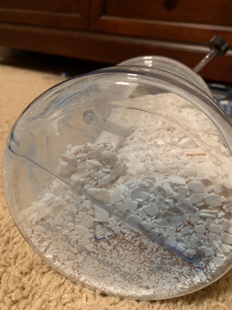

The salt-moisture ball I was speaking to earlier. This shows a mild amount of moisture has been collected by the calcium chloride salt. If you've never used "damprid" before it turns to a salt-water solution when no longer capable of adsorbing water. By having the dip tube below the surface of any potential water collection I've maximized the filter medium exposed since air is drawn through the dip tube to the bottom, through the filter medium, and out from the top into the hand pump. Additionally, if any salt-water solution were to exist in the bottom it would not be drawn into the pump and would also be clearly visible. In the picture below the black/brown circle on the dip tube is actually the drilled hole the same diameter as the air intake hole on the MK3. The goal here was to ensure a reasonable air flow rate into the filter medium to maximize moisture removal. The end of the dip tube, aside from the drilled hole, is sealed.
