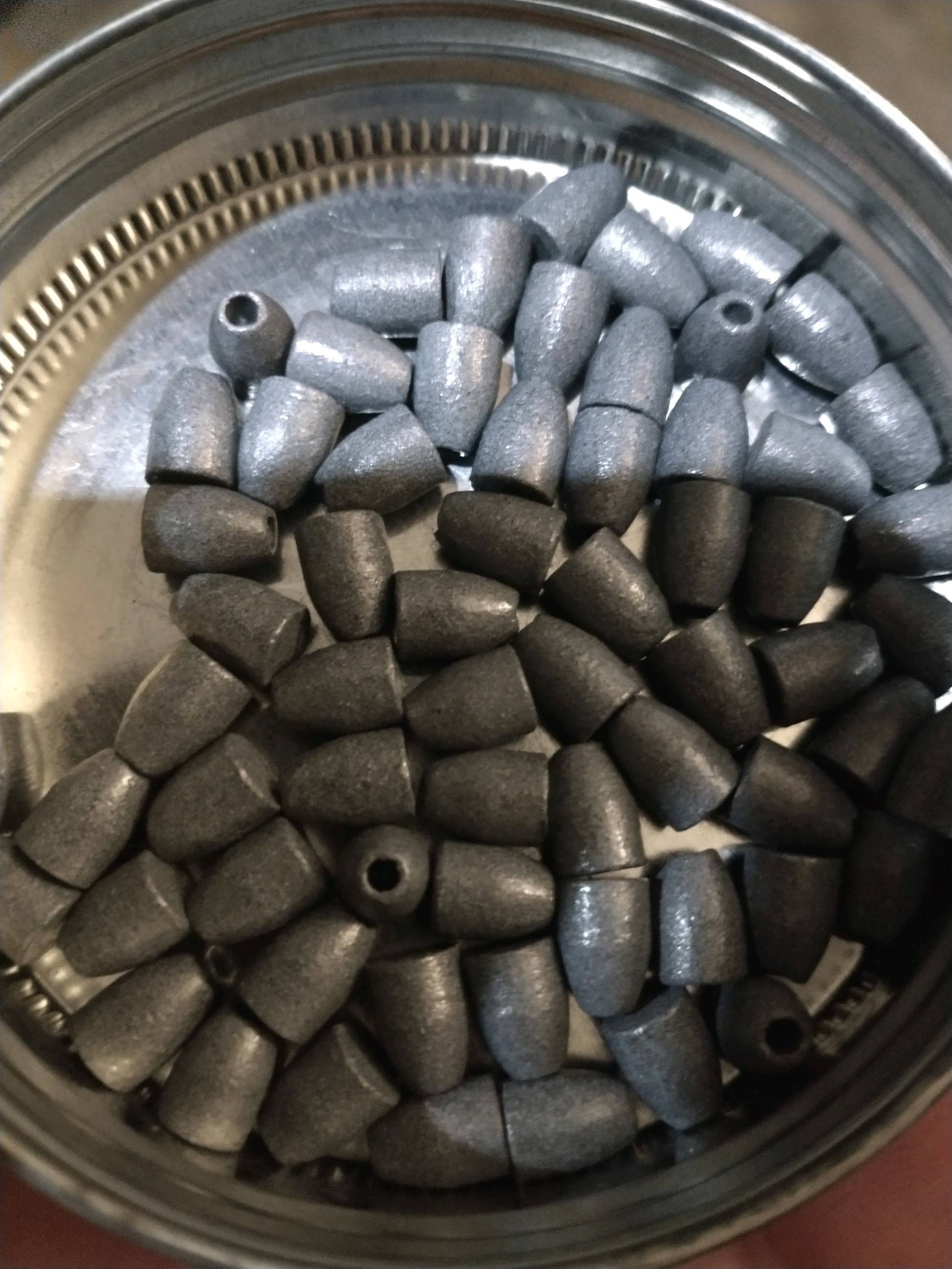

Here's the result.
Closest sized to .3565 which touched the sizing die 100%. Next .3580 which about 90% touched the die, then as-cast. I cut the mold to .360 spot on, looks like I can expect about .0015 to .002 of shrink in this caliber.

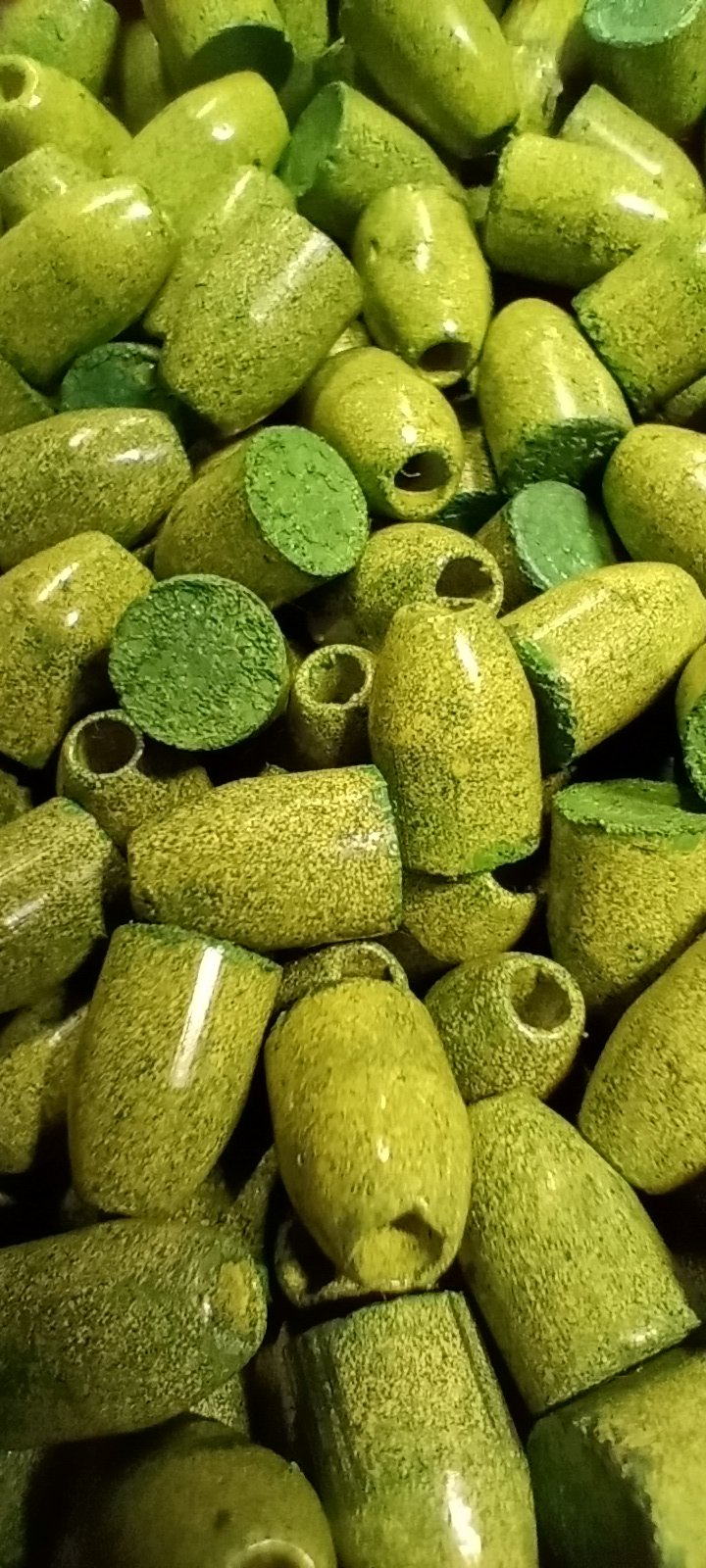

For powder coating... acetone method or shake n bake? I've tried the latter, seems the thickness is really inconsistent. Also, do you lube after coating? I shot 50ish rounds this morning and noticed some streaks in the barrel.

Powder.coating is least messy ...Some of the other members use silicon ice cube trays and have excellent results. It might take you a second to find the perfect powder coat method for you. For bigger slugs I have good luck shake and bake with water quench out of oven when powder coat is done.. After slugs powder coated a touch of oil of your personal perfence for lube does fine...Some like Silicon oil....Rem oil works good in my hand lapped.barrel.. There is a big difference in different powder coating s..I have Industrial Silver from Eastwood and a industrial john deer green that flat out work.. I have more than I can ever use if you need some. So glad to have you and your experience here😀

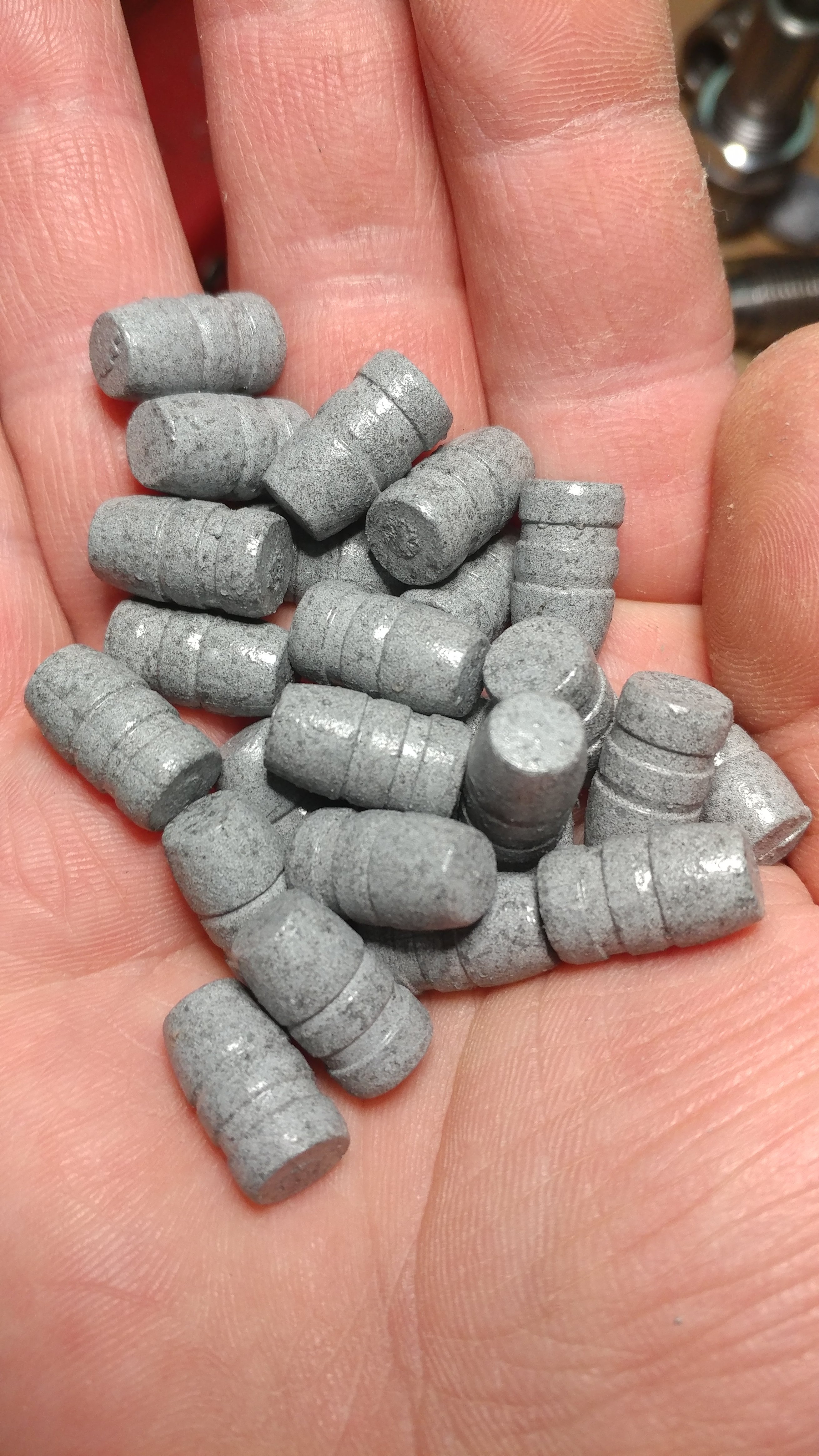

Why do you say a powder coat design? What makes it more or less suitable for coating?
No lube groove's.....they also reduce bearing surface..... Thus solid copper powder.burner slugs have grooves cut in them to reduce pressure.... Most people.powder.coating for pistols use smooth cast slugs ,reason being they cast easier..You powder coat and maximize lubrication and barrier between steel and lead....
