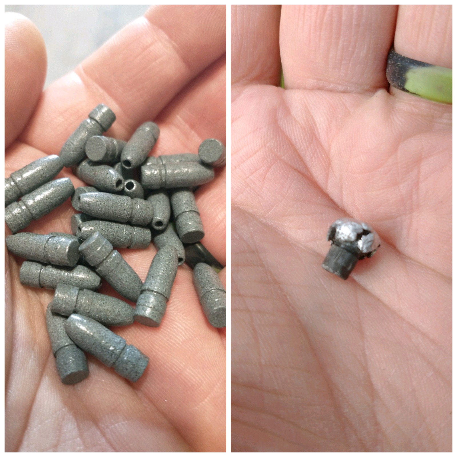

These expand like this at 950 fps, so I'll keep casting em.

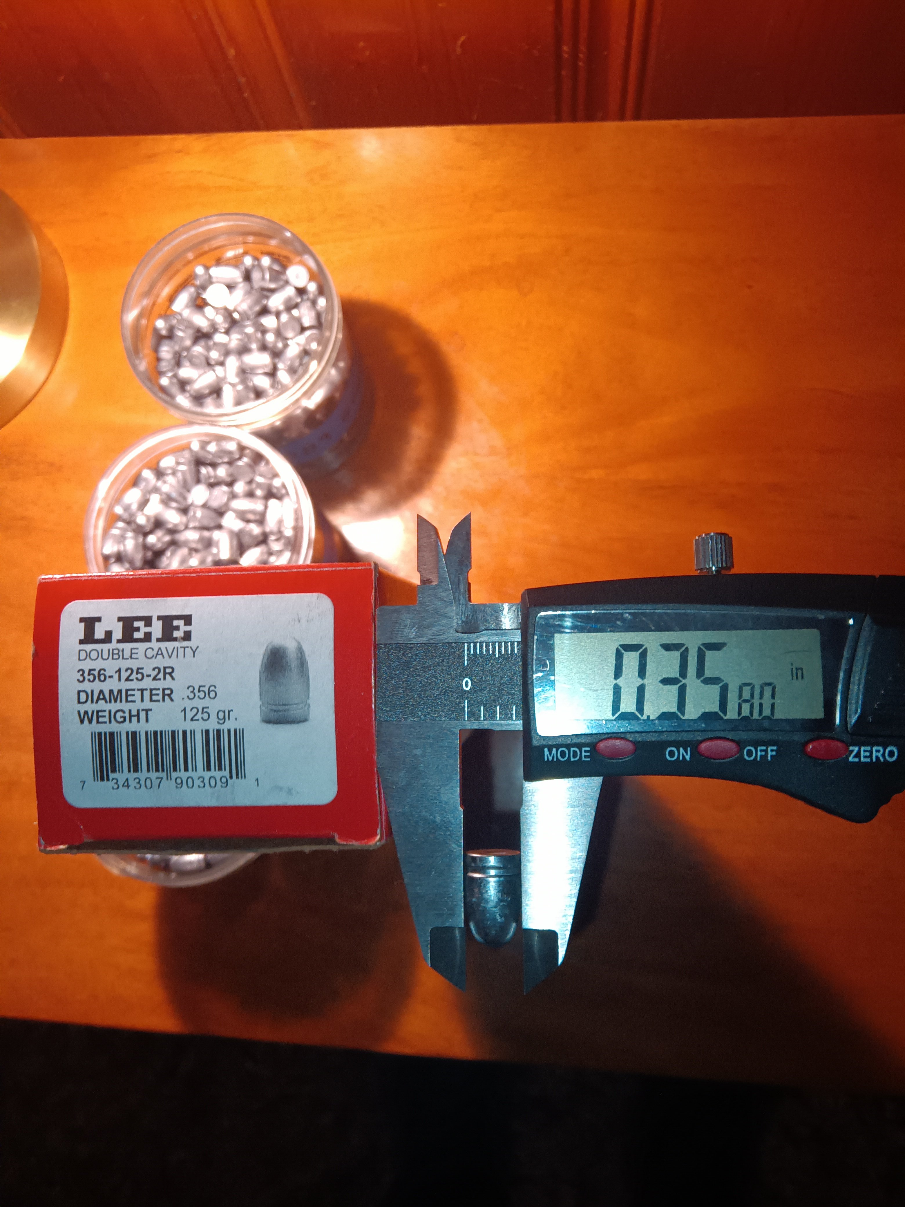

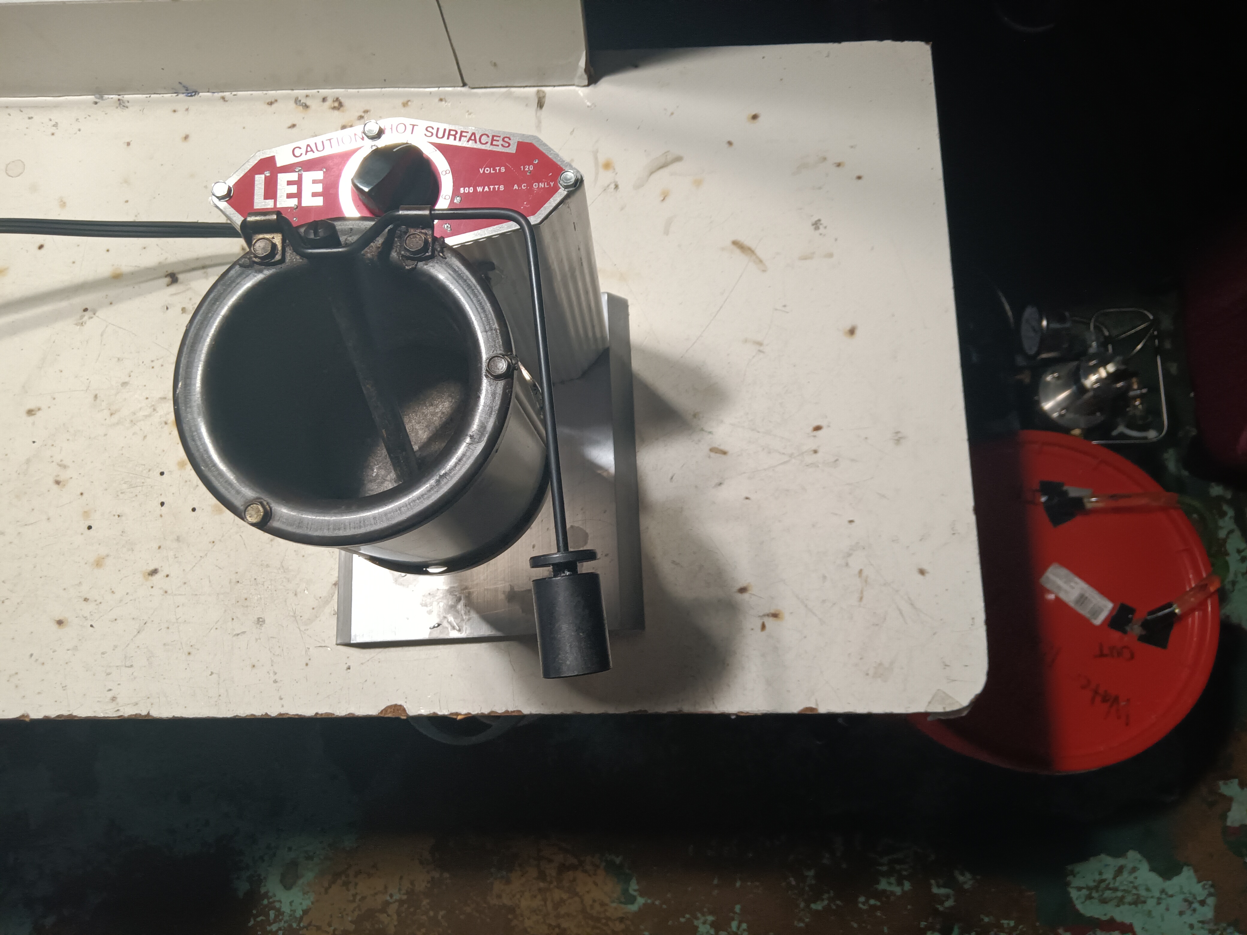

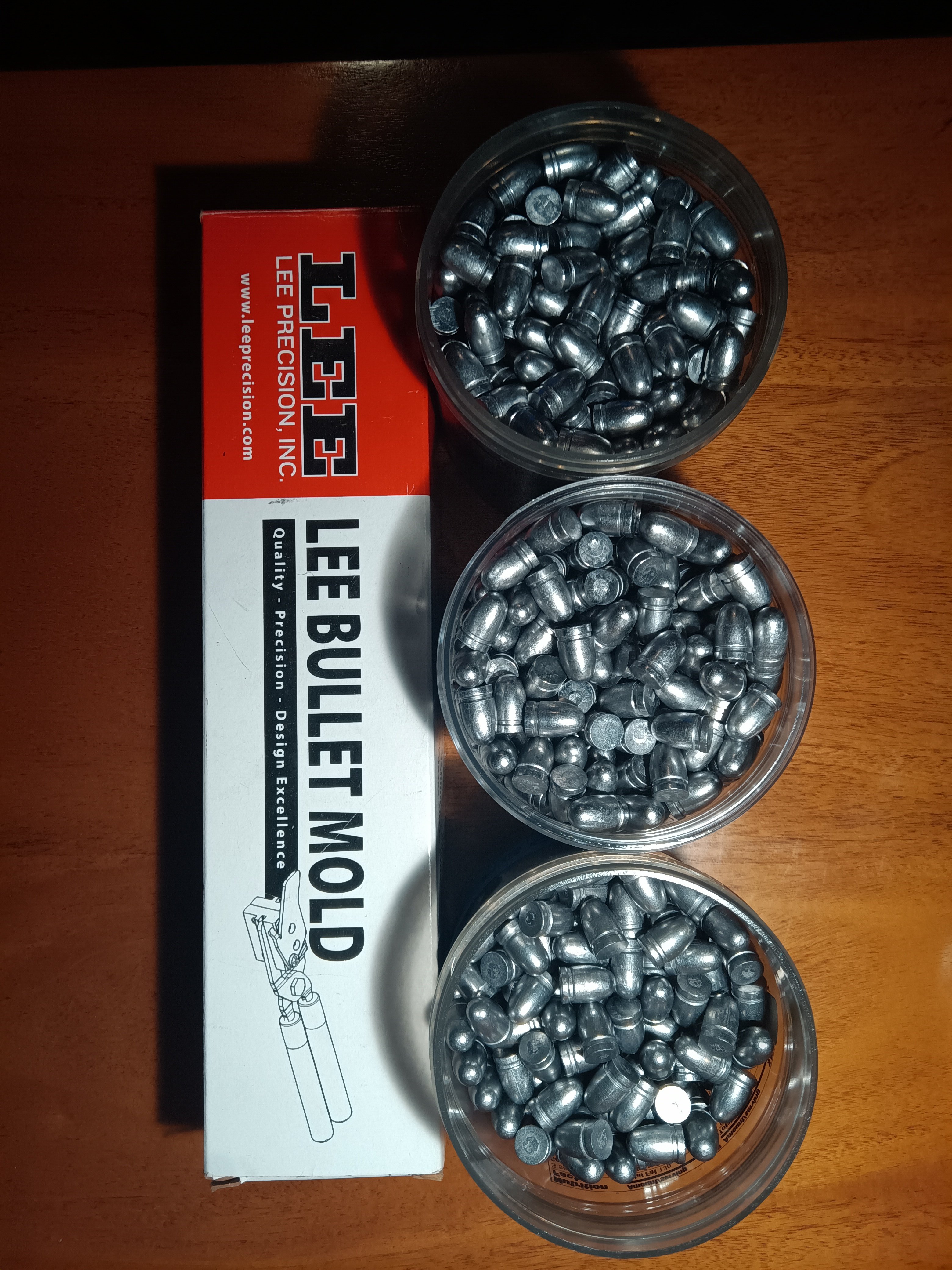

I just started casting my own slugs for my Bulldog, and I am getting decent results. Recycling lead from my ductseal pellet trap makes it possible to never run out of ammo now. I am not even sizing because they drop at .358 using a .356/9mm Lee 125grain mold.
Using a bottom pour Lee melting pot, and watching YouTube videos helps keep it simple.
I just cast a bunch of 250-27-RFs today with the same Lee pot.
@WarriorPoet Wait, your slugs are dripping at .358 from a .356 mold? They do that consistently? Why does that happen?
That is normal from my research. Most molds drop slugs oversized, then you size back down to your desired diameter. Plus everything depends on the lead Mixture too, pure lead vs. a mix with tin, etc. For example if I were have bought a .357/38 special mold, they would probably drop at .359 or .360 and I would have to use a sizing die for sure for my .357 Bulldog.
I am using almost pure lead and although the mold says 125 grains, they drop at 128,129,and 131 grains... Worked out for me, not having to take the extra steps in sizing, being a newbie the less work involved in figuring out if I like casting or not the better. Now I know I do, and will eventually invest in NOE molds, hand press and die sizing kits.
