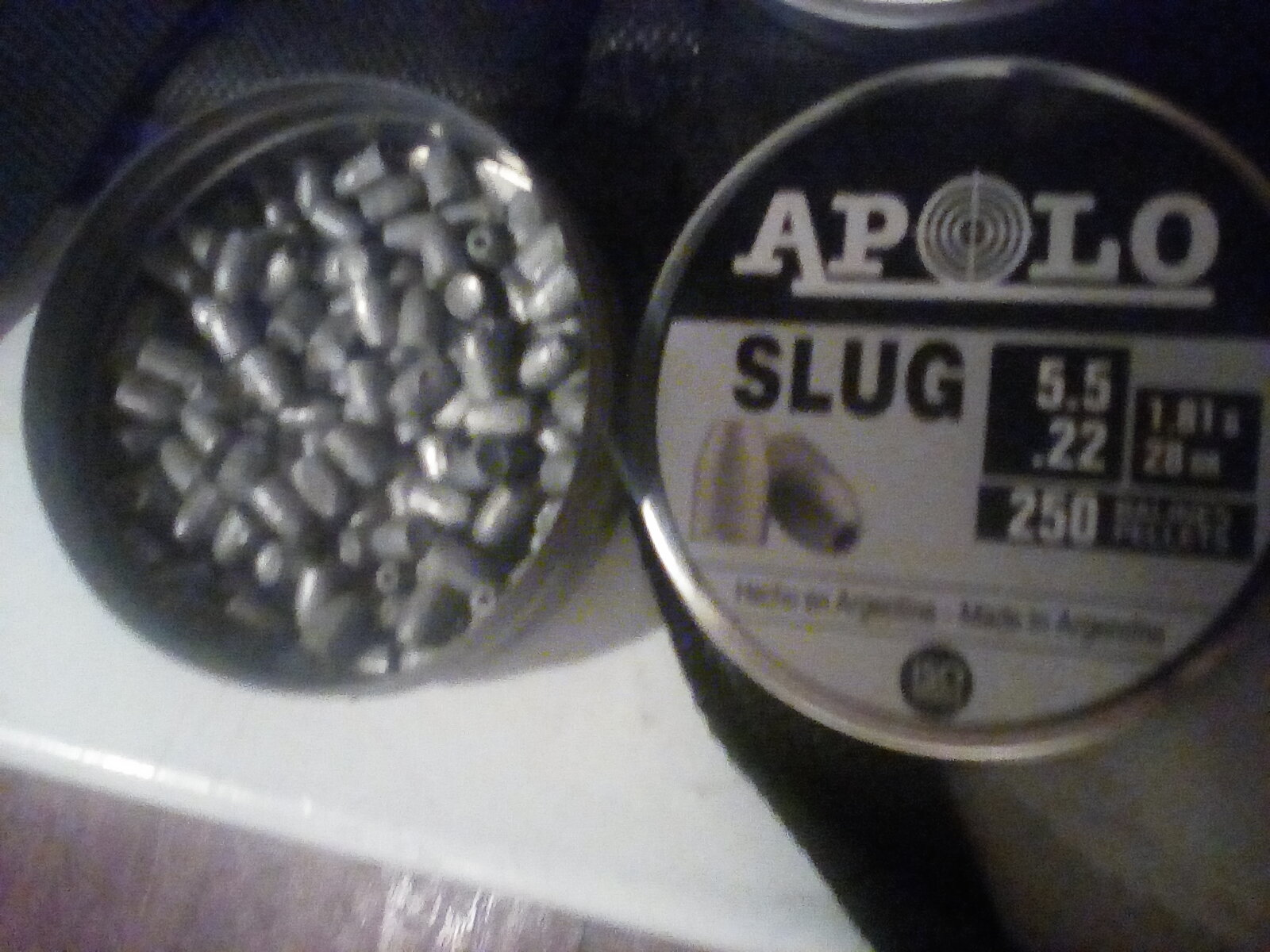

Powder coated Apology 28 grain 5.5 slugs.. I hand lapped the choke out of my factory Airforce 22 LW barrel removed the last inch and recrowned . I need bigger slugs to even slug the barrel...So I real fast shake and bake some industrial silver powder coat to them.. It worked.... It built up enough diameter for.me to slug my barrel with them😀..I.shot them at 50 yards... It wasn't terrible to my surprise.. There's better ways to do this I'm just posting my results..

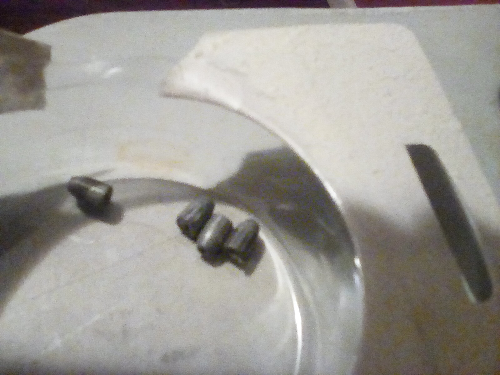

I've cast thousands of pounds on lead and tin alloys for bearings so working with this stuff is nothing new, but I'm starting with the ultra basics. Camping stove, old kitchen pot, small ladle and a 2 cavity mold (lee 90574). And a sizing die.
I'm hoping I get lucky and my barrel likes these slugs... it has been very picky so far.
This is linotype lead. About 10lbs of it has been collecting dust in my garage. Useful? Soft lead is ordered and on the way.

They look perfect!!!! You might be surprised....It might shoot well....The hardest step is starting casting.... After that it's all down hill....

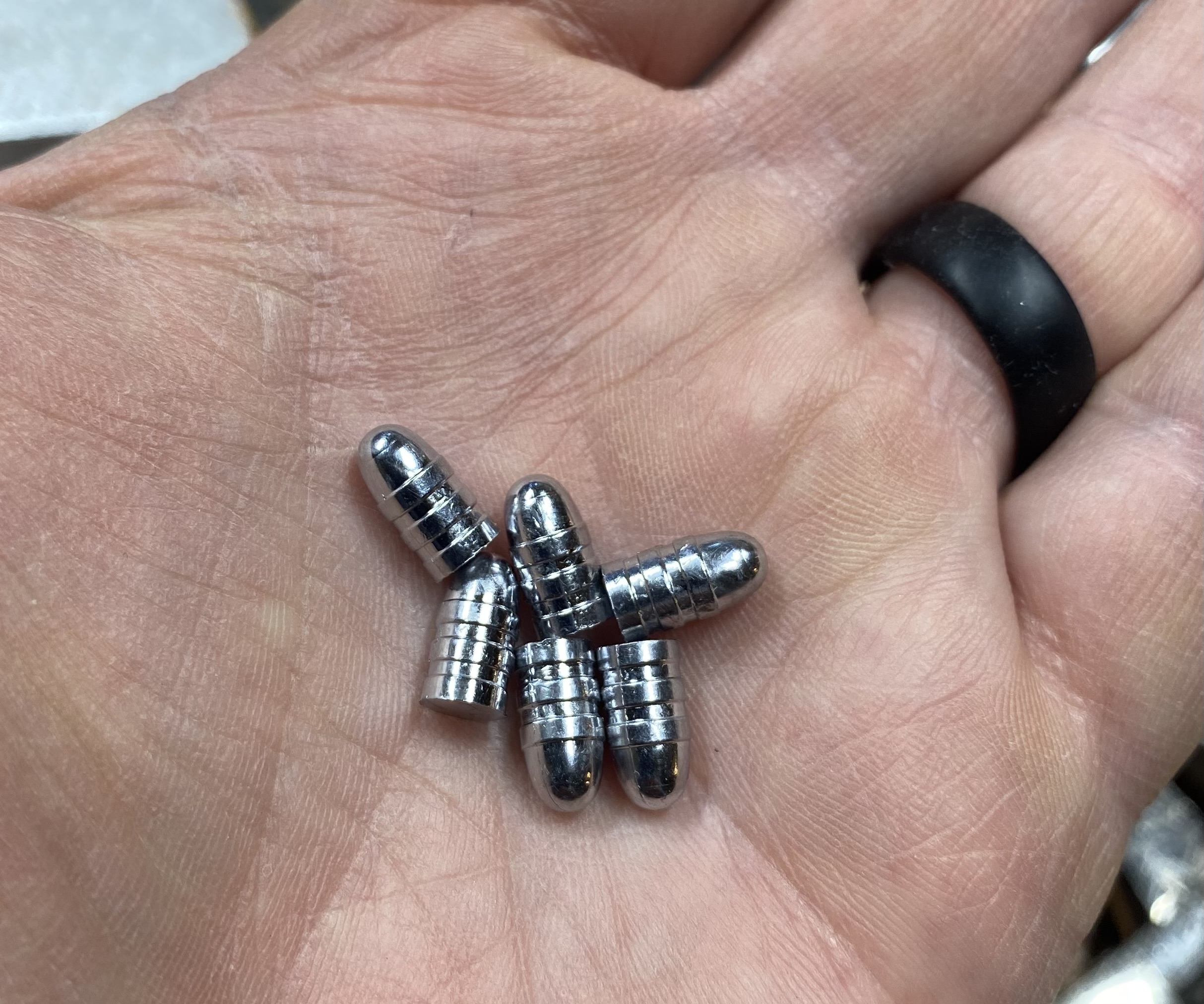

I use 20-1 pure lead-tin. The same alloy I use for my Black Powder cartridge rifles and Muzzleloaders. I cast slugs for my Veradium Air tuned 45 Ibex. Curntely using an old Lyman 300 grain flat point sized .457 and lubed with the same lube I use for my powder burners. It shoots real good at about 760fps. I havnt shot it since last fall but I think that was it.
I would think Lino or wheel wheights would be way to hard for airguns.
My lube is home made and works rellay good! I got the recipie from Lee Shaver a world class long range muzzelloader shooter. He won a few gold meadels at the matches in Hungury last September so when he speaks I listen. I met and shot with him at the Creedmore match in Oakridge TN last March.

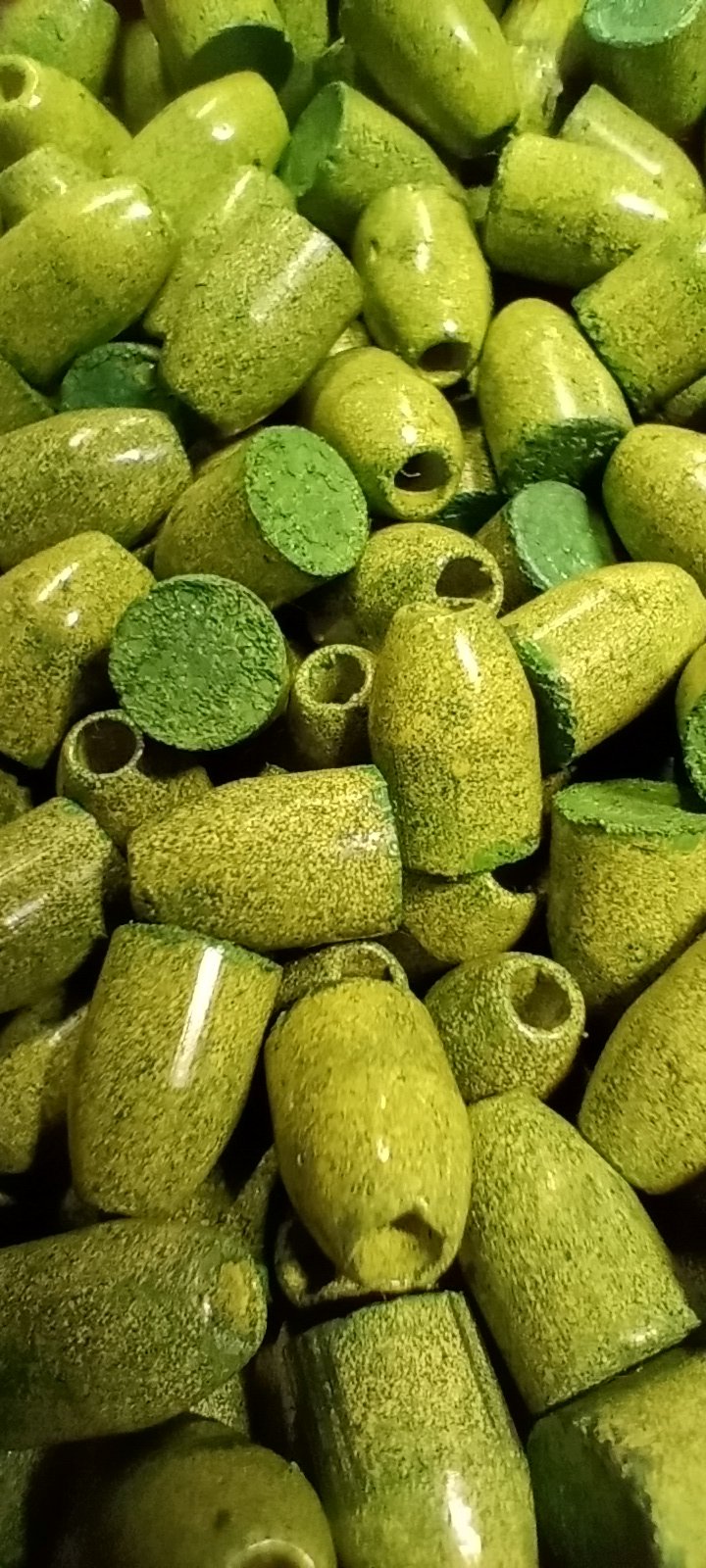

I got a bunch of old free wheel weights from our garage... They are definitely hard...Too my surprise they shoot a lil better than 100% soft lead. This is in my .510 Texan...I think its a dimension thing... I didn't think hard lead would shoot but it will when sized properly.. I guess live and learn..

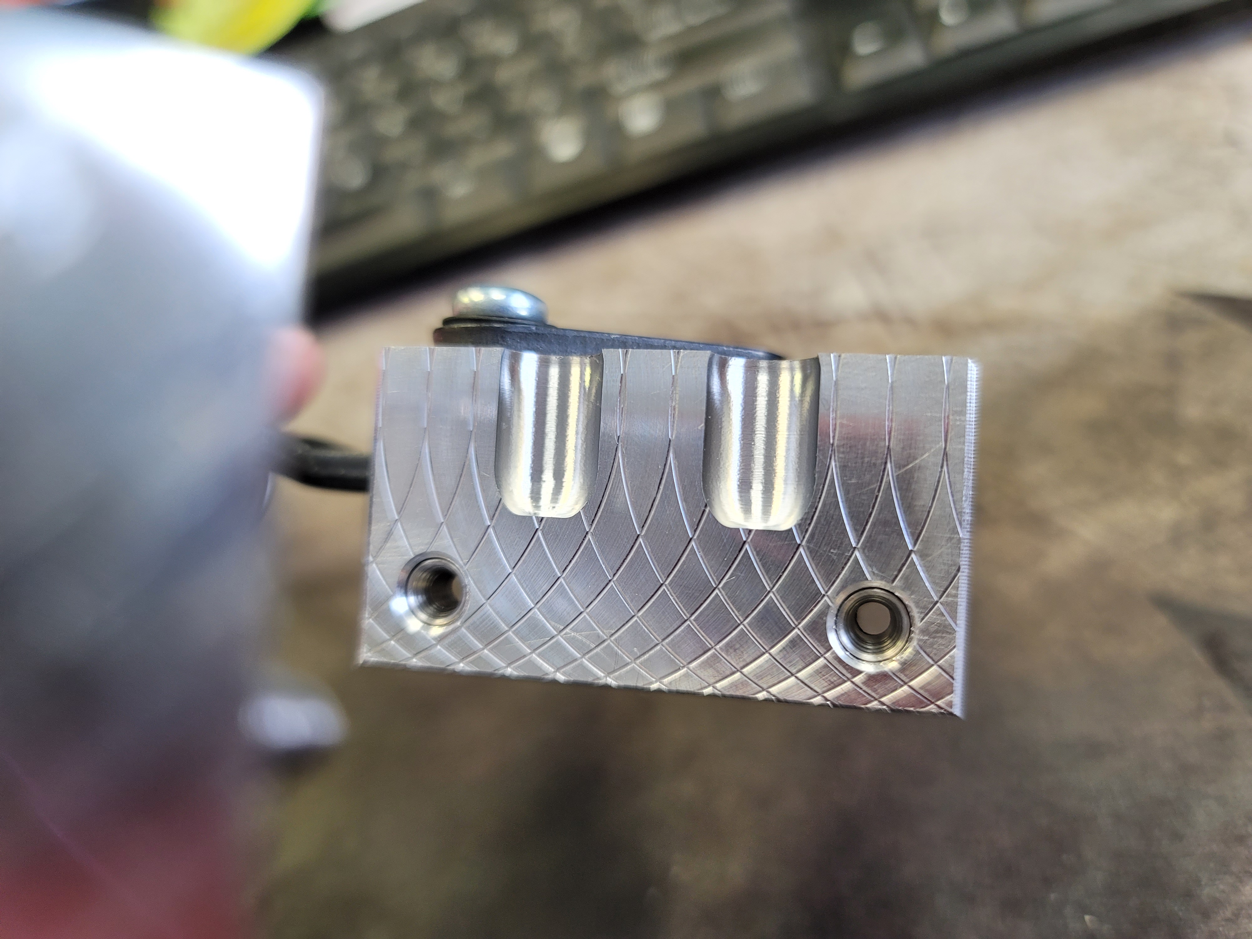

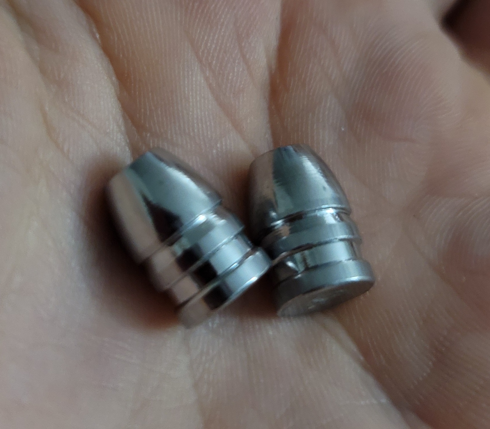

I made a mold today. Very little effort or thought went into the design of the projectile... just playing and learning. Made for some good practice programming 5 axis milling. .357 short n heavy. Probably about 145 grains.
Wow,,,so impressive... Looks like a excellent candidate for some powder coating!! Keep up the good work!!!
Reactions: caliusoptimus
wow!! nice job and good looking mold. did you buy blocksor did you do thoase as well?
