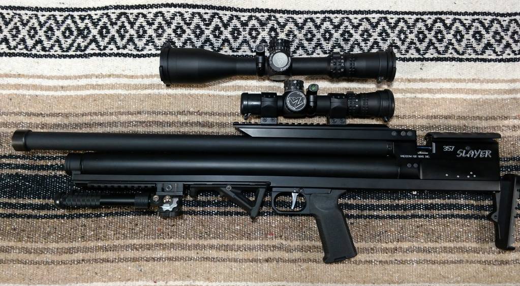

I am not really "into" them, but I did just get this LPVO to loose a lot of weight and have quicker target acquisition on low power. (I found myself "hunting" for the game with the scope at higher power levels and this takes too much time, unless your sitting around pesting birds on a roof or the like.) I spent a decent amount of change on this scope because it checked off all of the boxes I wanted in the LPVO. There is only a couple of things I would have different: an illuminated holdover reticle on low power, and possibly going to 10 power. Otherwise I can use it just like my dialer scopes and also can hold over if I choose to.
Don't get a FFP if you may have trouble seeing the reticle at low power (the holdover reticle is tiny at 1 power), and if you don't use the reticle for holding over much for measuring distance. If they were not so expense I would try one in a SFP model and just use high power for measuring or seeing.

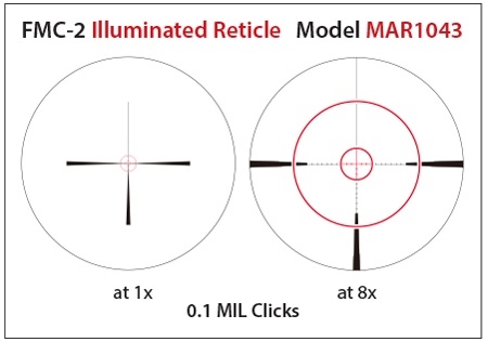

So I have a March F 1-8x FFP on my Leshiy 2 which is nothing short of amazing. It's got a nice usable reticle on 1x and 8x.

Ctshooter I think there are there are three reticle options on the F 1-8's. Which reticle do you have? And by usable at 1x do you mean that you can see the holdover points at 1x or that you can just see the reticle?
