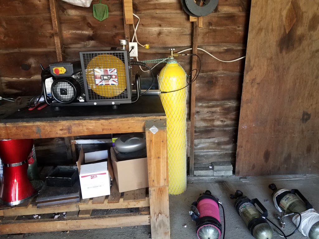

I have the large steel tank. I use it to fill my 60, 45, and 30 min tanks. I fill the large tank with a Daystate LC110.

The yellow storage tank there are steel, and what's cool about the ISO tanks is that the hydro is good for 15 years!

That just isn’t right and now after seeing this I want to add a yellow tank to my AV Compressor to help fill my 88cf-74cf and my little 90ci tank. Again how expensive is a yellow tank? I have those size tanks for my cutting torch and one for my wire welder but I have a feeling that yellow tank is a bit more.
I just never thought of putting a big tank with my AV compressor.
