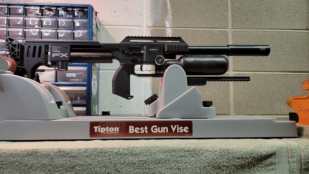

Tonight I Just "Legoed" my MKII into a .17 500mm Compact w/ the new Superior liner (have .22, .25 and .30 in all lengths as well). @ 30.75" (78cm) it looks Awesome. Since there are many available pellet and slug weights, more than I could possibility need to serve my passions, I will start with the mid-higher weights @ 13.43 and move up or down, depending on what my liner likes ( I have an extra liner in case this one is so-so).
.17 is not as forgiving as, say, .22/.25 out to 200yd, but in the proper hands, just as deadly (accurate), as many here can attest.

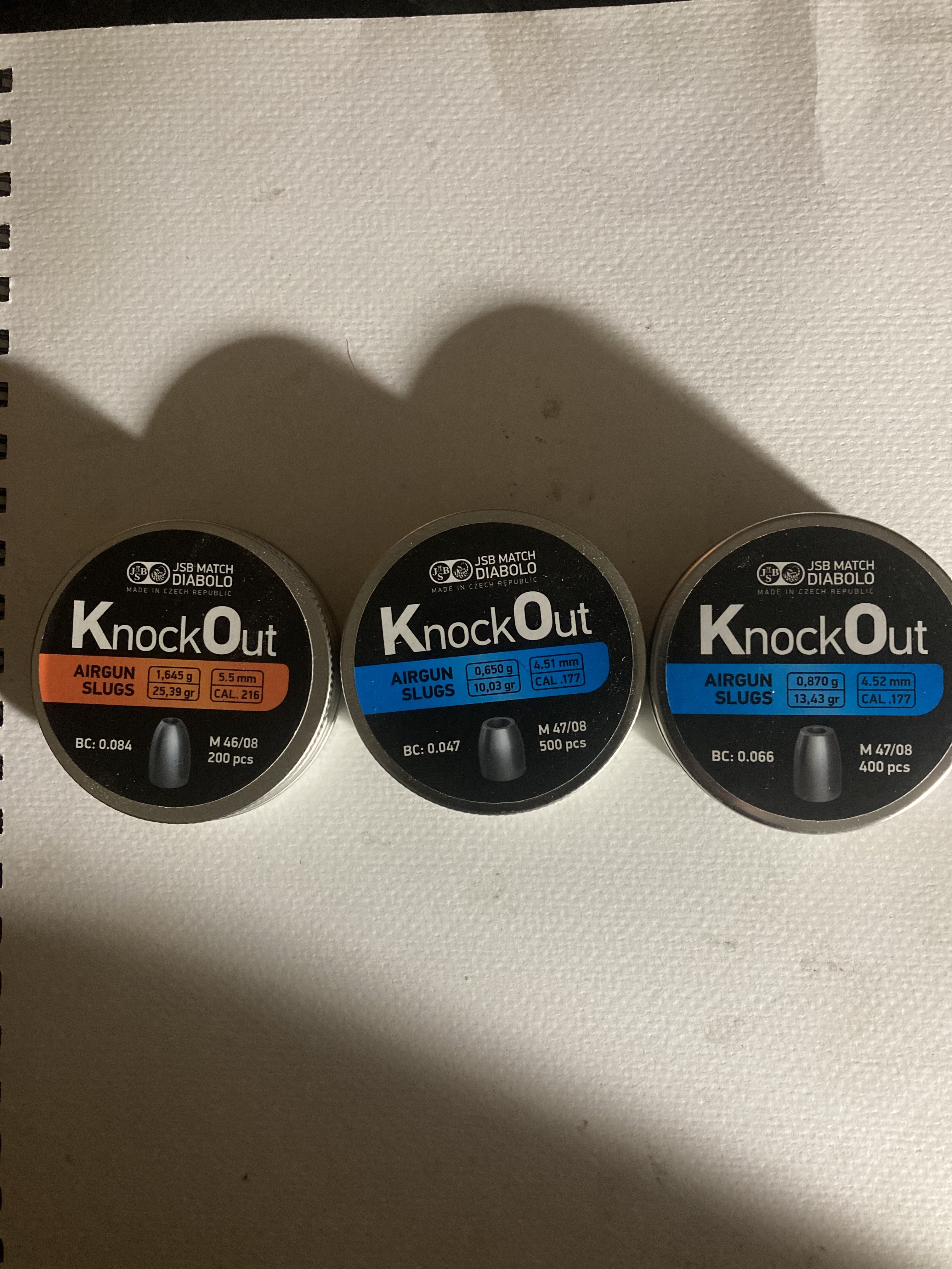

With 400 shots per tin using JSB 13.43 knockout slugs you can get supreme accuracy and lots of power and twice as many shots for the same price.
And the 10.03 grain slugs come 500 per tin!
