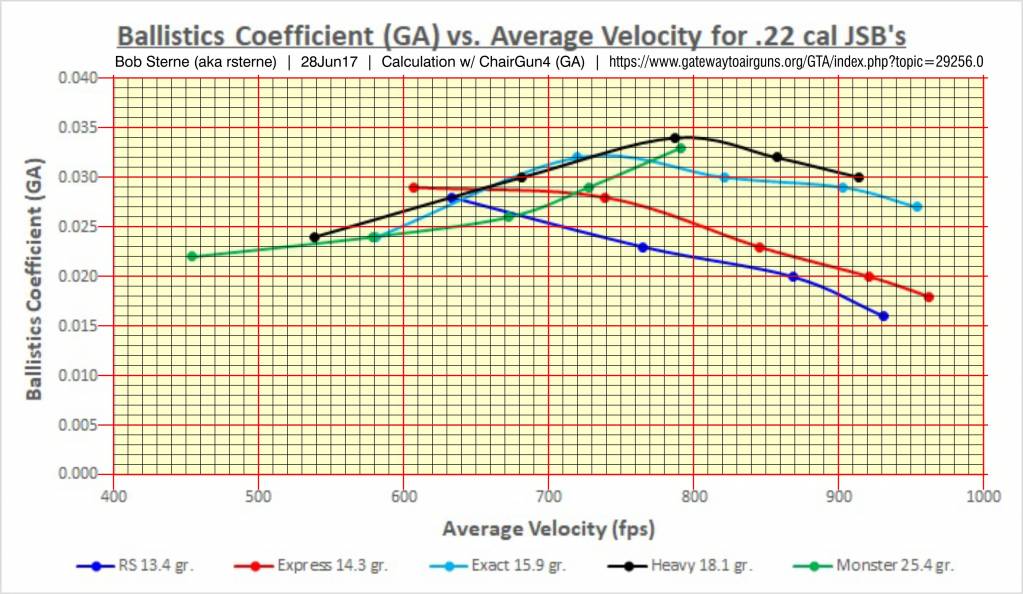

Published pellet BC is based at their peak which is usually somewhere in the 800fps range. If you are starting in the mid 900s your actual muzzle BC is pretty low in comparison. This is why shooting a pellet faster may actually increase the effect wind has your shot. Slugs on the other hand are probably at their peak closer to the 1000fps range but don't hold me to that. Here's a graph for JSB pellets BC.
Notice the green line in RSterns graph above.....
.22/25.4 Monster RDs, their BC hasn't peaked out at the 790 at which the line stops. Mr. Sterne must not have shot them faster in this comparison.
From slow twist polygonal barrels, I've found the best BC from the 25.4g Monster RDs to be north of 950fps. Compared to most wasp waisted (Diabolo) shaped pellets, the .22/25.4 Monster is a rule breaker.
