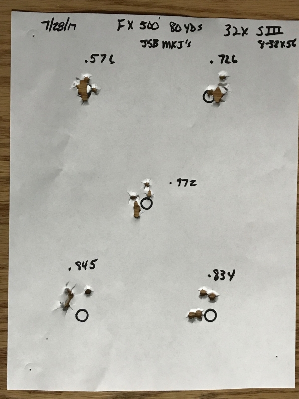

Why are 16X groups tighter than 32X ?

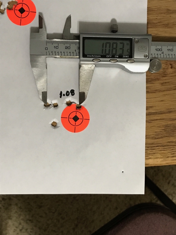

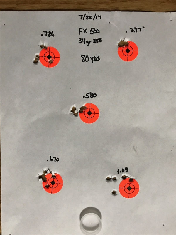

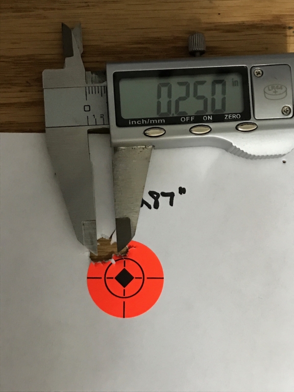

I thought I had issues with my FX500 after I bored out the end cone and the air stripper to .330" a while back. One of our fellow members had done this to his and had positive results. I shot the other morning with basically zero wind, 80yds, JSB MKI's weight sorted and sized. I was shooting at 32X through my Sightron SIII 8-32X56 and wasn't happy at all with the results. I think all five, five shot groups were over I". I had seen this before when I had the power cranked up. I was to point of getting ready to plug them both and then re-drill them to factory specs. I decided to dial the power back down to 16X a couple of evenings ago and shoot 80yds and it was shooting great again. This morning while it was calm I shot these 5 shot groups and was really pleased. I just don't understand what the difference is. My bench is rock solid and I feel good about all the shots, don't remember pulling any anyway. Anyway here are those groups from this morning.

Well, I shot again this morning while there wasn't any wind to speak of and the coolest part of the day. Set the scope to 32X and checked the parallax for focus first and then alignment doing my best Owl imitation. Really couldn't detect and noticeable misadjustment so I shot three warm up shots to make sure the velocity and regulator was all good. One of the things I like about my 500 is that it's spot on from shot one. My other two PCP's need a few shots to get to cruising speed. Anyway my groups averaged right with the groups from earlier that I shot at 16X. The 16X slightly better due to the .287 group. I used a target aim point of circle that was .250-.270" and kept the reticle dot within the circle for the shot cycle. Could of used a smaller circle with the fine dot of the Sightron scope even at 80yds (I love that small dot). I could definitely see my movements while trying to stay on/in the center. Might try 24X for a happy medium next time..
