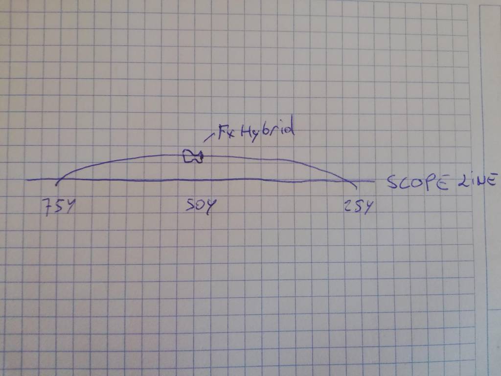

Its a simple matter of velocity and/or scope height, and zero distance.
If your zero distance is 25yds, and your scope height is 3", youll have a second zero around 50 yds if shooting around 930fps.
Now, if you reduce your zeeo distance or increase your scope height or velocity, your second zero will be further away..
When I tried hybrid skugs at 1,000fps, my second zero went from 50yds to 65yds.

Not faulting the poster of the video, but the visuals in this are absolutely awful. They perpetuate the 1960 Outdoor Life depictions of rifle trajectory. A bullet never “rises” above the line-of-bore (LOB)..ever.
LOB constitutes the launch angle of the projectile. Under normal shooting conditions, a projectile begins dropping immediately upon leaving the barrel.
The line-of-sight (LOS) is normally above the LOB. LOS must be set at a downward angle relative to LOB so that the LOS intersectS the projectile trajectory at some point..or points. How you set the LOS determines whether you have one or two intersections.
With the Field Target method described by Tom, you are locating the single point LOS intersects the trajectory. Not sure what this single point is called in rifle shooting, but in archery it is referred to as your “High Pin” (HP) distance. HP can be calculated from sight geometry..peep height above arrow and peep or eye distance to your front pin At full draw..and the velocity/trajectory of the arrow. There’s no reason the single zero distance could not be calculated for an airgun.
When you have a near zero and a far zero..two points of LOS on the trajectory, the near zero distance always has a far zero distance that intersects the LOS. The mid-points between the near/far zeros are always above..impact higher..than point of aim. The advantage to a near/far zero for hunting is that you can pick a near zero that optimizes the mid-points that are within a “hit-window”..plus or minus an amount..say 0.5”..from your LOS. Chairgun has a tool that helps you pick the optimal near zero base on a target size you specify.
