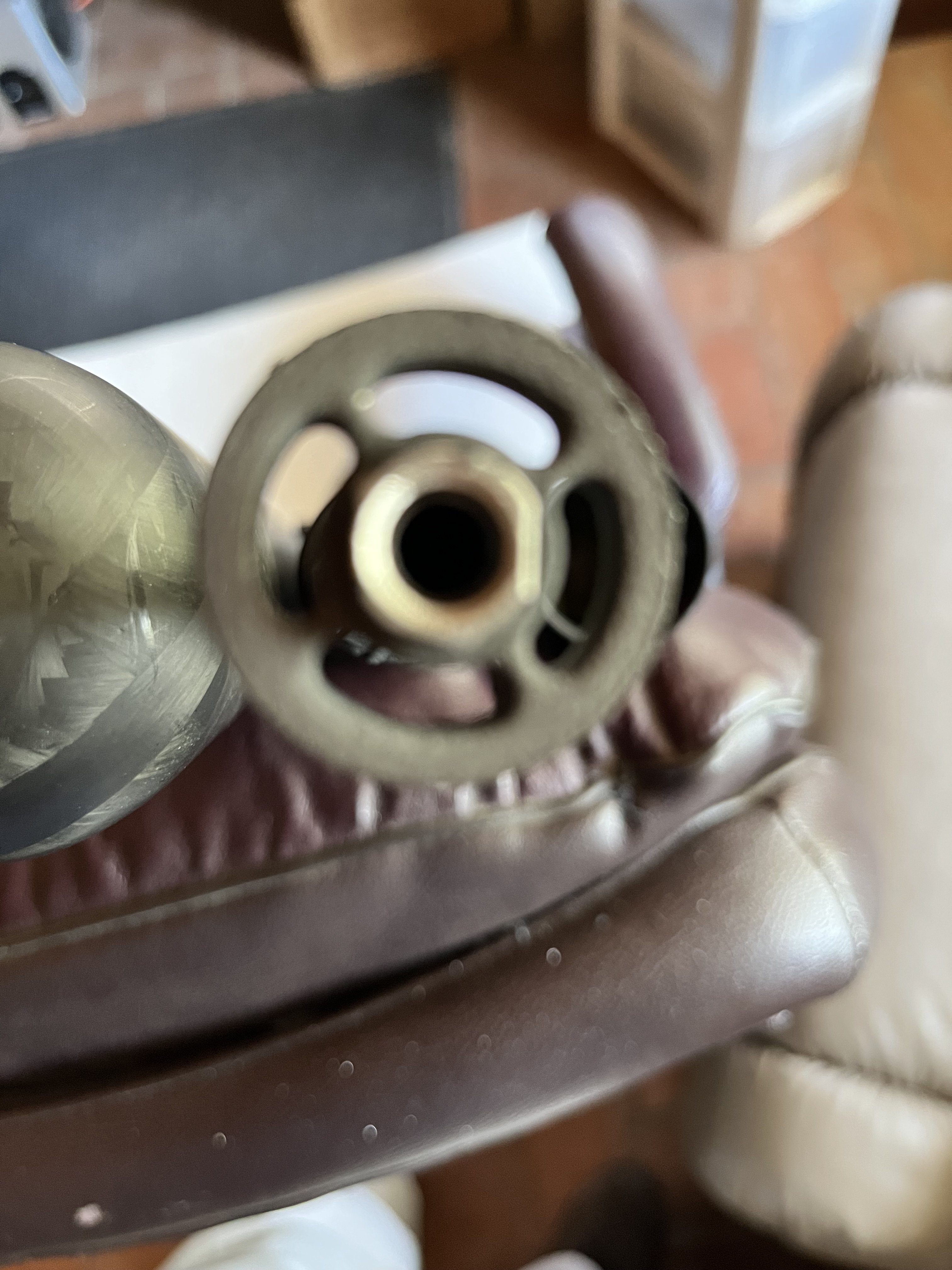

You and me both. Got burned by a Crown MkI. Should have figured it out when I sent the first one back.After a lot of time reading posts of people complaining about FX Meccano shooting line rifles, I decided to buy a Panthera Compact Hunter in .25.
If you see the rifle the shape is amazing. Two bottles, a big in the front and a 300 cc in the rear.
No one rifle I have own has made to shoot so many pellets in order to get to think it is set. I do not play with tunning. I have changed scopes, ammo.
At 50 yards it is accurate. At 88 is far away in accuracy from my Daystates, Airgun Technology and Sidewinders.
And it has a slow leak...... I need to refill it daily....
I had to order a PRS butt pad from UK because poor design of original one.
The rifle shoots, yes..... But nothing that worth the price I paid for the rifle and do not compensate the amount of pellets and time invested in trying to make it work properly.
I would never, absolutely never, buy again an FX.
And I will sell the Panthera ASAP.
1st run, or as I call it, Version 1.Uh 0.As said before, never buy a 1st run of anything. Wait til the bugs are ironed out & then wait some more. The "I wants" are often the reason for the "wish I would have waiteds"
It could well be the speed of your projectile... or the projectile itself.Conceptually the Panthera with the two bottles is a super rifle.
After the recrown, I made wider the exit hole of the piece that is made to hold the moderator.
I need to have a clear diagnosis of what is happening to this rifle, irrespective of the slow leak.
Tomorrow I will invest more pellets to try to understand. Sometimes the wind avoids a clear idea of the real behavior.
At 50 yards the rifle is super accurate but the grouping at 88 do not correspond to the kind of groups at 50.
I will try to understand more....

I was shooting JSB 34 grain ...... And just discovered how well this Panthers shoots the H&N Baracudas 30.86 grain.It could well be the speed of your projectile... or the projectile itself.
I didn't notice any details of what you are using and at what speed.. was that researched as yet?
Yes, it costs us all a lot in pellet or slug vs barrel testing. That's why a lot of us read the forums to find out what we might try in our new rigs.
I'm old and get confused easy these days. I was wrong.Would you like to be more obtuse?
Edit: I've rethought my reply. What I should have asked is if you can expand on your comment. My bad.
"Maybe" that was the Bobcat I purchased disassembled 3 years ago. put it back together and been shooting beautifully since!I have many air rifles. So if I loose the money of this rifle is just an expesive lesson.
I already sent to the waste basket many years ago a FX Bobcat .30 Cal.
I should change the barrel for a 600 mm one. Clearly FX strategy of making you spend money in order to make THEIR products work properly.....
