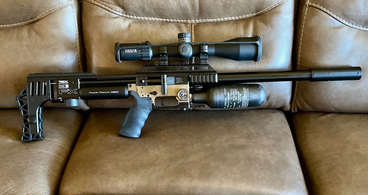

Why aren't there more M3's in HFT?
I shot a maverick for a year first time i shot my red wolf i beat my highest score. Got a ghost and stopped shooting the red wolf. Have a friend shot a m3 for a year got a crown beet his best score with the m3 first match out. My thoughts are that in the larger calibers the m3 and maverick have too many parts bolted together and move with temp change and it doesn’t affect the larger calibers as much as 177

In case you aren’t aware most people talk crap about FX in 177 caliber/barrel. FX guns all use the same barrel and I've shot HFT with my crown with short little 380mm barrel. Impact is just another form factor but you can have your own opinion cause you shot FX impact in HFT and it was horrible right?

I assume you've never shot FT. The M3 is a rifle with potential for very high power. Throttling it down to shoot .177 below 20 fpe is a waste. Besides. from all my experimentation, most FX rifles in .177 aren't terribly accurate. The older Royals would be a much better choice. Many might disagree on that. There are so many rifles out there that have been developed and used for years in FT, such as Air Arms HFT 500, S-500, RAWs, Daystates, Thomases and others that have a DEMONSTRATED history of success, why consider an M3?

Yes, using an impact is a bit overkill but it’s the only gun OP has to try the game so it’s not a waste if you ask me.

I started shooting FT last year after I ordered a 600mm .177 barrel for my M3. Once tuned to shoot the JSB 10.34 pellets, it was accurate and consistent. My scores improved as I practiced standing and kneeling shots well as my hold over skills. My only ‘complaint’ with the M3 is the trigger pull is a bit heavy but I learned to work with it.
My reason for not using my M3 in FT anymore is it’s a great varmint gun and I leave it set up with a larger caliber. I have four other guns that I use for FT. But I have no doubt if I converted it back to .177, I could do just as well with it as I do with my other guns.

I knew my original question would be stirring up a s*** show. From the research that I've been able to do, with a few helpful comments from you guys, it appears that the M3's flaw is in the cold shot. I'm not going to get into it here but there is a 40 page thread on the flaw and how to fix it. It's not reg creep. It's not a shifting poi (per se). It's not accuracy. There was a design flaw or overlooked result of engineering. The M3 is reliable in those. I think the consensus is that the shooter also has to have an in depth feel and knowledge for their rifle.

I'm not saying that the M3 is perfect, I'm not saying it should be used more in FT. What I was trying to get at is; that's what I have now and was wondering why they are not used more, which I think I got the answer to. I've seen the results from Palmyra's matches and it appears that there's a few who use them with what looks like winning results, so that's where my question was born from.

I know the .30 is not used. In my original post I started, I bought a . 177 kit and was wondering and worrying I would regret it. BTW I just got it today, put the CF sleeve on it. Tomorrow I will take the entire valve assembly apart and make the "fix" and put in the new barrel. Maybe it will work maybe not?

Simply put, and as was commented by many here trying to help answer your question, an FX Impact is not the best tool for the job ("job" being sub20fpe for AAFTA FT). Again, that's not a bash. If an Impact WAS the best tool for AAFTA field target, there would be many more in use.
Since you've got the .177 barrel, go to a local match and have fun with the Impact. Very few field target shooters are running the same gun they started with, so switching to something better suited or that offers a perceived advantage in some way is pretty much par for the course in field target. But your .177 barrel kit is a great starting point to see if you like field target.
