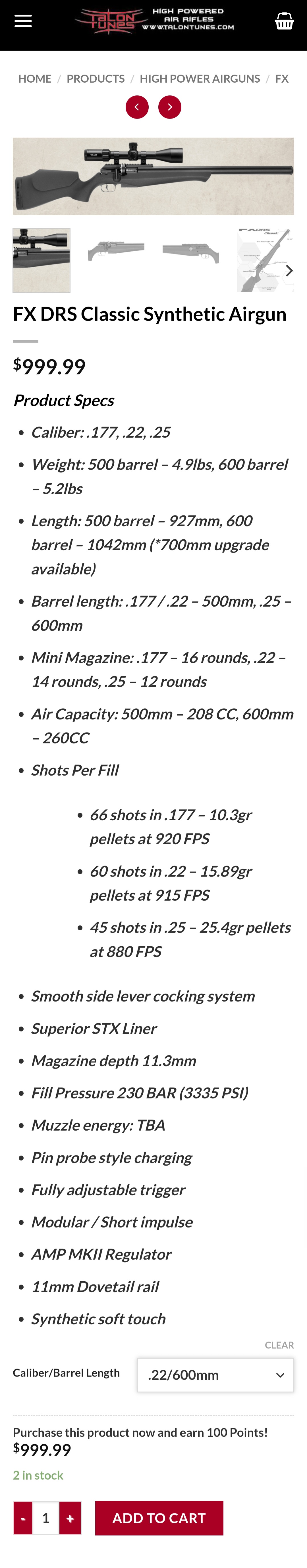

For a a little more money check out the FX DRS Classic

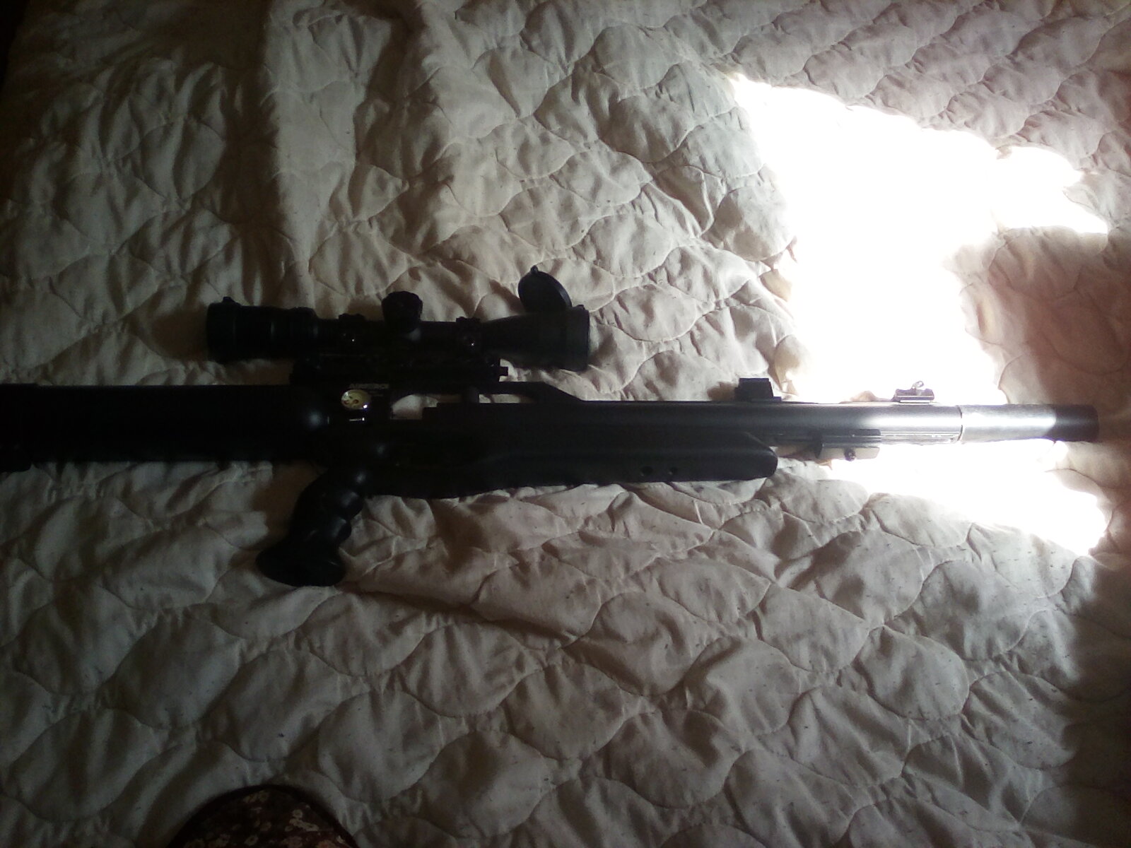

I have a Airforce condor .257 running stock barrel with .257 slugs heavily power tuned and I have a pbba .457 and a XP badger .40cal I was thinking about getting a Airforce Texan but I hear the stripping out is a big problem so I'm not gonna get one they make insane power though and are accurate guns and really reliable and easy to work same for the badger and pbba

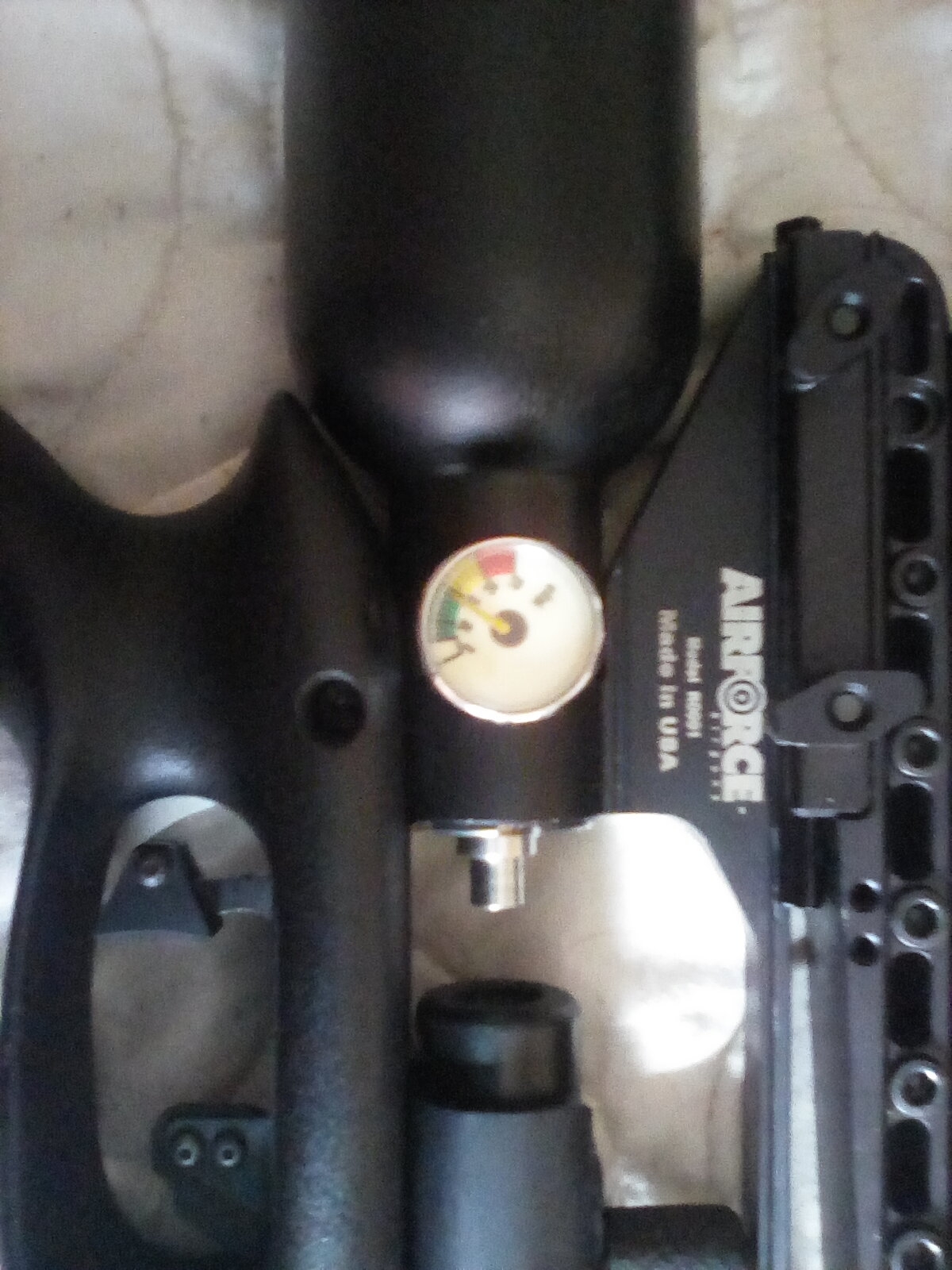

My second PCP was an AirForce Condor SS in .22, that I converted to .25 (can you do that easily with the JTS - I really don't know the answer)? It's a great gun (I still have it, and shoot it, in spite of a solid half-dozen "fancier" PCPs that I've acquired since then. It's very amenable to upgrades - and mostly inexpensive upgrades at that. I learned my first tweaks and tunes on that rifle and I think it was almost perfect for doing so. I remedied the aforementioned hold sensitivities with a Mad Dog stock, improved the report with a Talon Tunes hammer and tuned the velocity originally with a Talon Tunes 'top hat' and then went to full custom inserts. I'm sure I'm leaving out some of the things I did. I learned a lot on that relatively basic platform. I'd hate to think of buying a Leshiy 2 and trying to learn tuning with no previous experience...
