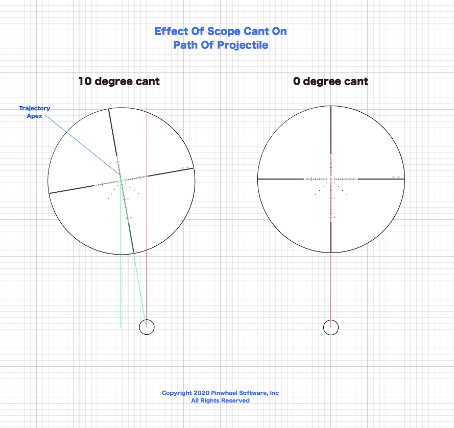

Here's what I'm thinking. Are we saying the same thing?
Green line is the projectile path in canted system. The red line is true vertical. LOB aligns with vertical cross-hair of scope. The projectile follows the LOB which is the same as the vertical cross-hair until it reaches trajectory apex. In most sight in cases, this will be 1-2 Mil(MOA) above scope cross-hair's dead-center. After apex, the projectile falls with gravity and is not in line with the scope reticle. The green "triangle" should probably be more "parabolic", but for illustration purposes does this make sense?
Kind of, except when you cant the gun, the cross hairs aren't moving away from the POA. The little circle where the lines originate should be two circles about 1.5 to 2 inches apart. The green line and the red line aren't coming from the same place. If you scooted the left hand picture over so that the cross hairs are on the red line, but leave the green line alone, that would be more accurate if I'm looking at this correctly.
The small circle is the bore. LOB alignes withg the scope reticle.
The red line just represents true vertical and the direction of gravity.
In either picture, the target would be behind the cross-hair or Mil hold-off.
The green line in the left image represents the projectile path when the airgun is canted. it follows LOB, which is aligned to the scope reticle until it reached the apex of the trajectory, then falls with gravity.
There is no green line in the right image, because the system is aligned to true vertical, so true vertical is the projectile path.
