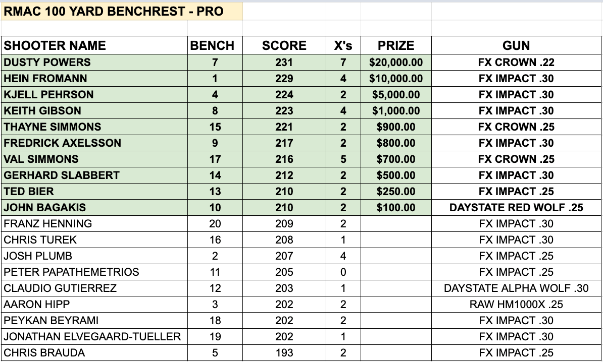

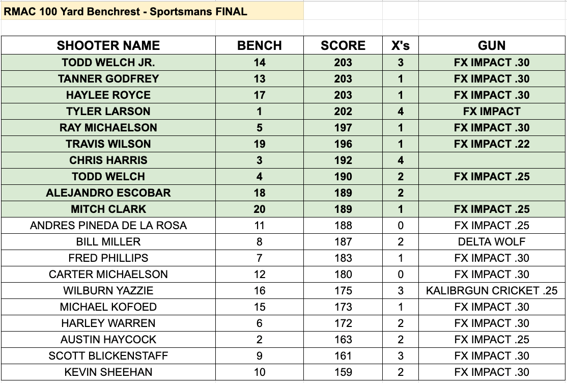

It’s more than just marketing… https://rockymountainairgunchallenge.com/rmac-2022/
