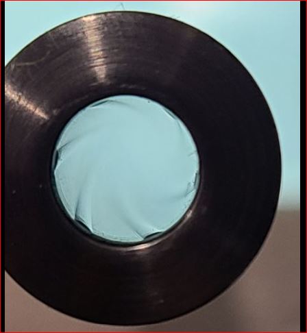

A while back I ordered some barrels from Russia (for my Leshiy2) and arrived with a very last train (boat actually).
This is how the rifling looks like:
Do you recognize some similarities? And this land-grove shape is not simple to make. The barrels were shooting well, but I made some "improvements" ;)
Polished that lead-in, also fire lapped.

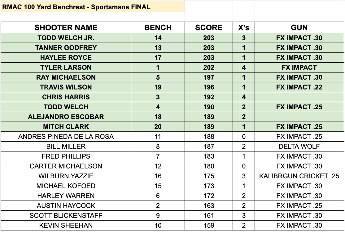

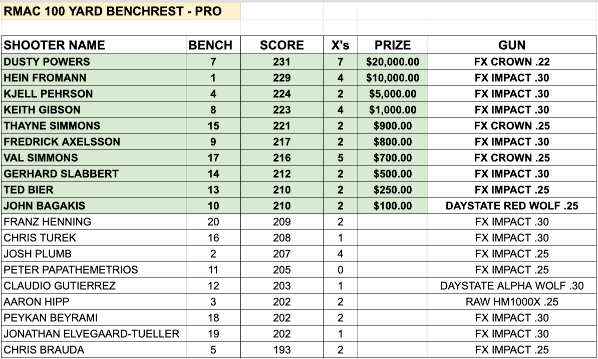

An event heavily sponsored by FX has a majority of FX shooters … no way.. EBR has Daystate which most FX sponsored shooter boycots and we see more Daystate … umm..
It’s more of an east coast vs west coast thing.
Kidding aside I think the RMAC event condition suits FX guns better. Crazy unpredictable wind with wildly wide adjustments range is hard to adjust on a more traditional bench rest setup. If wind isn’t wild a Thomas bench rest setup is the setup to beat. That being said what’s price and availability of a Thomas bench rest setup? Would it cost 300 dollars to change the barrel on a Thomas?🤣
Land and groove pattern looks exactly like some old stock Korean barrels I bought from the guy in New York two or three years ago. He used to import them back in the late 90s? Career barrels I believe they were.
The shape of the lands looks pretty similar to a TJ barrel I bought a couple months ago, although fewer in the TJ than in your photo.
I'm guessing that's not the answer you were looking for.

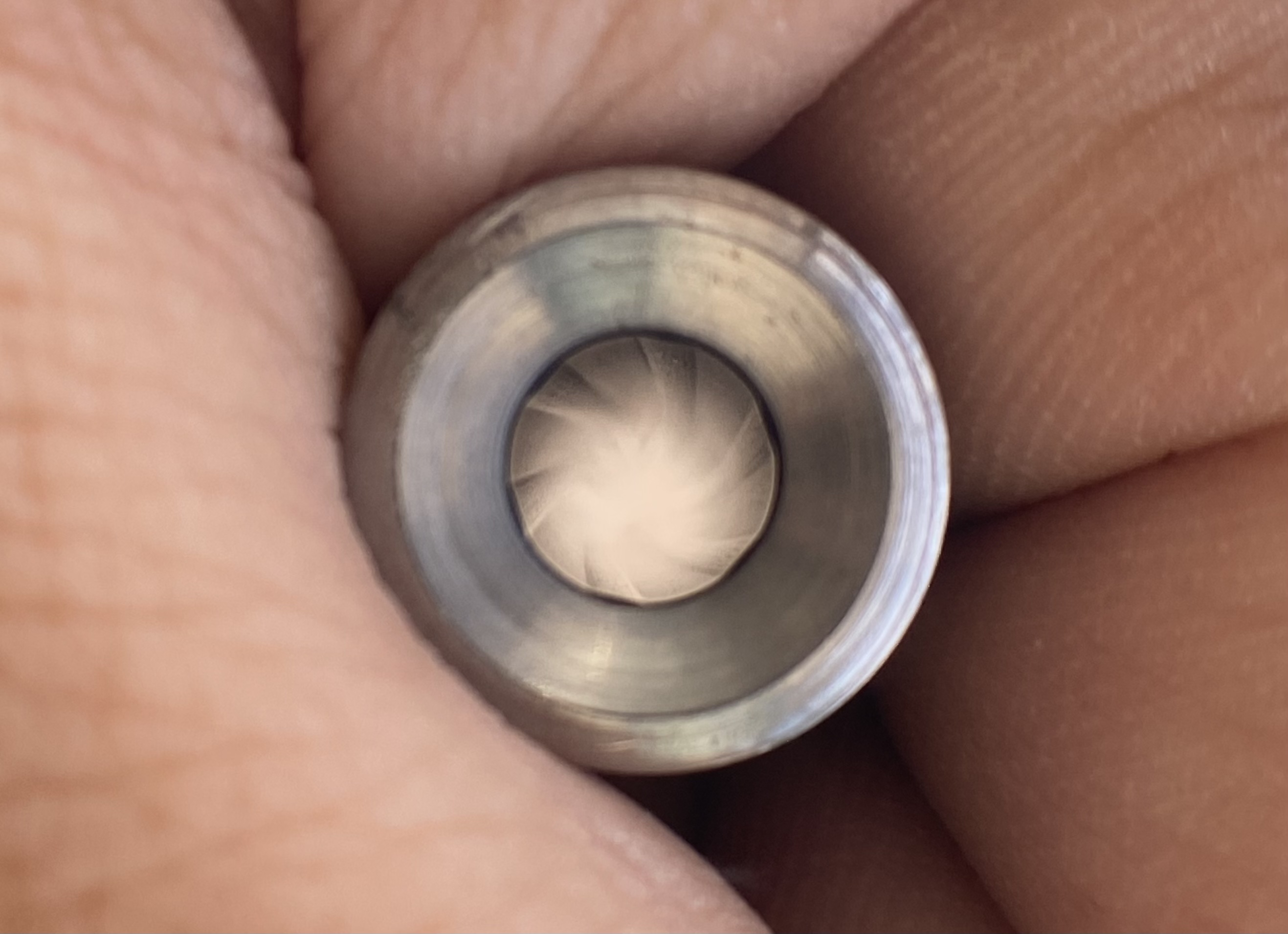

Shot my custom TJ pellet barrel side by side with my FX barrel, thanks to the marketing I can’t tell the difference with pellets. It was fairly pellet fussy too and didn’t really like crosman CPHP so I sold it.
Even when I really don't like those sponsored YouTubers, or the brand smokes marketing... there is really nothing to more discuss with the point you brought up .. in competition like that ..there is simply no substitute to adjustability and no other gun manufacturer has that..up to this day.. so there is no mystery in why there is so many FX in competition shooters want every advantage they could get their hands on to win... and as why other airgun manufacturer doesn't do the same with the twist rates .. they simply don't see the profit on that..because the process of making barrels like the one used by RTI will be simply way more expensive..although I was really expecting a variety of twist rates from rti . Not those one does it all barrel..
