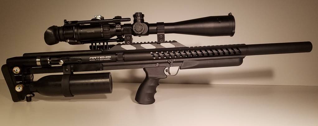

This gun is regulated yet it shoots 2-3 inch groups at 35 yards with all JSB pellets but the 15.89gr, which it does a quarter. It's not clipping the LDC.

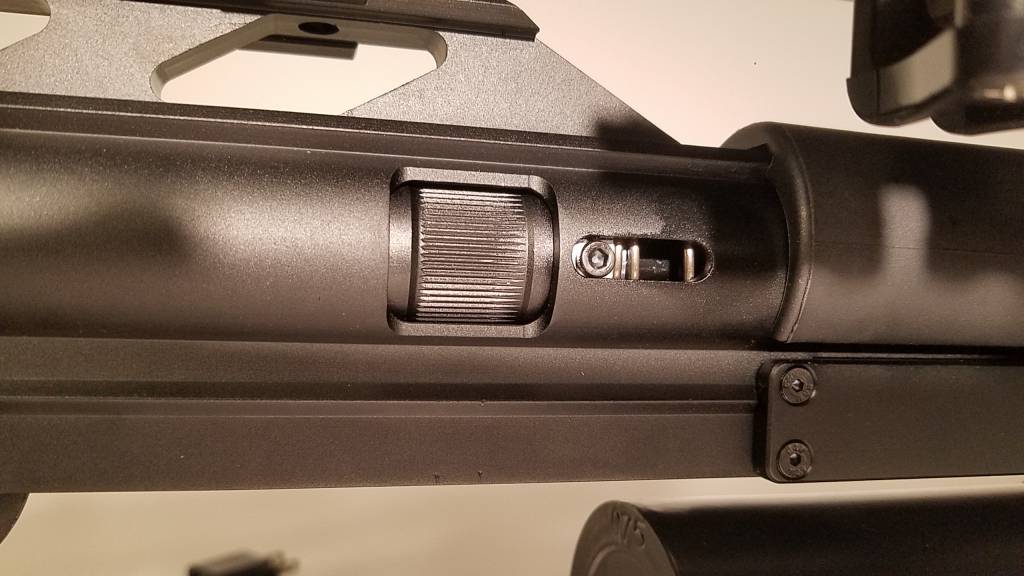

The adjustment wheel was all the way turned down. What does this wheel do? Can it make an 18gr JSB shoot better? I have all weight JSB pellets.

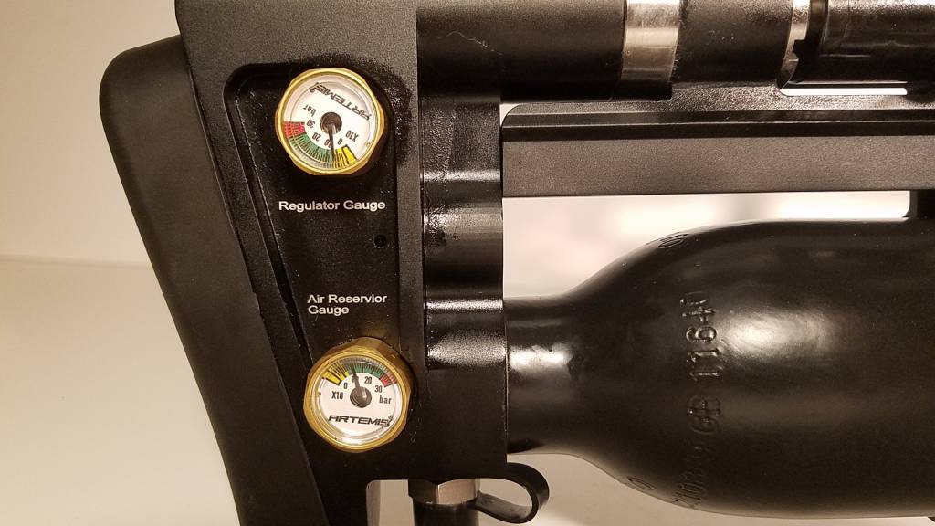

P.S. The REG dial reads exactly 100 bar (not 110)....I have never seen a gun regulated at 100 bar...???
it's low because all the air leaks out overnight as well...were going to ignore that for now...
the reg is pegged at exactly 100 bar when filled to 250 bar.

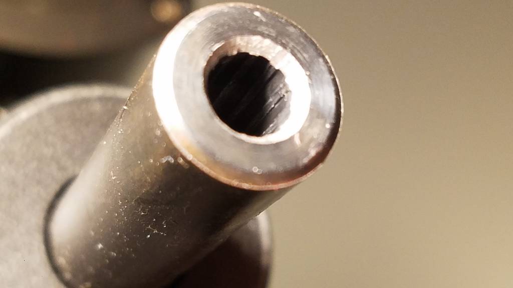

3” groups that close isnt tuning. Check the crown for damage/burrs, make sure everything is tight on the scope (mounts,rail,etc), try single loading for now to make sure pellets arent being damaged, clean the barrel for sure. Their cheap guns, qa in those type of manufacturers are awful. Also, not sure how the barrel is mounted but make sure its tight too.
I'll have to check for burrs. Everything else looks good. I cleaned it before I shot it with a crown saver. I checked all my pellets. It's a single shot gun. Fortunately I can see the end of the barrel with the LDC off.

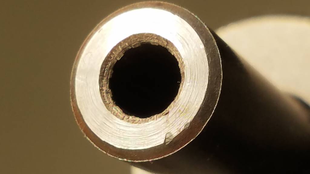

Does this crown look bad?

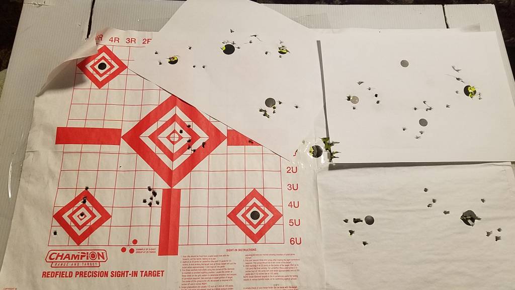

35 yards yesterday: (10 mile winds)
some of those groups were sighting in but 2-3 inches was average official group size. It wasn't the wind.
best group of the day 15gr JSB
Its likely a barrel issue. If there's any way to dial back hammer tension, I would turn the regulator up to say 135 bar, and dial the hammer back till you are around 900fps. If it still won't shoot…. That barrel does not look great
