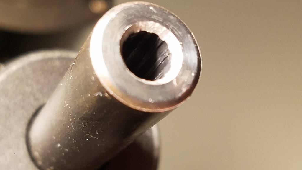

I'll have to check for burrs. Everything else looks good. I cleaned it before I shot it with a crown saver. I checked all my pellets. It's a single shot gun. Fortunately I can see the end of the barrel with the LDC off.

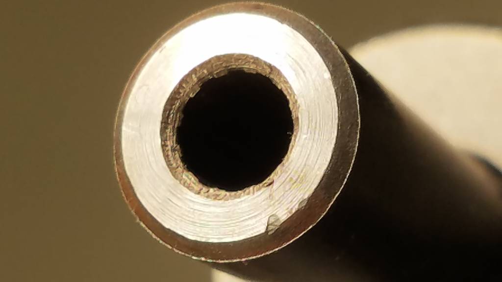

Does this crown look bad?
in the second photo, I see land damage about 1/4" back inside, typical SPA barrel lottery loser,
I have zero respect for SPA failure to correct this ever continuing problem, I vote with my wallet, no more SPA for me
That is a crappy barrel. At 1/2 price they're probably sending out something that may have already been returned.
I'd send it back for a refund and wouldn't waste more time on it, because that barrel needs to be removed and inspected for more damage. If no additional damage, I'd cut that damaged end and give it a new crown.
That Crown doesn’t look good at all to me.Very rough looking. And it looks like it might have a slight Burr but it’s hard to really tell by the picture.
That crowning job and rifling damage is disgraceful at any price. Sadly, it is a common practice for SPA. Both my CR600W and CP2 had similar damage. Fortunately it isn’t a difficult thing for me to correct but that is not true for most owners.
Crosman did the same thing for many years.
It’s really a shame too because every example I’ve corrected has done remarkably well.
My advice is arrange to send it back, show them the photos, and ask them if they have any plans to get their act together. This has been going on since at least 2017
