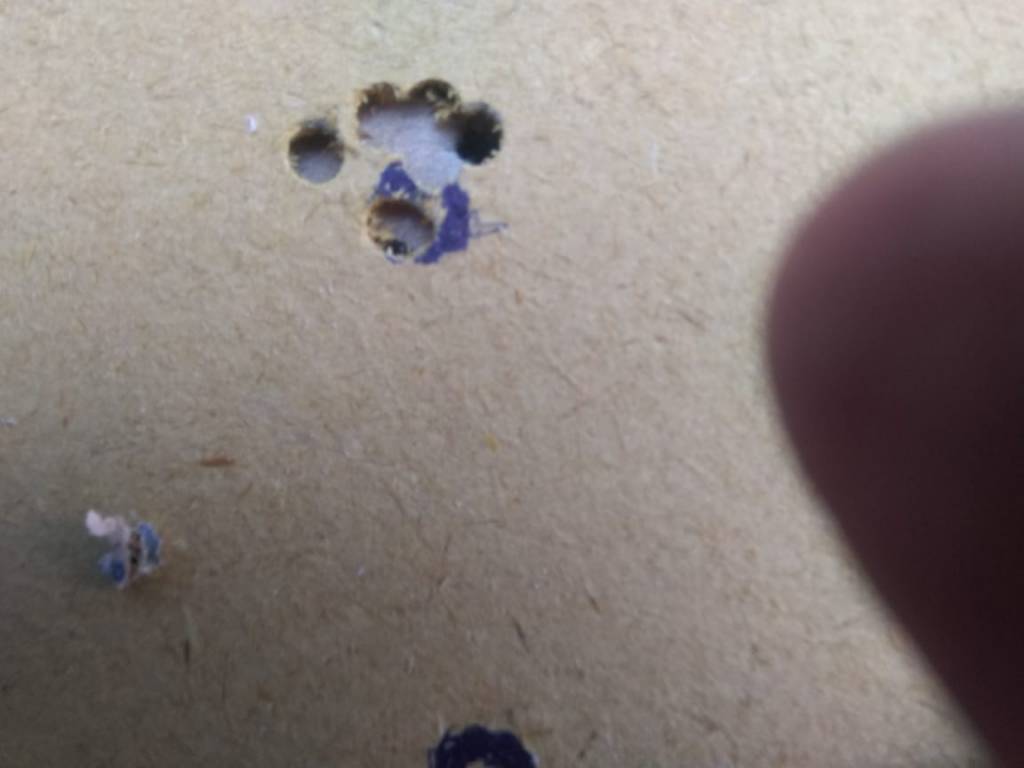

When I got my early Impact-X in .25, back in mid 2018, I ordered a .177 barrel kit with it. I put it on, for a short while, once and simply turned the power wheel from Max down to 1 and it immediately shot the JSB .177 10.34 domes in one hole cloverleaf groups at 50 yards. Probably good enough? Had pics but don't know what I did with them.

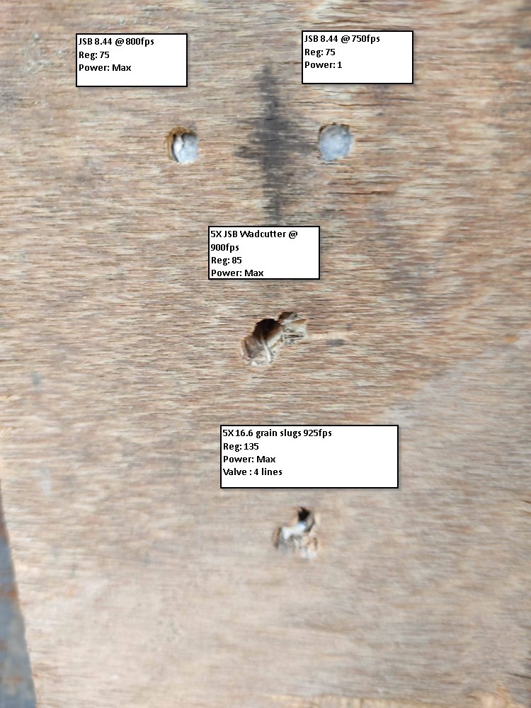

Recently I purchased Impact MK2 in 177, I asked FX USA about liner. They said its Superior Liner.
I have some piledrivers 21gr and JSB beast 16.2.
I tried Piledriver with a very little expectation and surprisingly its shooting well 35 yards (Reg 155bar, Power wheel Max)
Piledriver 5 shots 35 yards 932 FPS
JSB beast 16.2 10 shots 1040 FPS 35 yards

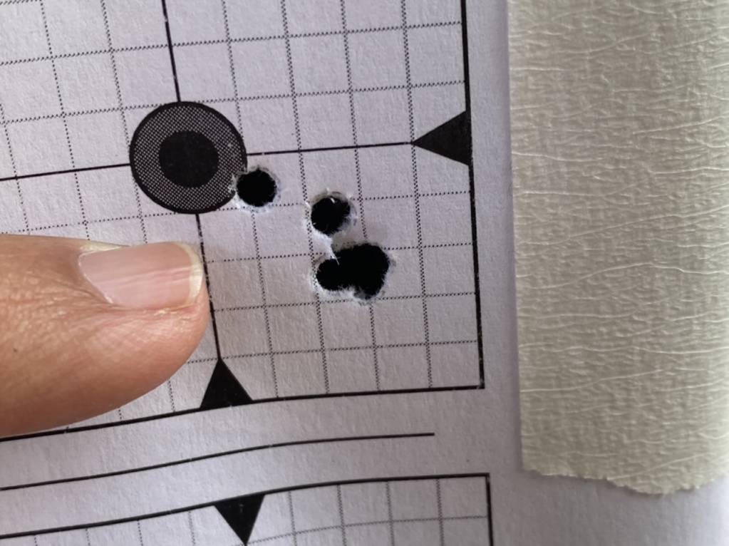

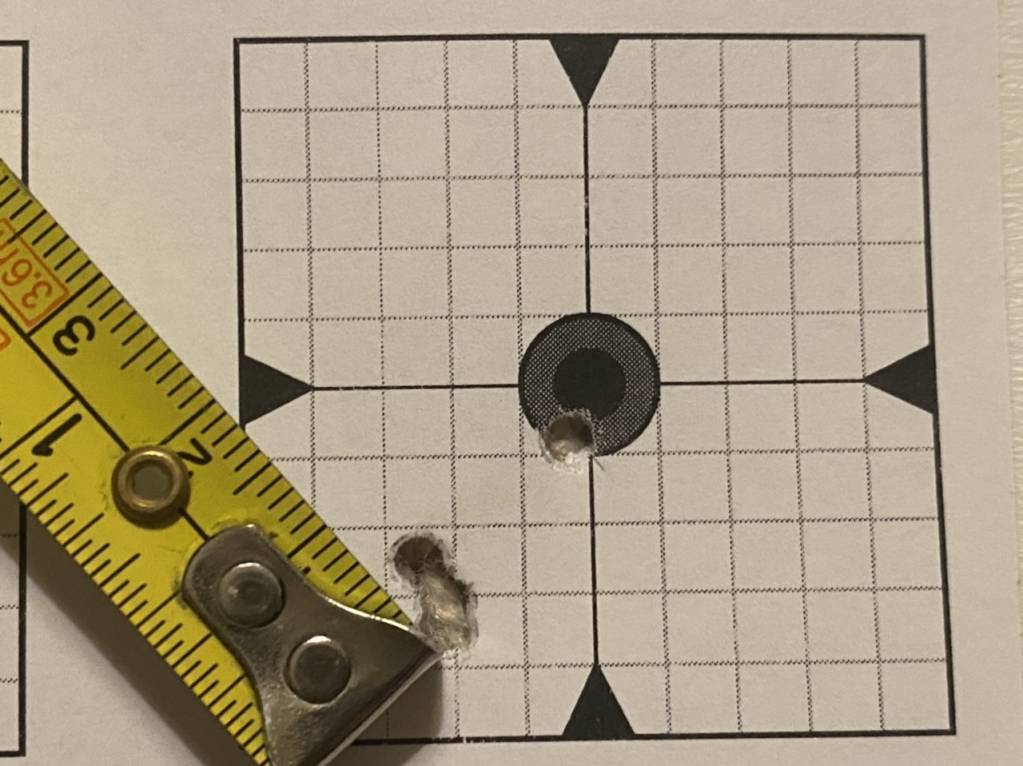

NSA 12.5 slugs out of 500mm superlite barrel from crown MK2. 5 shoot group at 34 yards/30M and the one on the bullseye had major wind shift, 4 in 1 hole when the wind is consistent.
6 shot group and wind picked up/I pulled, also 4 in one hole. The center dot on my reticle almost cover the bullseye so definitely could be me.
I can do the same with even crosman pellets if there is no wind, FX 177 guns/barrels are absolutely more accurate then I can shoot.

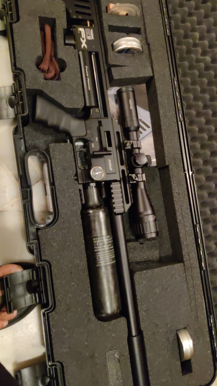

I would LOVE for FX to come out with a 700mm .177 slug liner! I had to machine an Alfa Precision barrel to shoot the slugs I want out of my Maverick. The extra couple of inches sure would be nice to have for the 20+ grain slug varieties. The AP barrel is a laser with the Griffin 22 grain slugs, but I haven't tested it yet with the new NSA 20.5 grain slugs. My Maverick can make over 50 fpe in .177, so a 700mm .177 slug liner would be SWEET for slinging some 23/24 grain slugs! I have another AP barrel that does well with those, but I'm hesitant to machine it for the Maverick, since it is 16mm OD, and will add quite a bit of weight to the gun. The other AP barrel I did machine is 15mm OD and still adds quite a bit of weight to the gun at 25" long. A 700mm liner sure would solve some problems for me at least!
