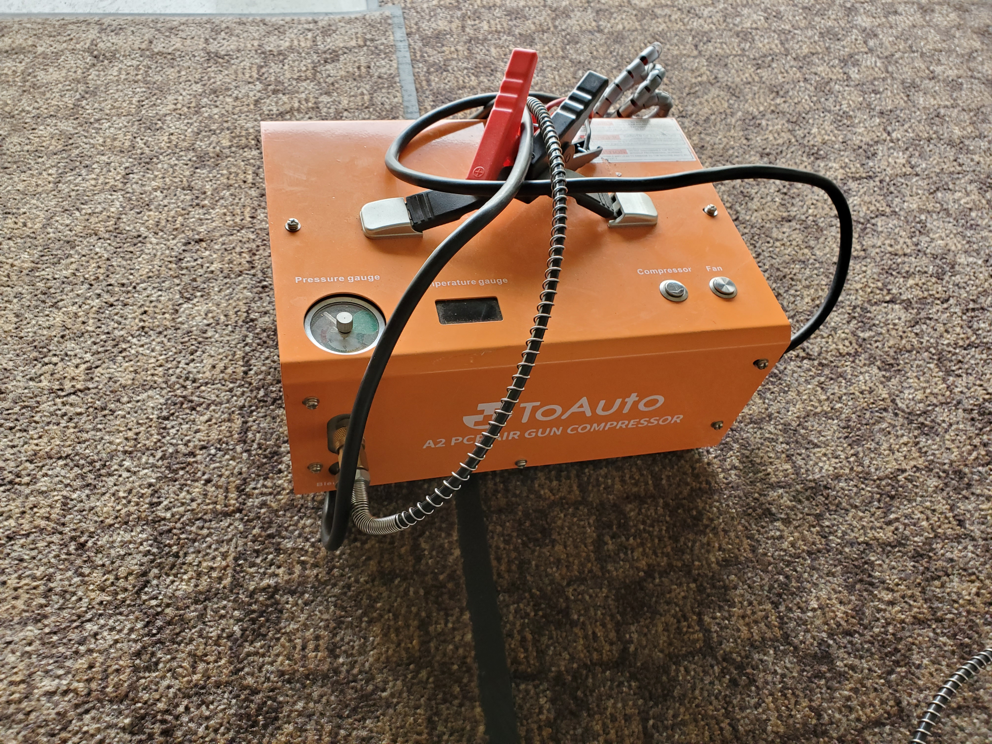

When you guys refer to oilless box I am assuming you mean my Vevor. It sounds like there is no oil in it and has a bad rod knock. I knew what I was buying from reading here. I usually don't buy anything from china as I am never satisfied with the quality. The Vevor did not disappoint. First time I hooked it up to my truck batteries sparks flew. The connector on the other end was not even crimped. I just couldn't see $1,500 for something that very well likely sit in my garage never used after 6 months. I want to be sure I stick with this. Before I bought my Armada, I hadn't touched my break barrel Gamo in probably two years. Well, I'm doing my first mod so maybe I'm in it for a while. I only use the Vevor for taking the gun up to 2,900 psi. Never let the temp climb more than 3 degrees C. I'll start using the hand pump more. lol.
Reactions: 6gun
The scotch yoke in these does sound like a big end knock 😂
