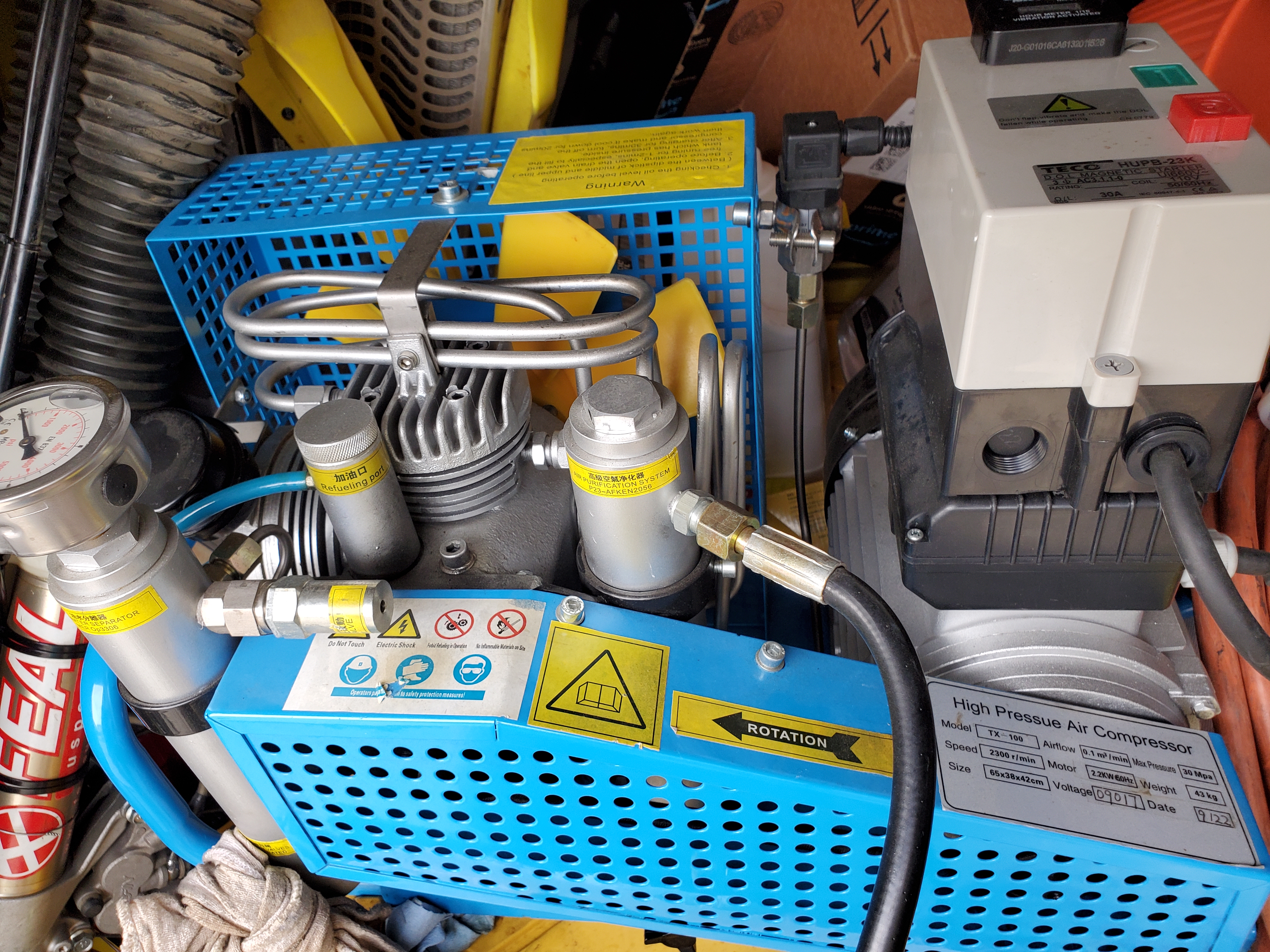

I like my CS3. I only fill guns with it. I like the fact that I can reload mags while it's doing it's thing. I like to have enough mags to match shot count with full fill. If you don't trust the auto stop, don't use it. Just set it high and watch the gauges like any other compressor.
I made a bracket and mounted the power supply to the side of the outside case. I left a space between the PS and the case for airflow... maybe 3/8 inch.
I have the 120v version running on a dedicated 20 amp circuit with no problems.
Mine won't play on 20a for the lra but im not sure we have the same compressor. Mines a 4 cylinder big boy. I also don't know how fresh the breaker is on my 20a in terms of cylces it's seen on/off. My 5.5kva genset won't start it either 😅. Soooo I did some eletlctrician work and ran a big circuit to the garage.

I think they were a little generous with the data plates on current draw. They didn't list locked rotor draw, i suspect the 2200w rating on mine is unloaded motor draw too. I may put a 3 phase motor on there and use a 240v vfd to soft start it or do some creative load based programming.
