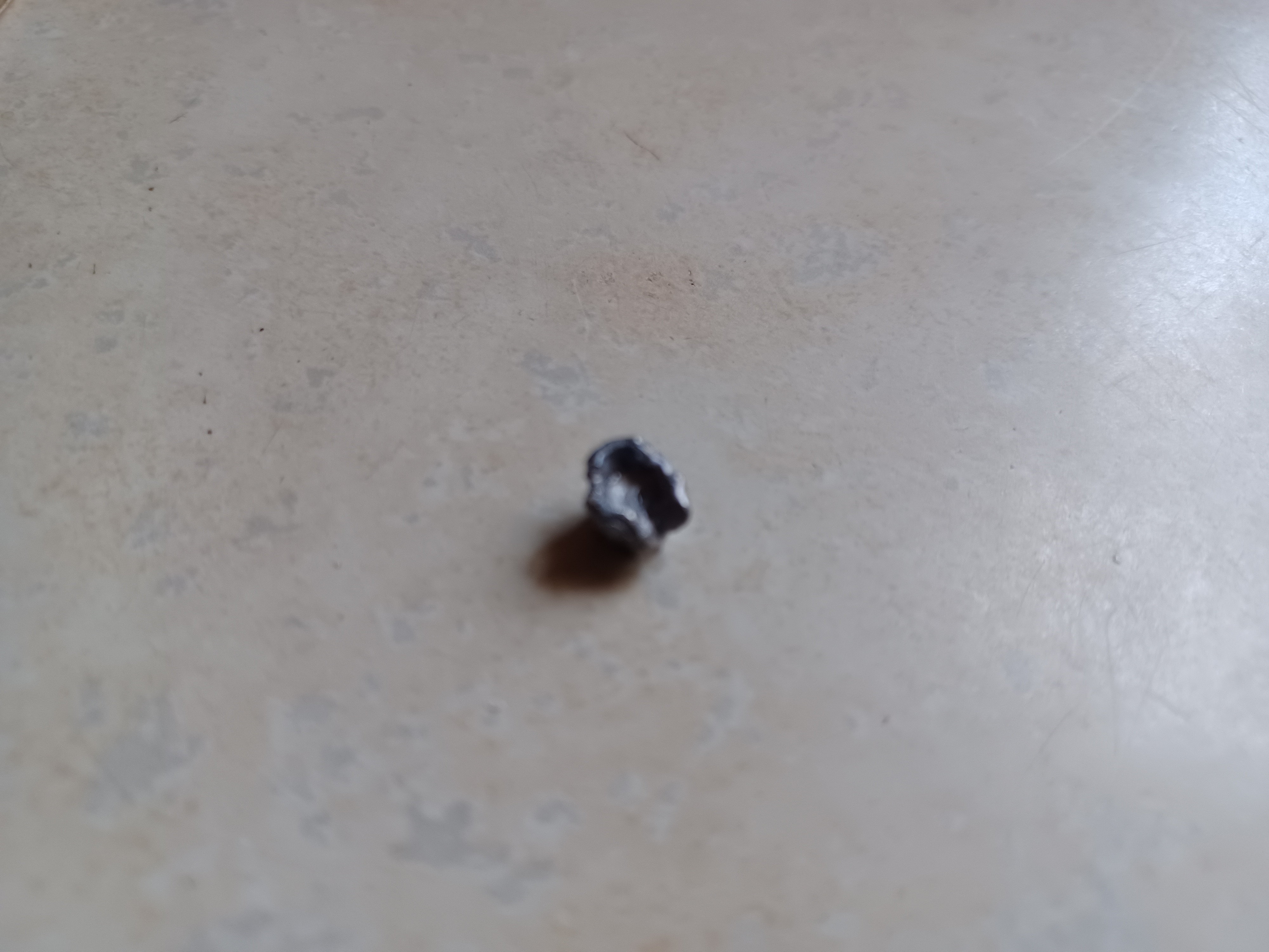

As for NSA slugs, I hit a squirrel the other day thru the right shoulder, all the vitals, thru left shoulder, and it stopped just under the skin. 28 fpe give or take on impact. Here is the recoverd slug. 17.5 grain. It didnt expand as well as i thought it would, but definitely expanded. The squirrel rolled over and died.
Then I got a squirrel with a 25 hades doing around 45 fpe on impact and it passed thru hitting the back stop. She dropped and coughed up a huge blood trail and took off but rain out of blood fast. Point being, the energy didn't "shock" her, it zipped thru and splattered the heart and lungs but she had the faculties to flee.

As for NSA slugs, I hit a squirrel the other day thru the right shoulder, all the vitals, thru left shoulder, and it stopped just under the skin. 28 fpe give or take on impact. Here is the recoverd slug. 17.5 grain. It didnt expand as well as i thought it would, but definitely expanded. The squirrel rolled over and died.View attachment 311703
