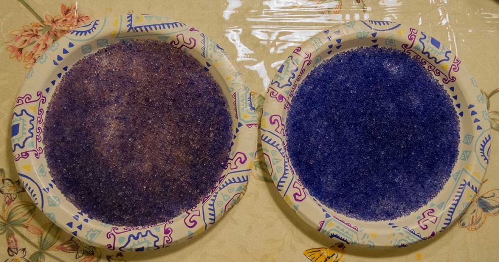

I decided to take a look at the desiccant filter I've been using between my Shoebox and buddy bottle this evening. Take a look at what I found. On the left is the color changing desiccant from the gold filter. On the right is unused desiccant. The unused stuff is a deep blue. The used stuff is kind of violet to pink. Proof enough to me to keep using this filter. Hopefully the colors as posted here will be accurate enough to see the marked difference. Glad I checked now.
Thank you for this, I am in full agreement with your findings regarding indicator color change. Those are silicia indicator beads, I believe?
What specifically and emperically did they indicate other than color change? How much moisture did they eliminate? How much of the eliminated moisture would cause a problem with an air rifle? Which air rifle would have that problem?
Thanks again this is great data and field testing, much appreciated and thanks for sharing!
Good questions that are not going to be easy to answer. I'll use the desiccant filter for now and check my PCPs air cylinders say in a year or so. That's about the best I can do. You would think this information would be around somewhere, from airgun manufacturers at least. If there is I haven't found it and they are not telling otherwise. It feels like we are the only people asking these questions. Given the dangers inherent in these designs we need to do better.
It looks like Flintstone is using silica gel beads with cobalt chloride as the color change indicator to show that the beads have become saturated and can no longer adsorb additional moisture. Deep blue = dry. Pink = saturated. In general, I've learned that silica gel holds a weight of water equal to between 30 and 40 percent of its original weight. So, 30 to 40 grams of water per starting weight of 100 grams dry beads. He' could weigh those beads before and after drying (regeneration) to give us an idea of the actual amount of water. When mine gets to that point, I will weigh it before and after as well, and share the data. Thanks for sharing the pictures, Flintstone! And thanks for your continued participation as well, LMNOP. Life and work are very busy for me right now, but I am continuing to research this issue and it's possible effects.
@ Flintstone.
That silica jell stuff is recommended for low pressure use and is supposed be less efficient at higher pressures. I would only use it on the inlet side of my booster. For your high side, I recommend that you get some 13X molecular sieve. That is the recommended media for high pressure filters. You can salt the MS with a small amount of the colour changing silica jell to give you an idea of when it needs changing. I agree with James that the best place to filter is on the high side but for different reasons than all that mumbo-jumbo about dew points and temperature changes. It can't hurt to feed the booster with the driest possible input air if only for the benefit of the inside parts of the pump.
Do you keep the output hose capped air tight when not filling? If you don't then the moisture in those beads could be from the normal air in the room. Try putting some of those bright blue beads into an unsealed box and let them sit in the room for for the same amount of time.
James, this is a great idea. Weigh the filter before a fill cycle, weigh the filter after, the difference would be the adsorbed water weight. Great discussion and no worries with work and life taking up time, that's the way it's supposed to work :) Us Interent forum folks should be lowest priority.

Oh, and thanks for the tip Eaglebeak. You don't have a reference that can be found on the internet by any chance. I don't have a problem with switching to 13x molecular sieve. It doesn't cost that much. Since this discussion has started I think we should aim for a reference work that all can use.
There's lots of info online. This one is a good start. https://www.agmcontainer.com/blog/desiccant/selecting-desiccant/

I haven't yet found anything about silica gel not working well at higher pressures. I did find info that it works better at higher relative humidities and temps below 77 degrees F. Molecular sieve seems to be preferred for its better performance at the filter tower temps encountered in tropical areas as well as at lower relative humidities, which is the case as the air is dried as it passes through the desiccant media.
