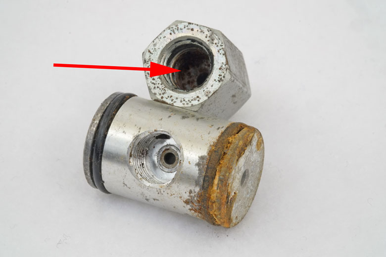

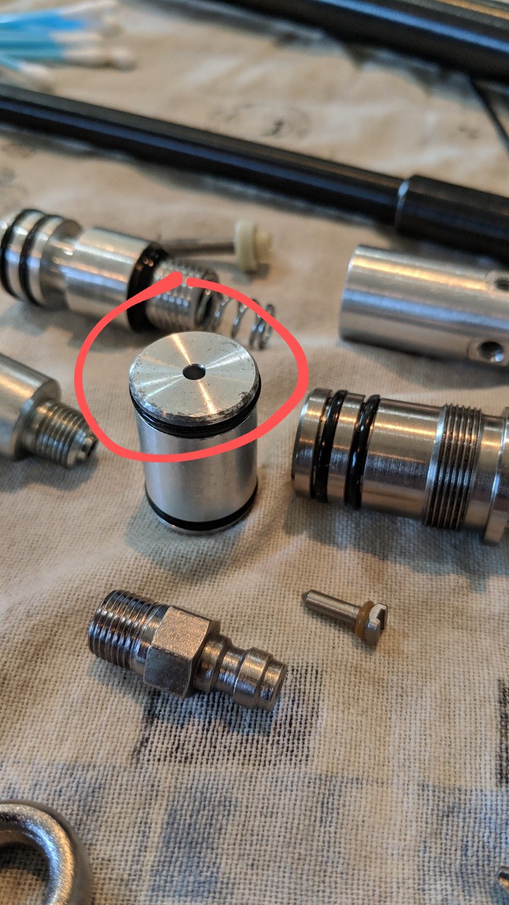

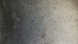

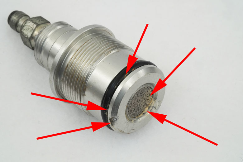

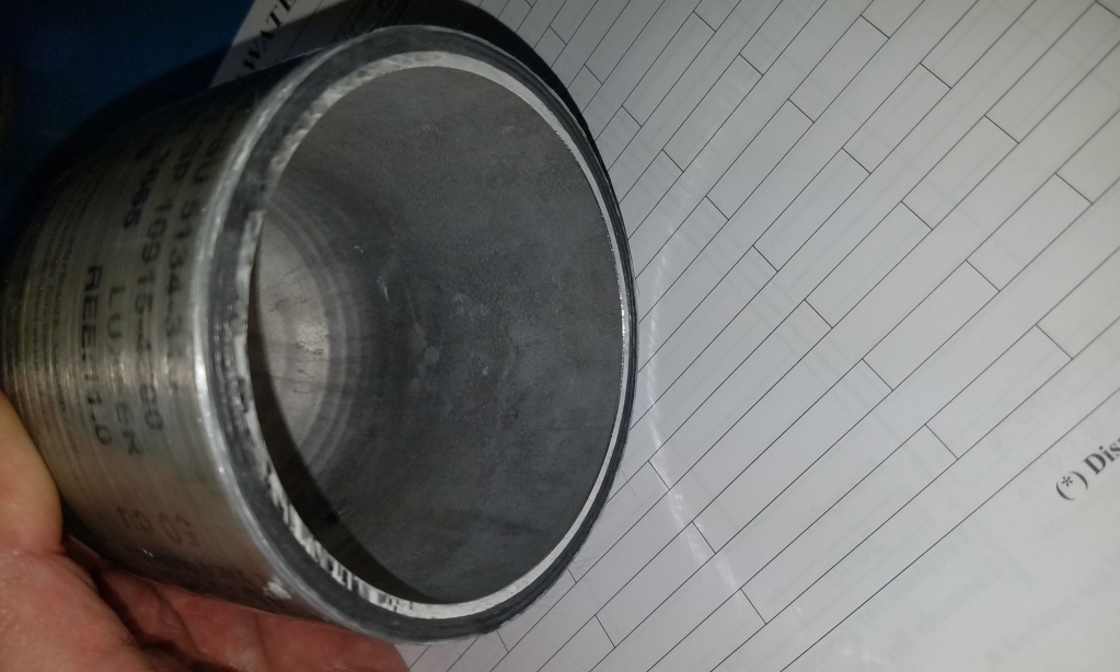

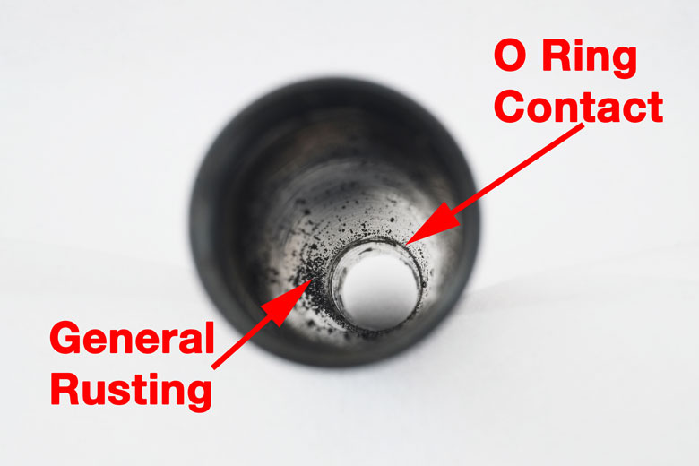

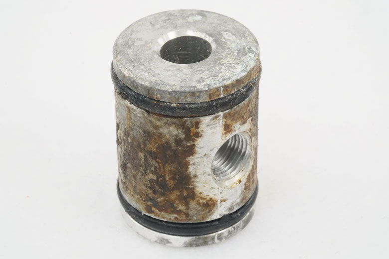

LMNOP, I did find some photos to share. Sorry it took so long to post them. Here are a few.
Again, I realize that most of us may never encounter these issues; however, I believe it will be easier for me to avoid the potential for this kind of damage than it will be for me to try to figure out just when and where this kind of damage can occur and then let that dictate when and where I can shoot. Maybe this isn't the route for everybody, but it's the one I will choose for now.
