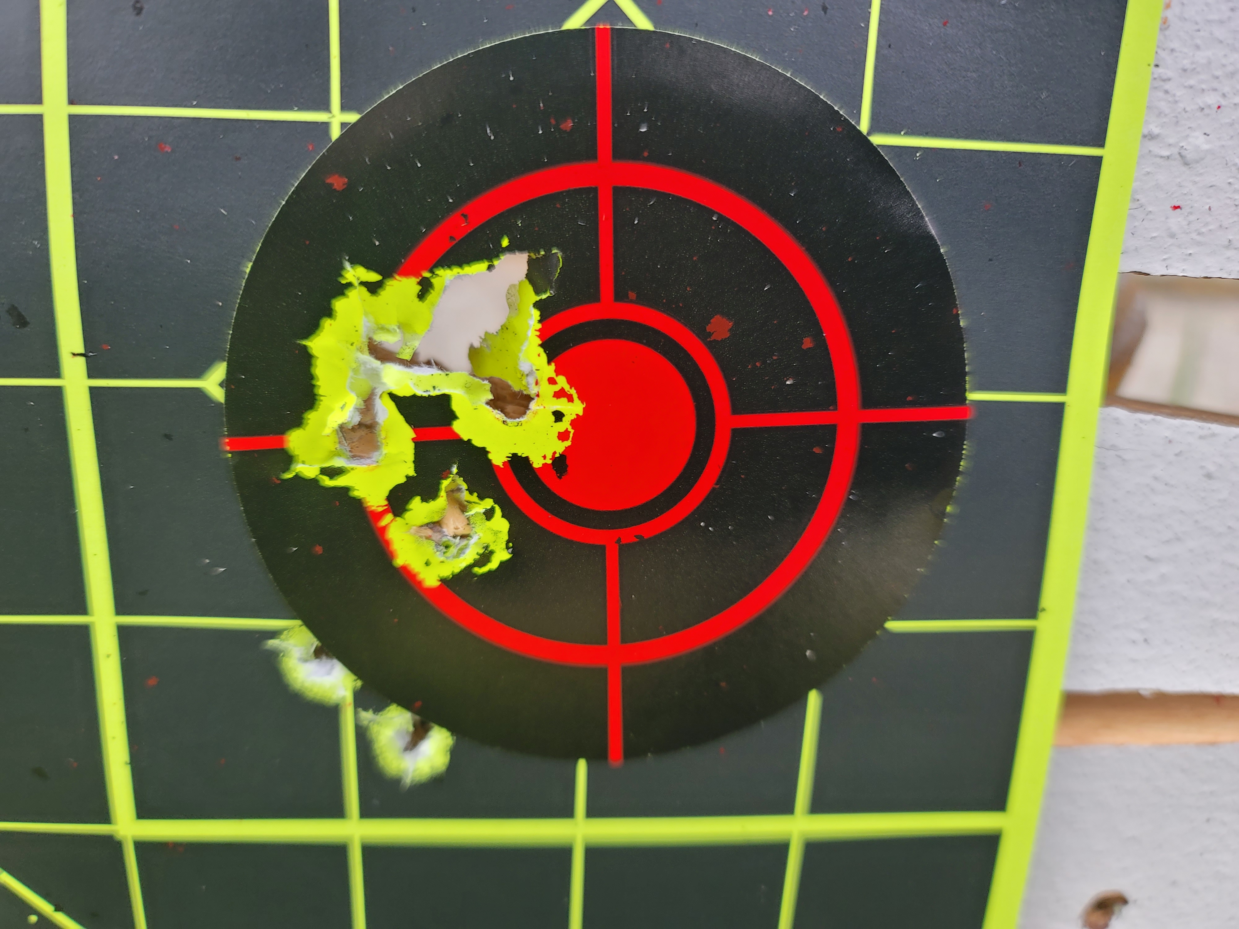

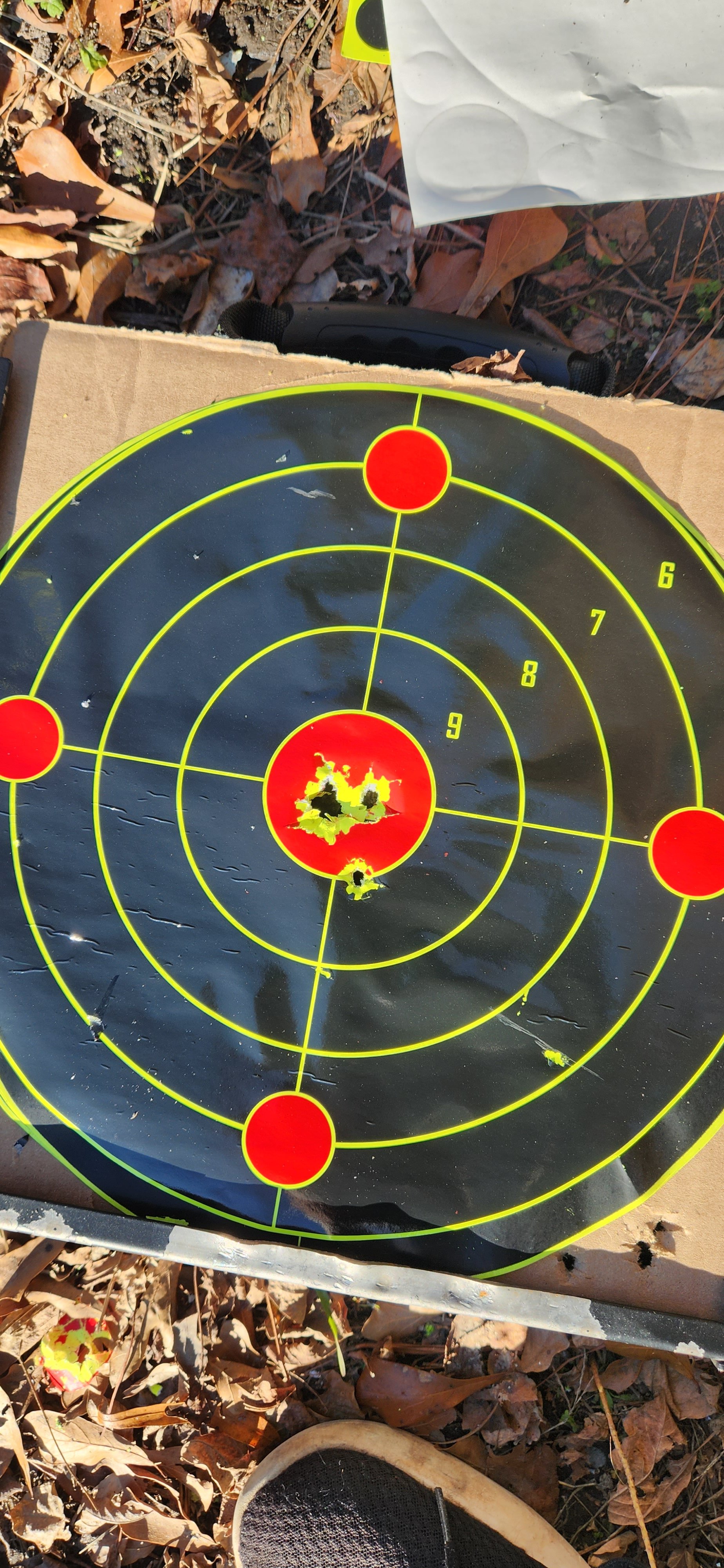

Why is it always like this? 5 shots at 50 yds. Always one that flys away!! 😂 My Kral Bighorn .30cal 44 gr JSBs. Well we’ll get ‘‘em the next time…
Say out loud so your gun can hear you that you’re going to shoot a six shot group but only fire five. 😃😃
If you don't want to bother with sorting pellets (don't blame you if you don't), just shoot it over a chronograph the whole string. Most times, you can see an out-liar there too.
Another problem one of my guns had was that the pellet would sometimes scrape the air inlet hole or something on the way into the barrel so that there will be deformities in the skirt or head. In my case, there was a small burr on the breech end of the barrel. Polishing it eliminated the problem.
One thing you can do is to point the barrel straight up or straight down when you load it. If the pellet "falls" in, or just rides in on the breech tip, that can alleviate this issue so you can track it down.
