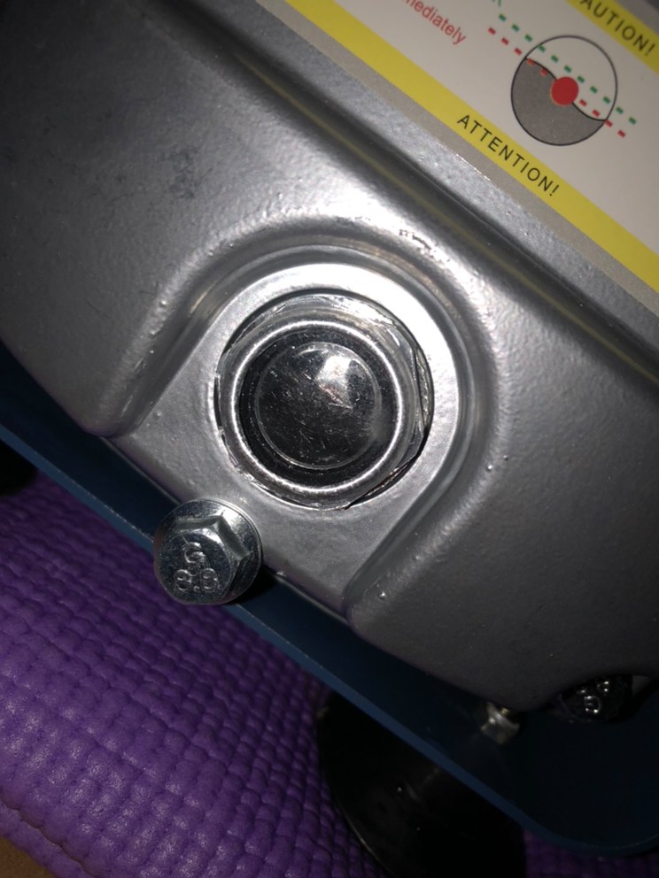

Why is my 2nd fill so damn dirty on my yong heng only after 15 minutes
I need to know if this is okay to use its secolube 500 Its only been in there 15 minutes but its this dark WHATT??, I though the first oil change gets all that stuff , How come only 15 minutes in an my secolube is that dirty is it alright to use despite the color its only 15 minutes old.
It's pretty common for a lot of us! I posted similar questions after my 1st oil change on my YH, using Royal Purple at the time. I switched to Husky on my 2nd change and while discoloration still happened it wasn't anywhere near as bad. Did you dedicate some new oil to flush through before putting the plug in or did you just drain & refill? I always do a flush & it helps.

I actually did flush it out with brand new husky full synthetic 7 ounces or 6 I then drained it I didnt want to mix my secolube, I spilled it so thats that, Right now I got my secolube an its like black only been like 25 mins on it.

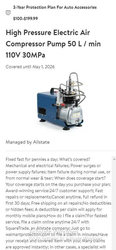

If its fake then bring it on cuz I got allstate 3 year insurance for like 20 dollars. https://www.walmart.com/ip/High-Pressure-Electric-Air-Compressor-Pump-50-L-min-110V-30MPa/306365500 this the link I bought from

Wow 5 hours thats great to hear I though it was 2 hours or so, Im babying mine a little too much I think im even sparying a little water on the top nut an the side one where the metal it gets so hot the water vaporizes into steam immediately but yeah Imma do some more fills on it for sure that secolube aint about to be poured out its only got like 30 minutes on it great deal I got mine for 216 thats so damn cheap weather its a fake one or real here is the link, It shows yong heng on the right side of the unit but when I got mine It dont have that 2nd pic it shows it without the yong heng label 3rd one yong heng label is in there so I bought it thinkin yong heng, I heard that someone got a fake unit an the oil turned black quick like mine, Weather or not I got a fake one dont make a difference to me at all as it filled the tanks it works I got 3 year protection an 216 dollars for next 3 years of unlimited air pretty much il take that!, The amount I shoot shot 600 rounds yesturday easy work for the yong heng though 3100 to 4350 on a 3 liter bottle is a few minutes I just topped Im sure 99.9% of the moisture is removed with my setup so thats why I even spray the parts that get extremely hot Im probably babying it way to much for 216 dollars im treating it like royalty putting in oil that costs me half the compressor for a gallon 🤣 spraying off the hot parts. got a fan coming. you might as well try an keep it cool that does keep the yong hengs longevity
Subtotal​
$174.19
Add-on services $22.00 3 Year protection plan Taxes $19.82 Total: $216.01= BANGER DEAL fake or real dont matter to me as long as it works an fills to 4350 at proper speeed its a work horse
