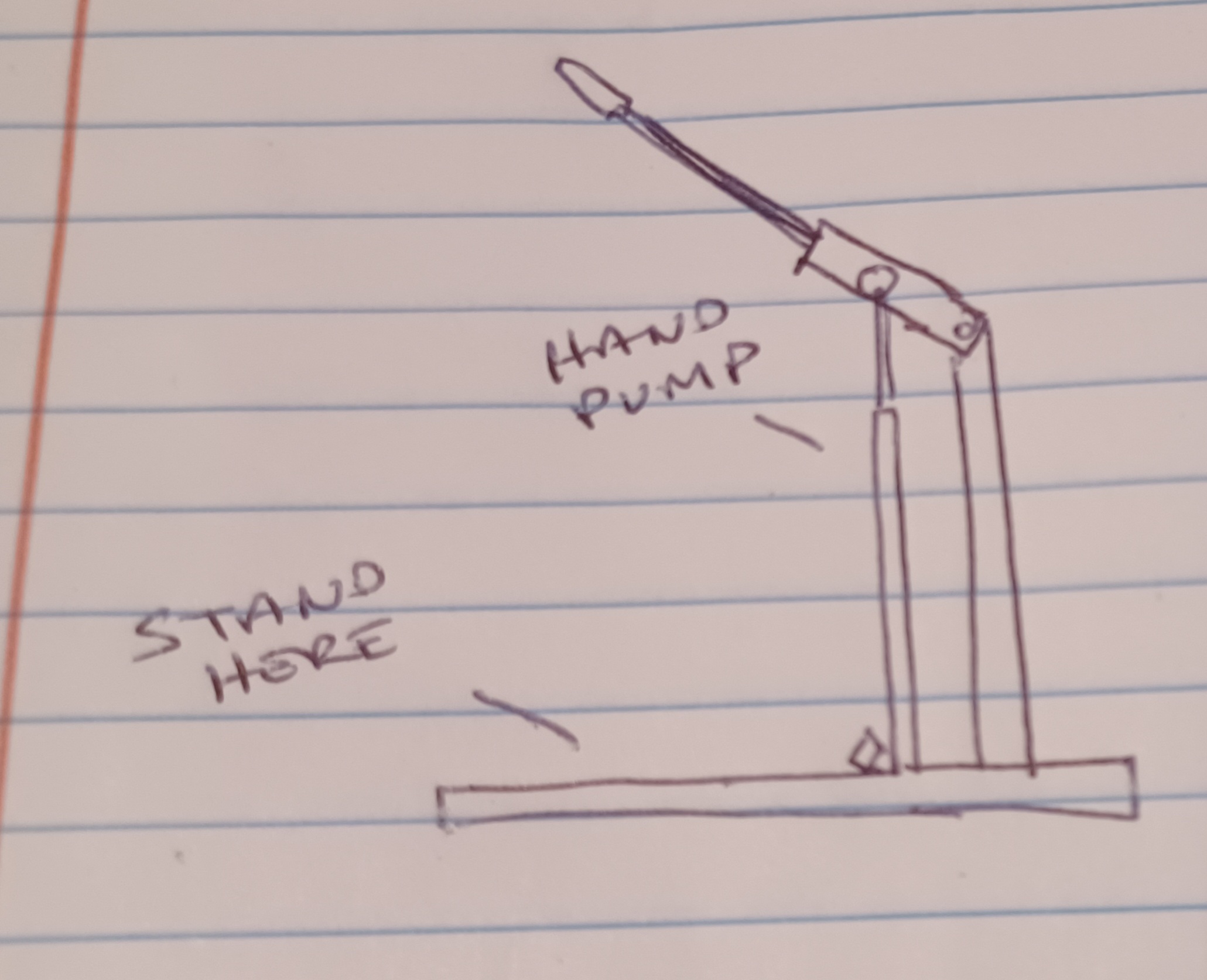

There was a hand pump I seen on GTA that was modified to have a lever handle so you could pump it like a well or drum pump. Made it way easier and able to do it with one hand at a time.
Of course I can't find the thread or picture of it now, but I remember thinking wow that a great idea to have for a back up fill source. I hate hand pumping.

Maybe something like this but built for high pressure and has a foster connect.
Hmm, I'm sure it could be done. As I see its effectiveness would depend on how much weight you would have to shift onto the pumping foot. Could be unstable once you get over about half your body weight. The hand pump operation is symetric and anatomically stable.
