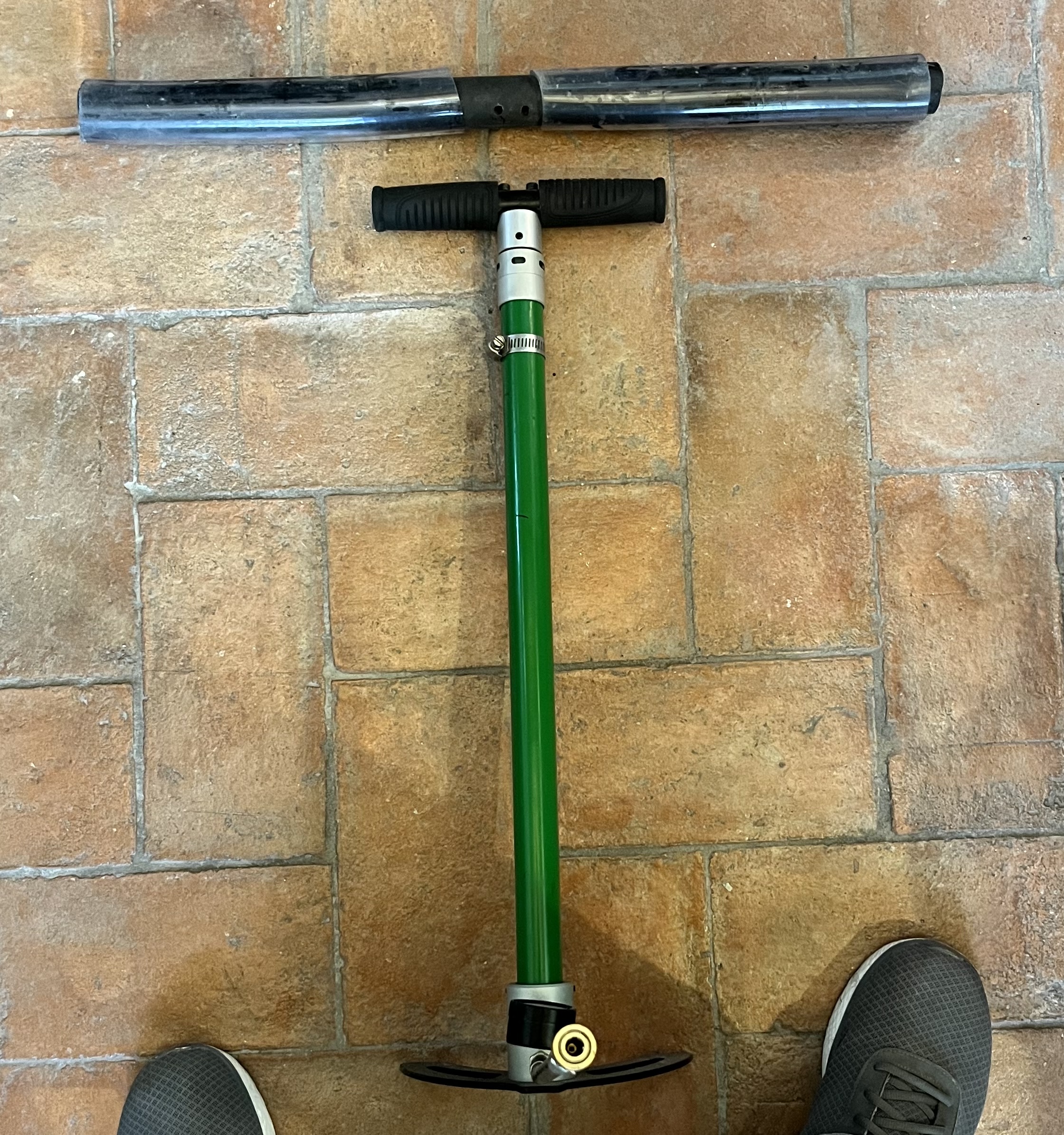

If you hand pump , best you can do is change the original handle for one of solid iron with enough weight to make gravity helping you in the effort pushing down.
It is very simple: buy a piece of would iron you can handle. Measure where to make the two holes for the screws, mount it an pump with less effort.
It is very simple: buy a piece of solid iron you can handle. Measure where to make the two holes for the screws, mount it and.... Pump with less effort.
Easy:
Don't you then have to lift that extra weighted handle on the upstroke, effectively cancelling out the ease potentially gained on the downstroke?
Reactions: BackStop
Nop.
The preassure inside the pump lifts the iron by itself. That works until the weigh of the iron equals the force of the preassure,
The size of the iron in the pictures is adequate and is lfted by the preassure of the pump.
Nop.
Must be the differences in pump design. My Hill MK3 handle doesn't raise by itself, gotta pull up. I was under the impression that it's doing is thing on both up and down stroke. I can hear/feel air moving on the upstroke. I always assumed it moved air between the stages and then the final compression was on downstroke.
I vaguely remember reading that pump handles aren't supposed to raise by themselves but can't remember if that was pre Chinese Amazon pumps or not so may no longer apply.
I wouldn't want the weighted handle on mine, with how it functions. But again, must be variations in design between our pumps.
