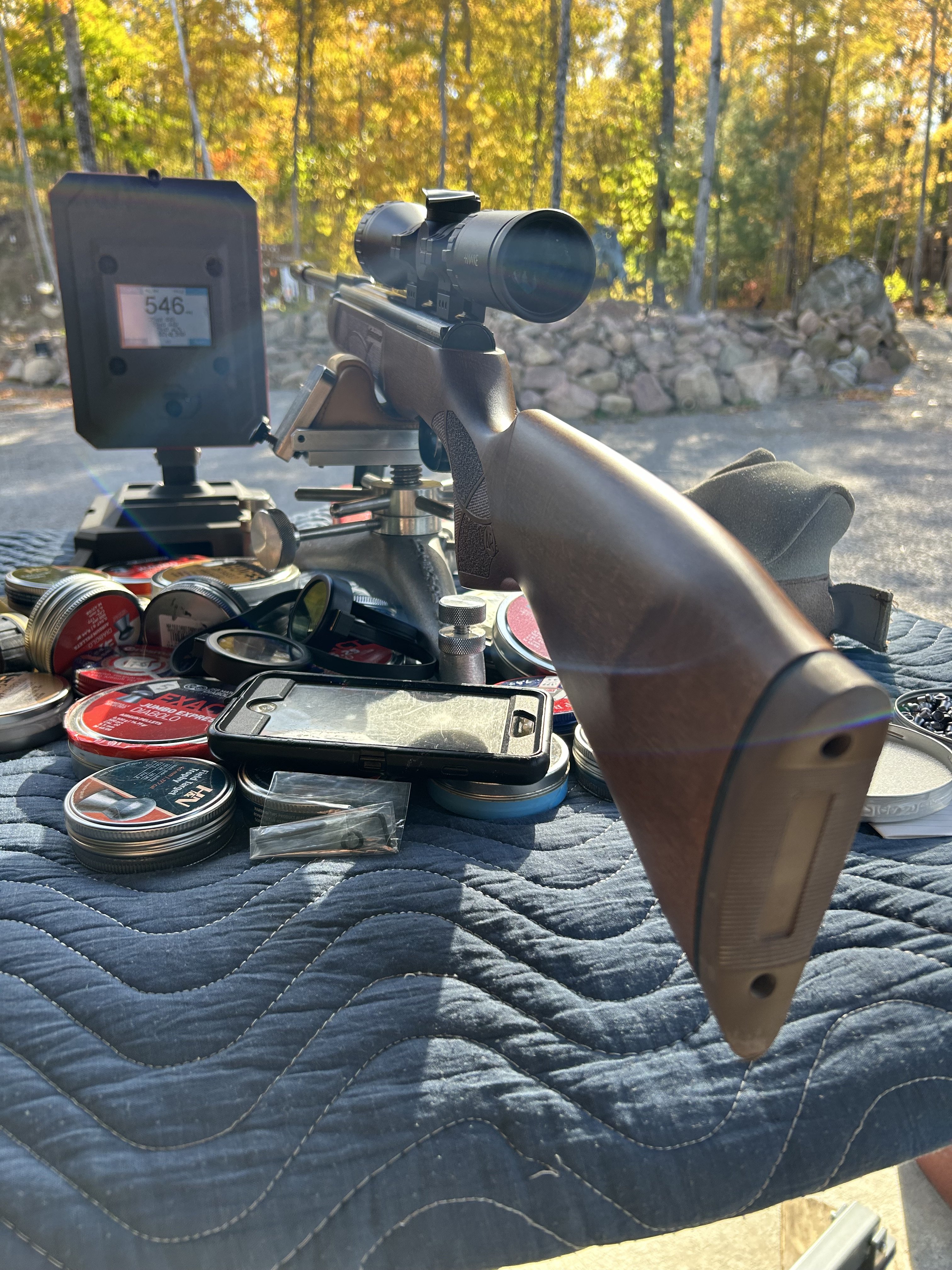

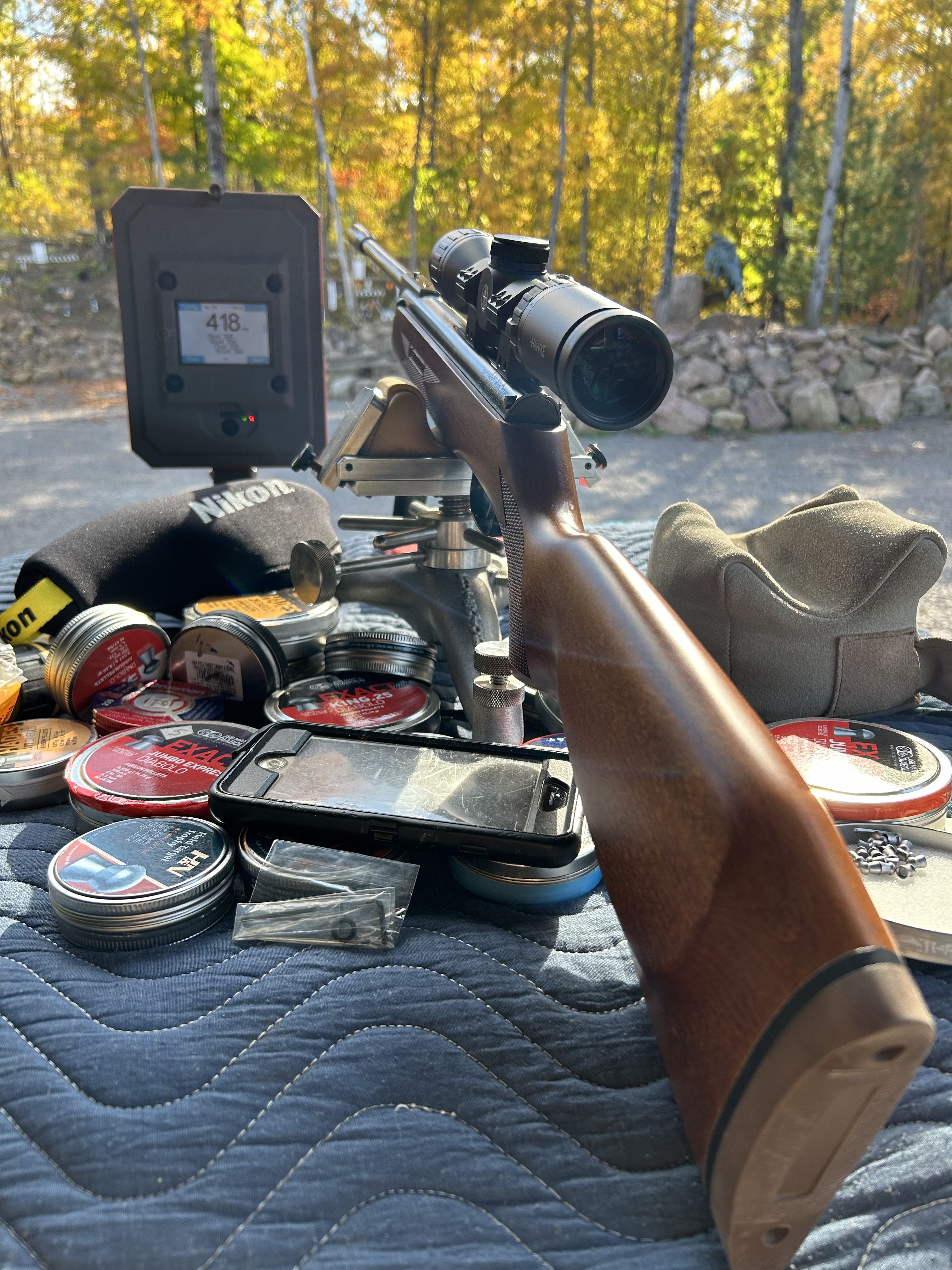

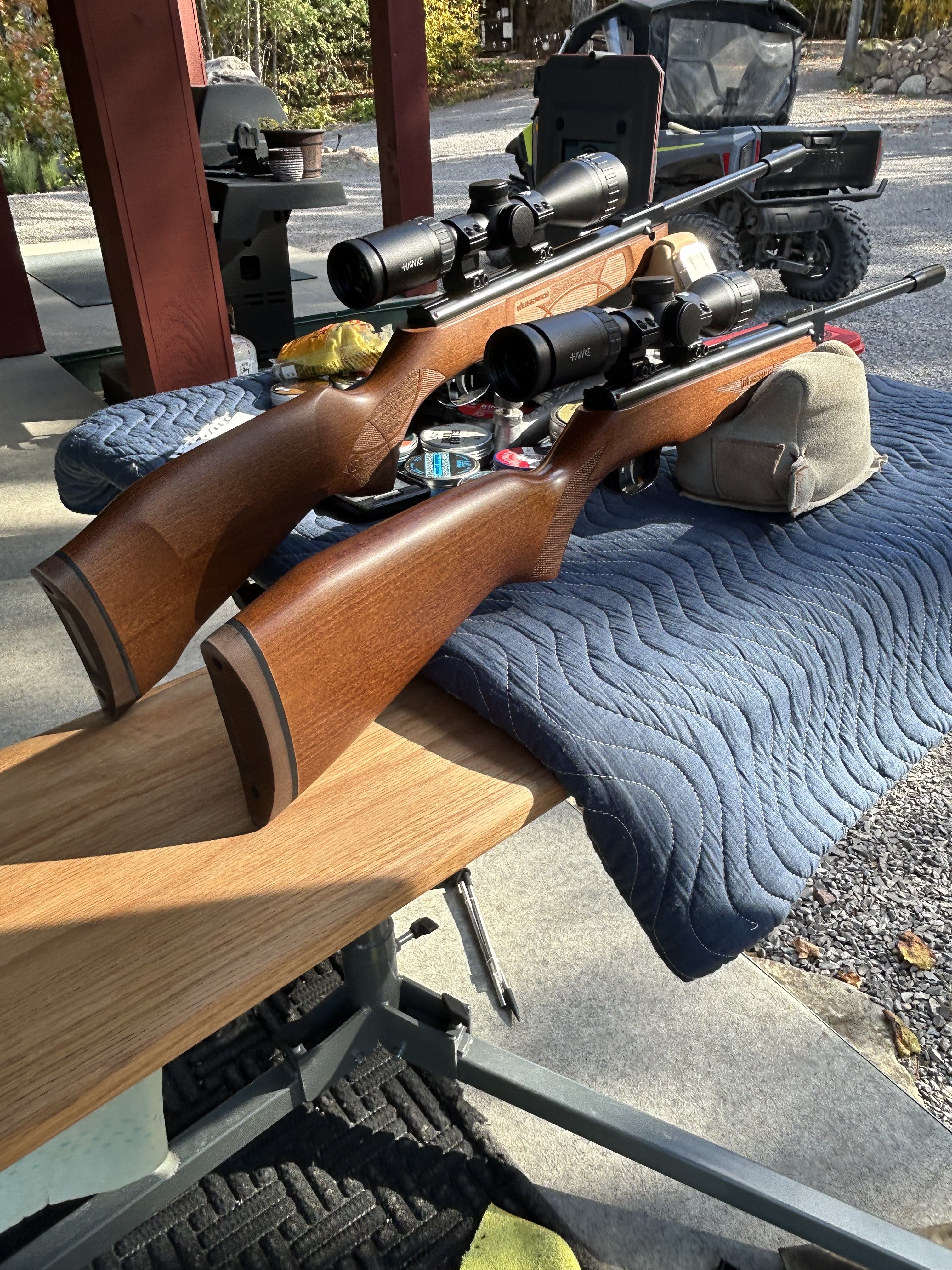

I took 2 sets of rifles HW30 and HW50 in both .20 cal. and .22 cal. All four rifles were never opened.
I also used the same grain rounds both new tins, 15.89’s.
I didn’t have a ton of time so each rifle was only average of 5 rounds.

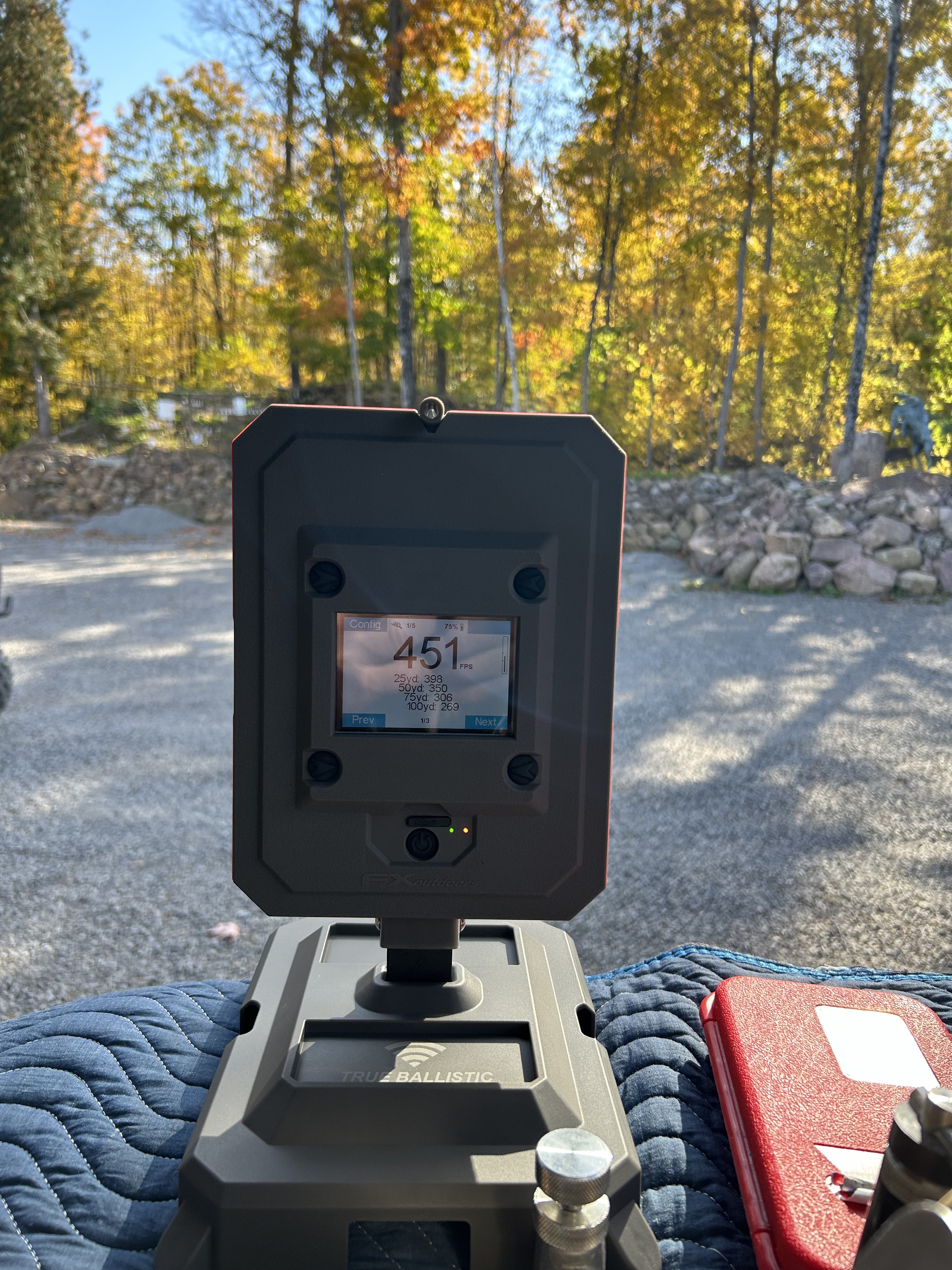

‘First up HW30 .22 cal. Average 451 fps. This gun is super accurate. High 456 Low 447.
Next of course the 30 .20 and average 418 fps. High 422 Low 413

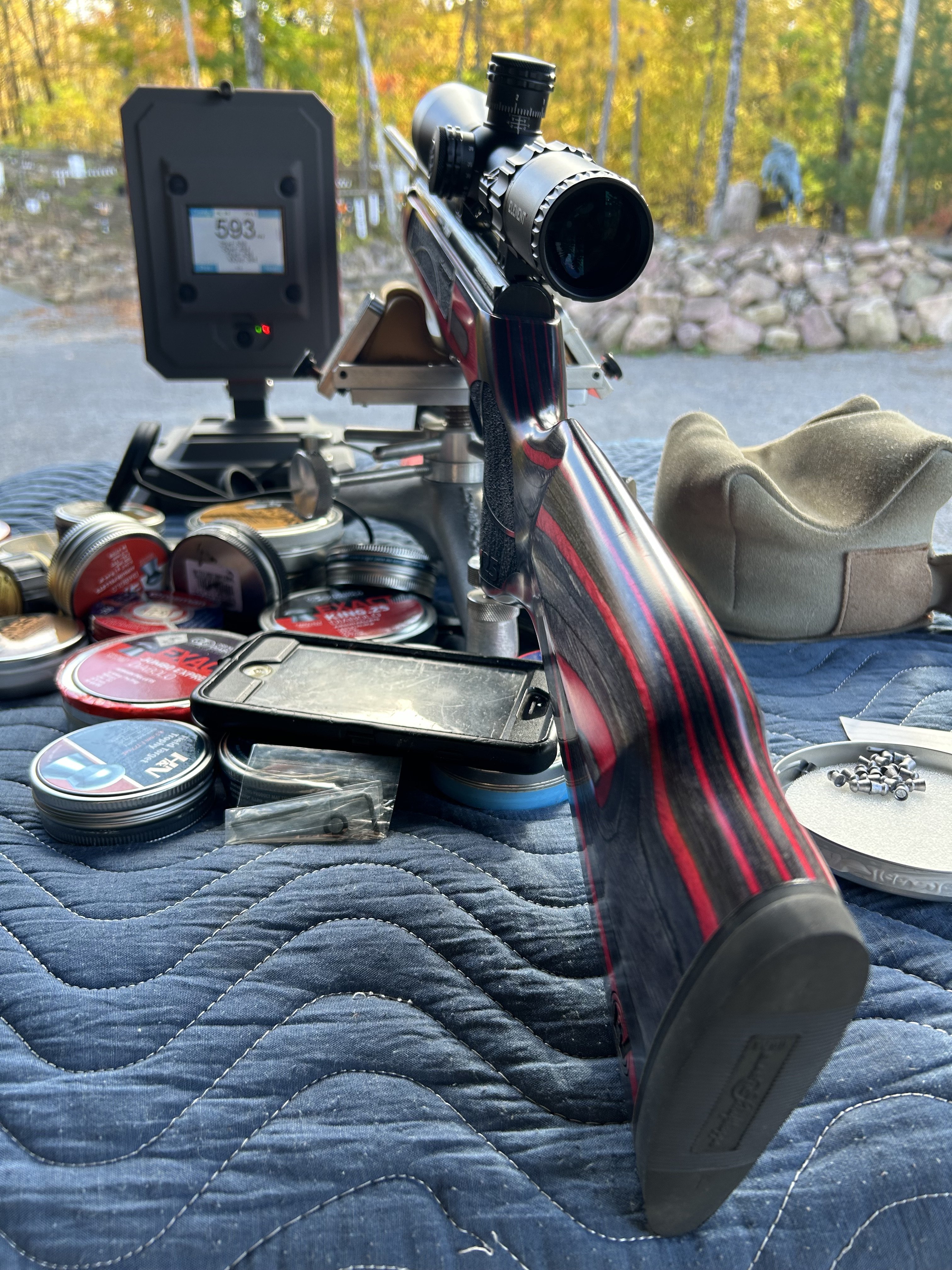

Up next a latest edition HW50 .22 cal. Average 593 fps. High 598 Low 587
Last up HW50 .20 Average 546 fps. High 551 Low 540.
I tried the HW45 in both cal but the crony would not register the pistols.
Just remembered I have the R9 and HW95 in both cal. untouched. I’ll run them tomorrow.
Same guns, different bore, same grain round. Different results. Interesting. Crow

The bores are different sized. You can't expect similar results because the pellets are similar weights. I told you over a year ago the 20 cal 15.89 JSBs are usually a dog in the Weihrauchs. I'm shocked they did as well as they did in the 95. Then again you're comparing them to 22 cal JSBs that are not usually a good pellet for power in Weihrauchs. Neither are making proper power, 20 cal at 636 is 14.27fpe and the 22 at 619 is 13.52. A proper 95 with a good pellet for it should make 16fpe in 20 cal and 17 in 22. JSB pellets can have great accuracy in 20 and 22 Weihrauchs but they're not great for making power.
Run 20 cal 13.73 JSB against the 15.89 22 JSBs if you want a fair comparison between rifles.
The 22 50 is making very good power for that pellet.
