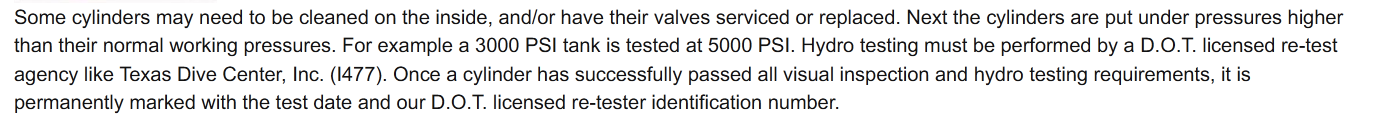

Actually, for recertification, they hydro test goes up to 1.6 x the working pressure. Going to 3X on every test shortens the life of the tank. Especially ones made from aluminum.
"Next, you will find the date of the original hydrostatic test as well as additional hydrostatic tests performed by an authorized inspection service. The aim of the hydrostatic test is to find out whether the tank is able to withstand the pressure. In particular, the testing measures the elasticity of the cylinder walls by filling it with water and then pressurizing the water up to 1.6 times the working pressure of the tank. If a cylinder fails the test, it is removed from service immediately."
Actually for scuba tanks between 150%-166% if you want to nitpick just to be right about something here, be absolute.
I quoted 3x because that is what Lloyd used on his test for an airgun tube, much like Marko did on his friends L2 to ensure it was built to his standards. That is considered destructive testing.
Add to that, what is 200 bar x 1.5, or worse 1.66? You correcting me here only drives home my entire point further, that OP's tube failed to meet such criteria. So thank you for that.
