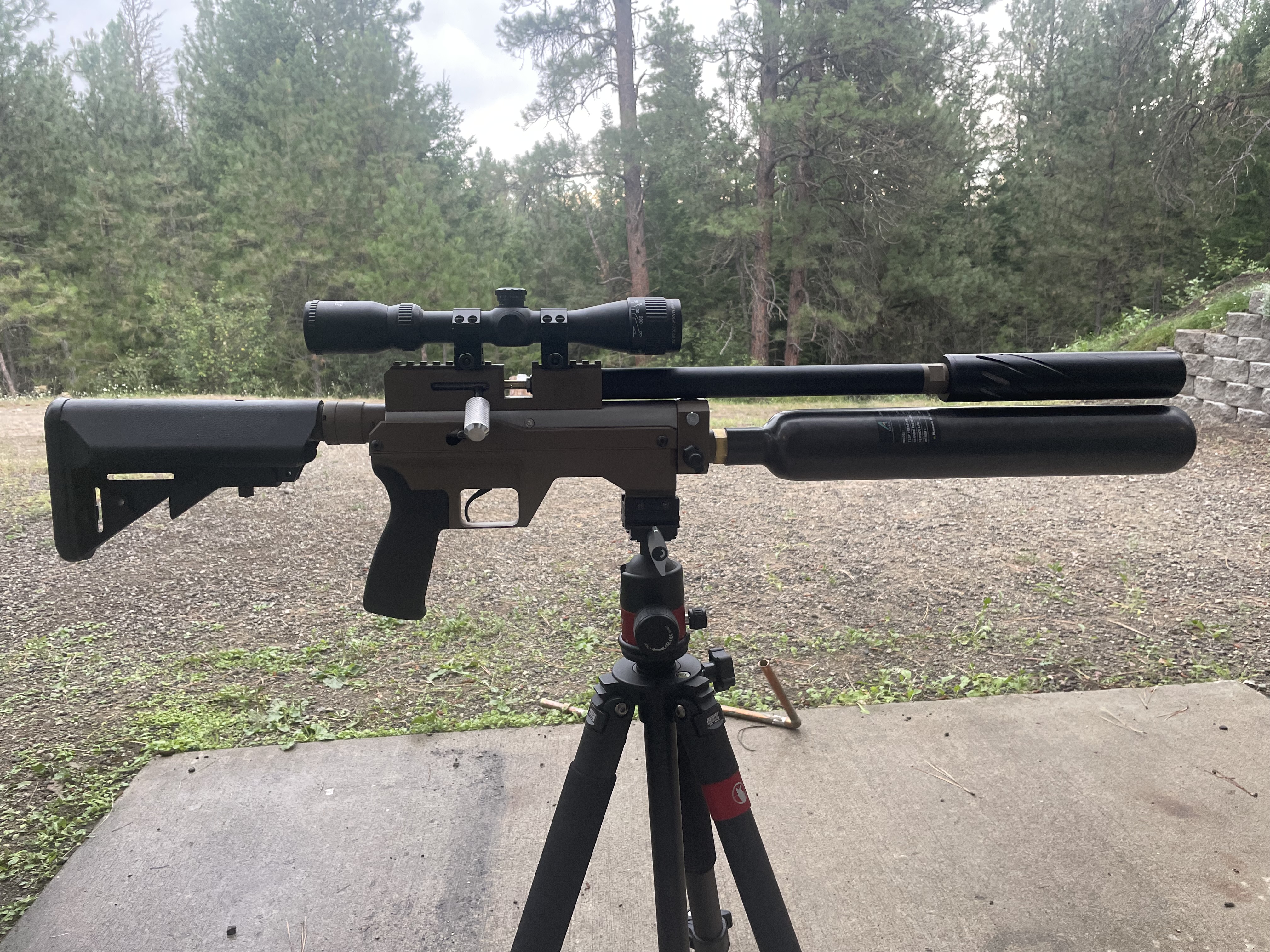

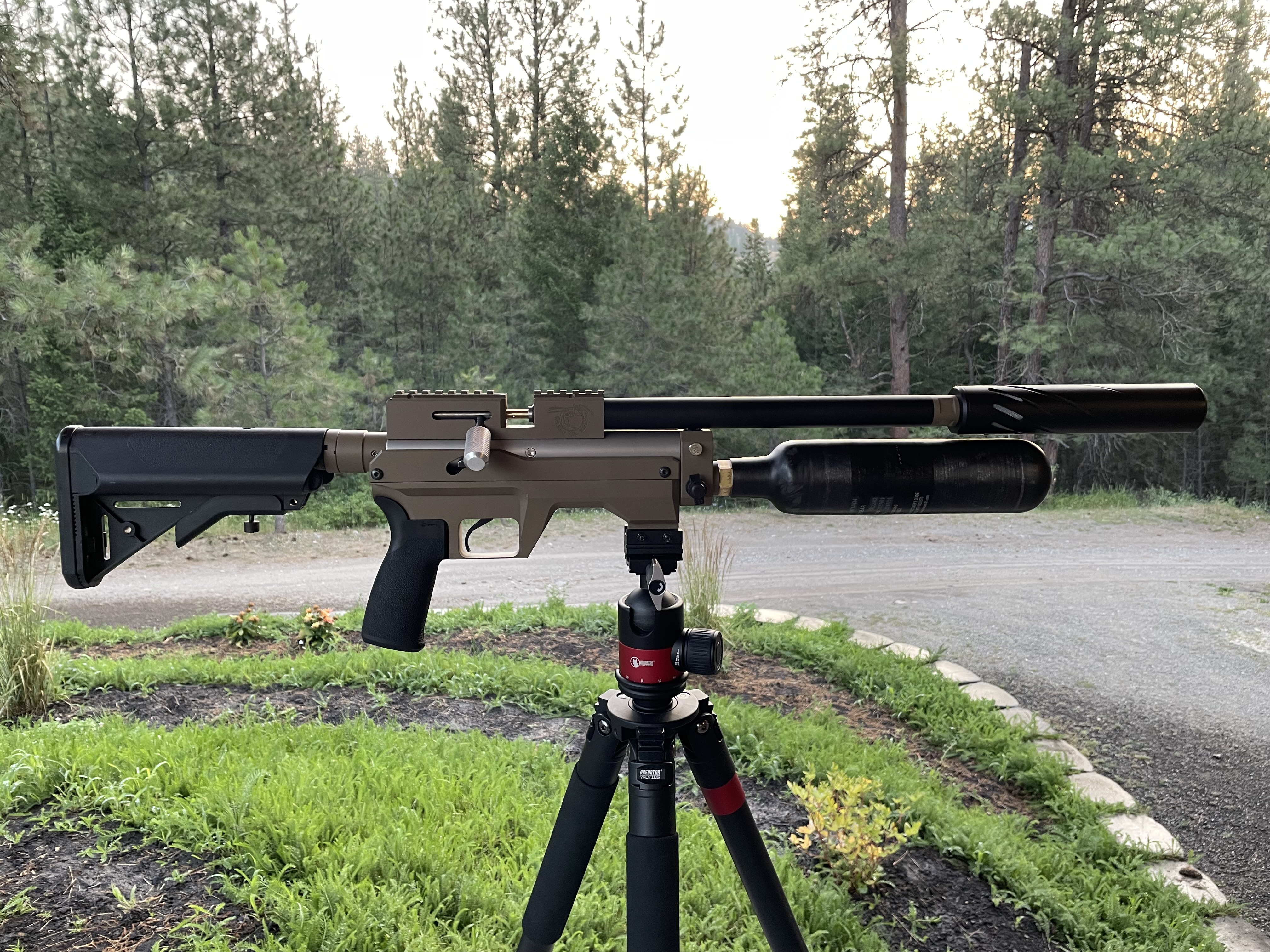

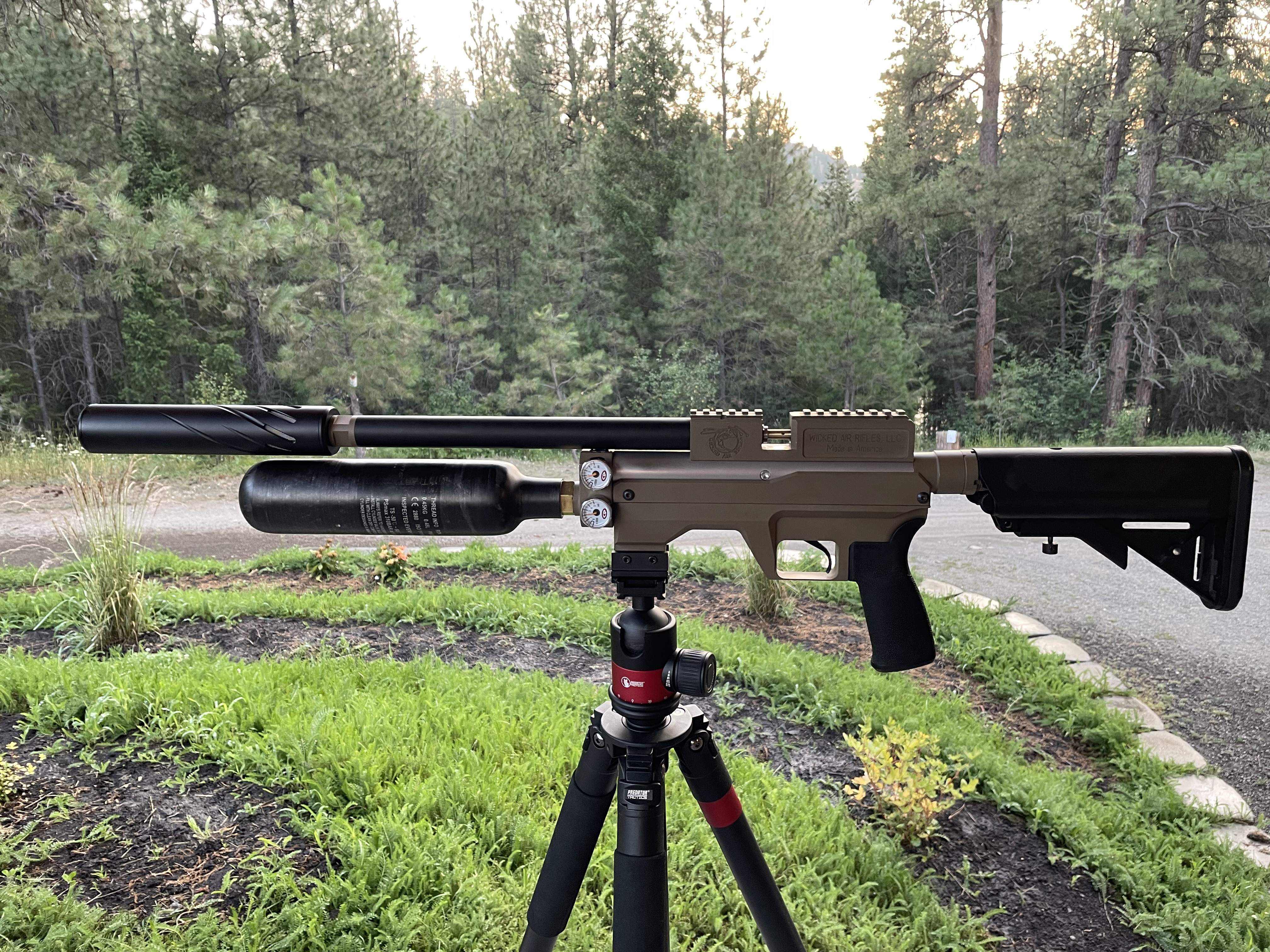

I got my 12” .30 barrel, probe and Huggett Magna installed last night. I also replaced the Cobra valve with a Cothran Powerhouse valve. I’ll have some numbers soon. I’m loving how compact it is. Hits the steel really hard too. Gotta love the .30.
Shooting 800 fp/s for a total of 28 shots on the regulator. Reg is set to 2100 psi shooting down from a 300 bar fill. I’m sure I could squeeze a few more regulated shots from it, but 4 mags is about perfect. Maybe I’ll get a 580cc bottle for it in the future. I tried a 700cc bottle, but it was right level with the end of the moderator. What do you think of the 700cc bottle? Too much?

Shooting 800 fp/s for a total of 28 shots on the regulator. Reg is set to 2100 psi shooting down from a 300 bar fill. I’m sure I could squeeze a few more regulated shots from it, but 4 mags is about perfect. Maybe I’ll get a 580cc bottle for it in the future. I tried a 700cc bottle, but it was right level with the end of the moderator. What do you think of the 700cc bottle? Too much?View attachment 371396
I say run it as is if you like the shot count. Not a bad look IMO.
But I do have strange tastes...
An 11.5" barreled 30fpe .22
A 12" barreled 100fpe .357
