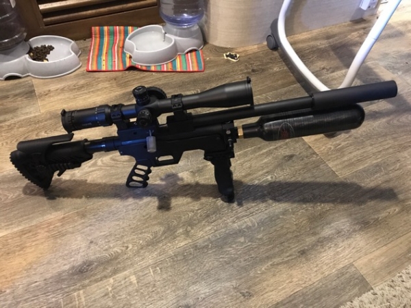

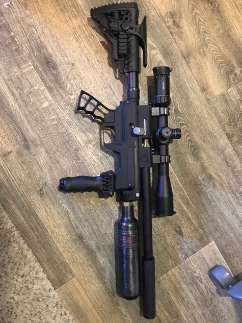

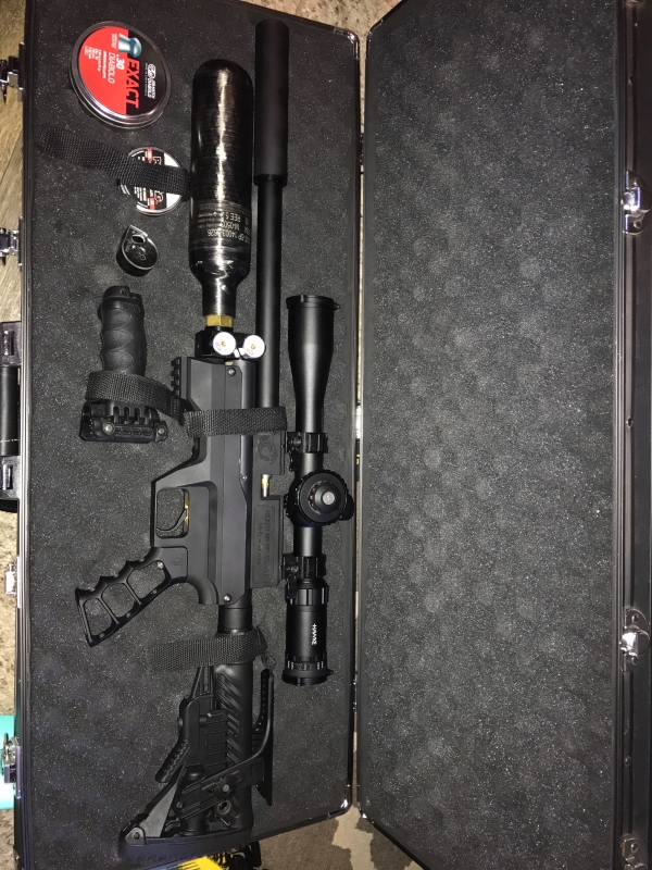

Well I'm finally finished with my warp! I have everything I want on it. I have the fab defense stock and foregrip which doubles as a bipod plus the skeleton grip and hawke sidewinder scope with 20x reticle. All of this in a package of .30 cal with a regulated 60fpe gun that is truly a joy to shoot because it is a solid built gun with no cheap frills! It is a real American mad Air rifle with the newest innovations such as the cobra kit! It will get over 40 shots before it drops off reg and has an ES of 8 fps. It is a laser out past 100 yards and shows up some of the best air rifles this world has to offer! This is my 3rd WAR rifle and I enjoy how compact it is, fits in a case that is 32" od and has a great balance point. Going out and shooting off hand is a nice thing and very simple to shooot. Could not be more happy with this pure American made air rifle. Thanks to WAR for giving me my 3rd Air rifle I will never sale!
