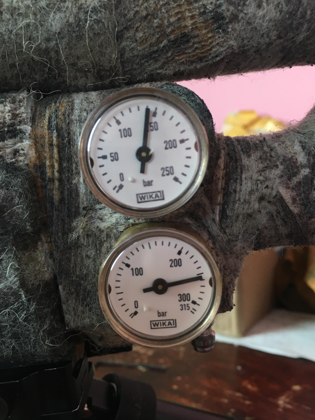

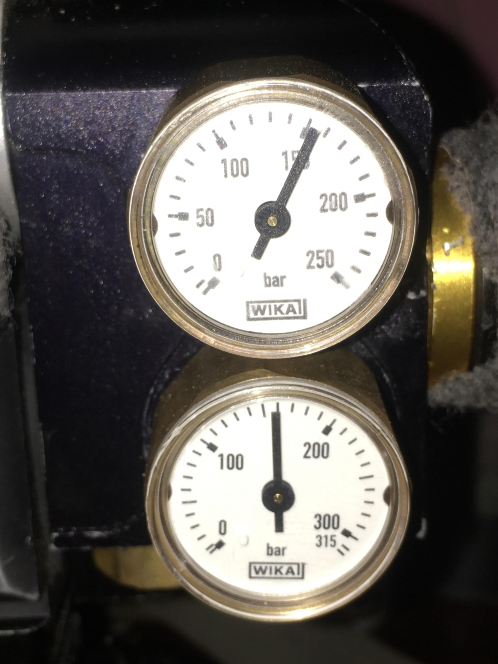

I was watching Florida Bullfrog on YouTube and in talking about his WAR he mentioned the regulator had 2 gauges one showed the tank pressure and the other what it was set for. He has it set for 2200 psi. In effect wouldn’t that be like keeping a non regulated gun on a 2200 psi tether. Can some explain why that setting is used? On all of my regulated guns they are set from 110 to 150.

You need to convert bar to psi. A 2200 psi set pressure is approximately 151.6 bar. You can tether a non regulated gun to a fixed set pressure (2200 psi) but that source (air tank) would have to be regulated to maintain that pressure, thus you have a regulated tethered gun.

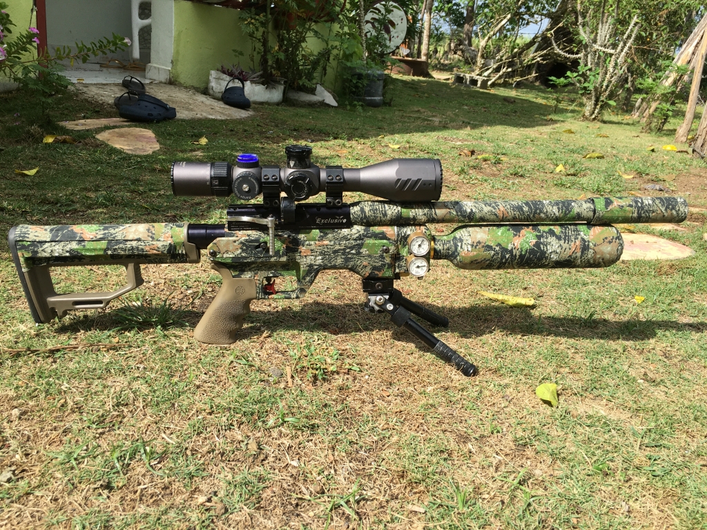

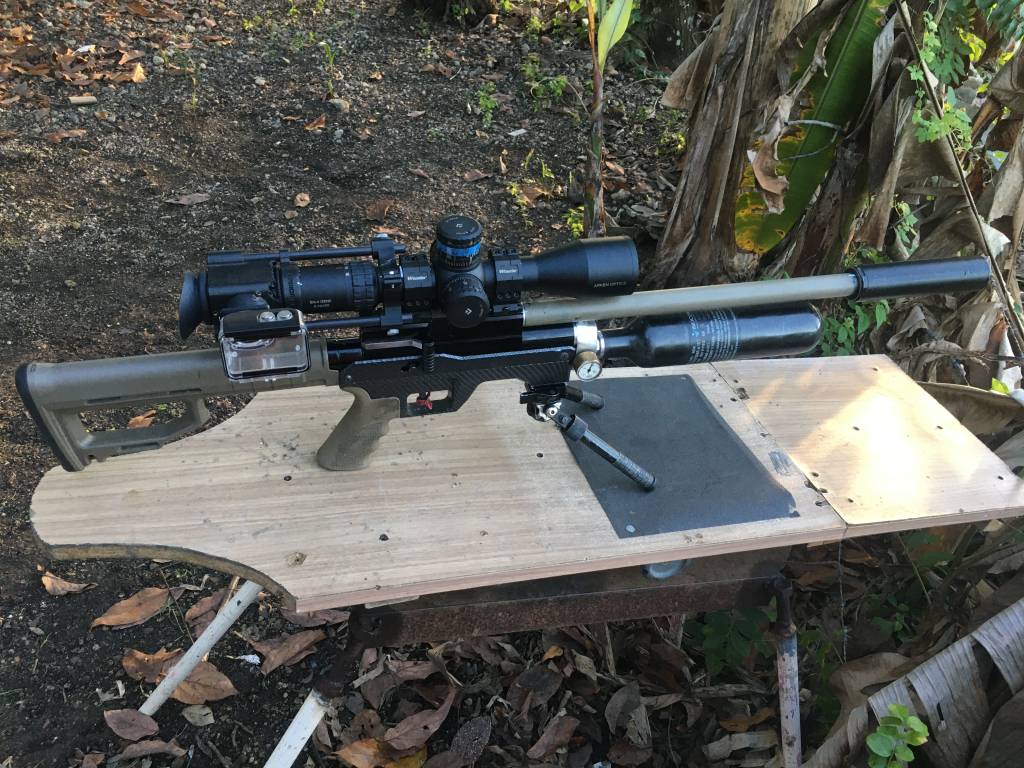

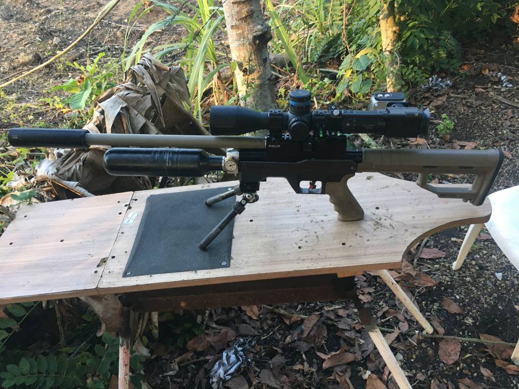

hello everyone today I share the new Warp hi LR modification with a 7075-T6 aluminum complete block and with double regulator you can see more on my YouTube channel AirGunLR and on my Instagram, I can show you more photos and videos and you can see what what it does with a barrel tj .250 at long range with the slug jsb knockOut .251 at 920fps with 33.49gr this new Warp hi LR I manufactured it for long range shots
