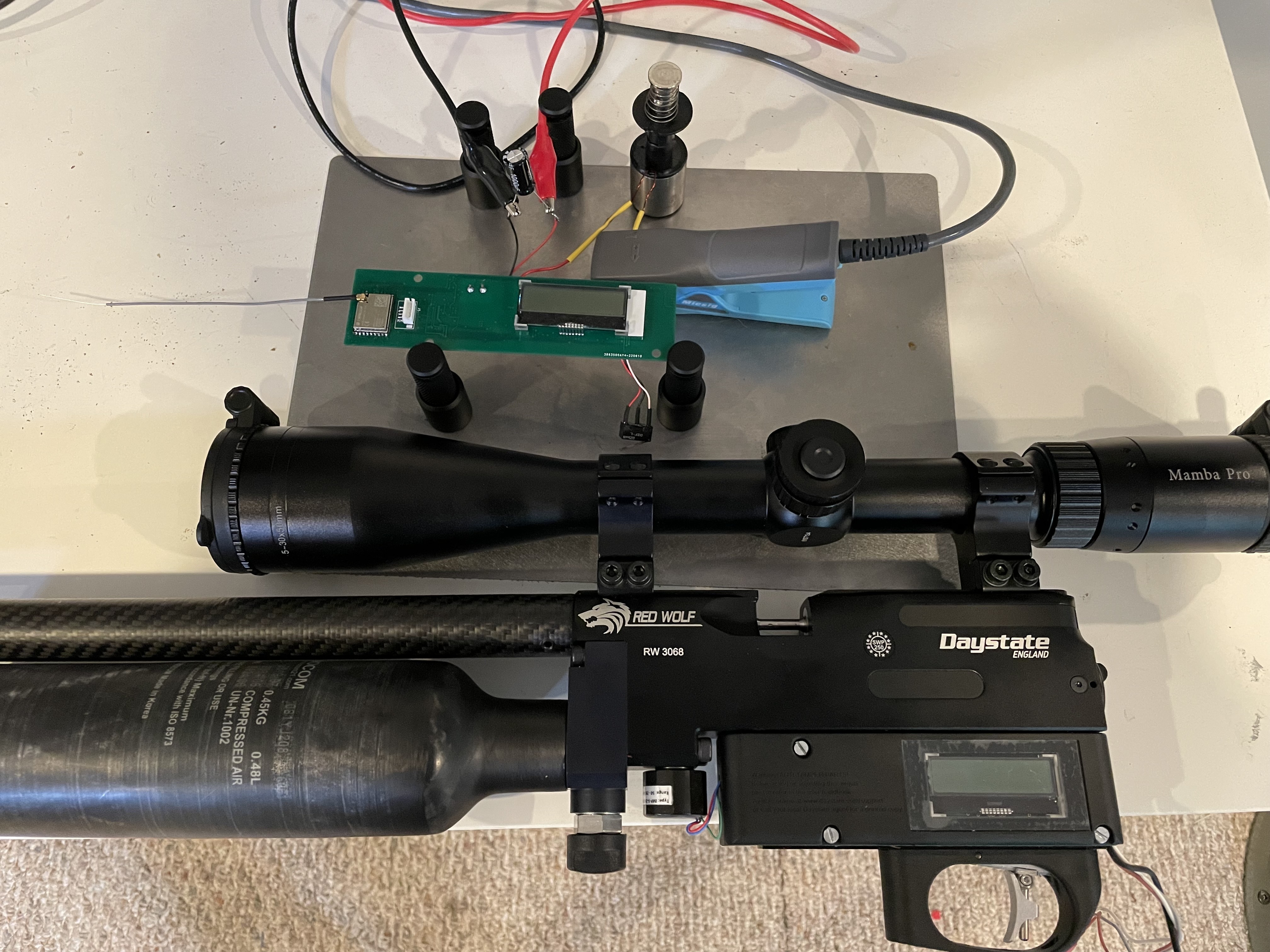

Instead I decided to build my own GCU (with blackjack & hookers) and today I have finished assembling the first working prototype. I thought it might be interesting to show you the GCU operating on my bench
The final "shot" in the video actually breaks the plastic of the solenoid and the hammer stays stuck down. Tomorrow I'll put the board in my Red Wolf and see if it shoots

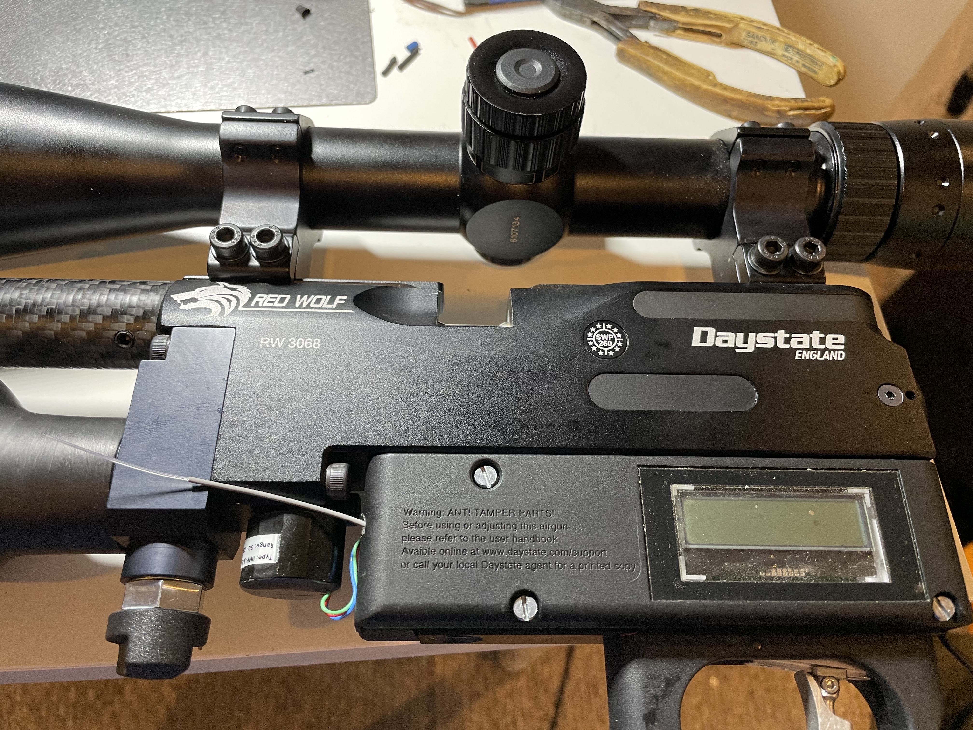

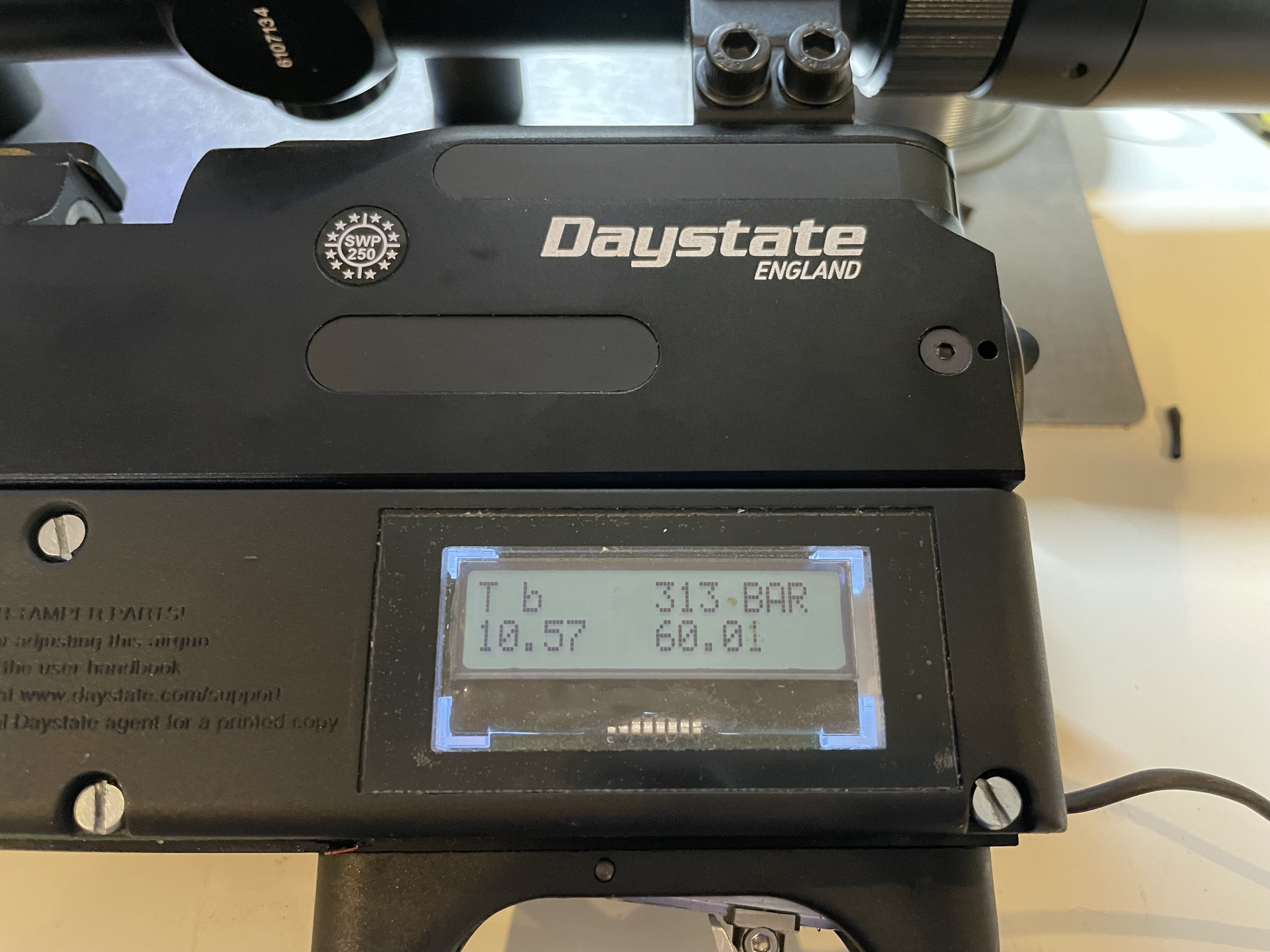

I fitted my GCU to my 25 cal standard power Red Wolf and put 10 pellets through it. I should have recorded the target too :)
Testing in Wolf's clothing

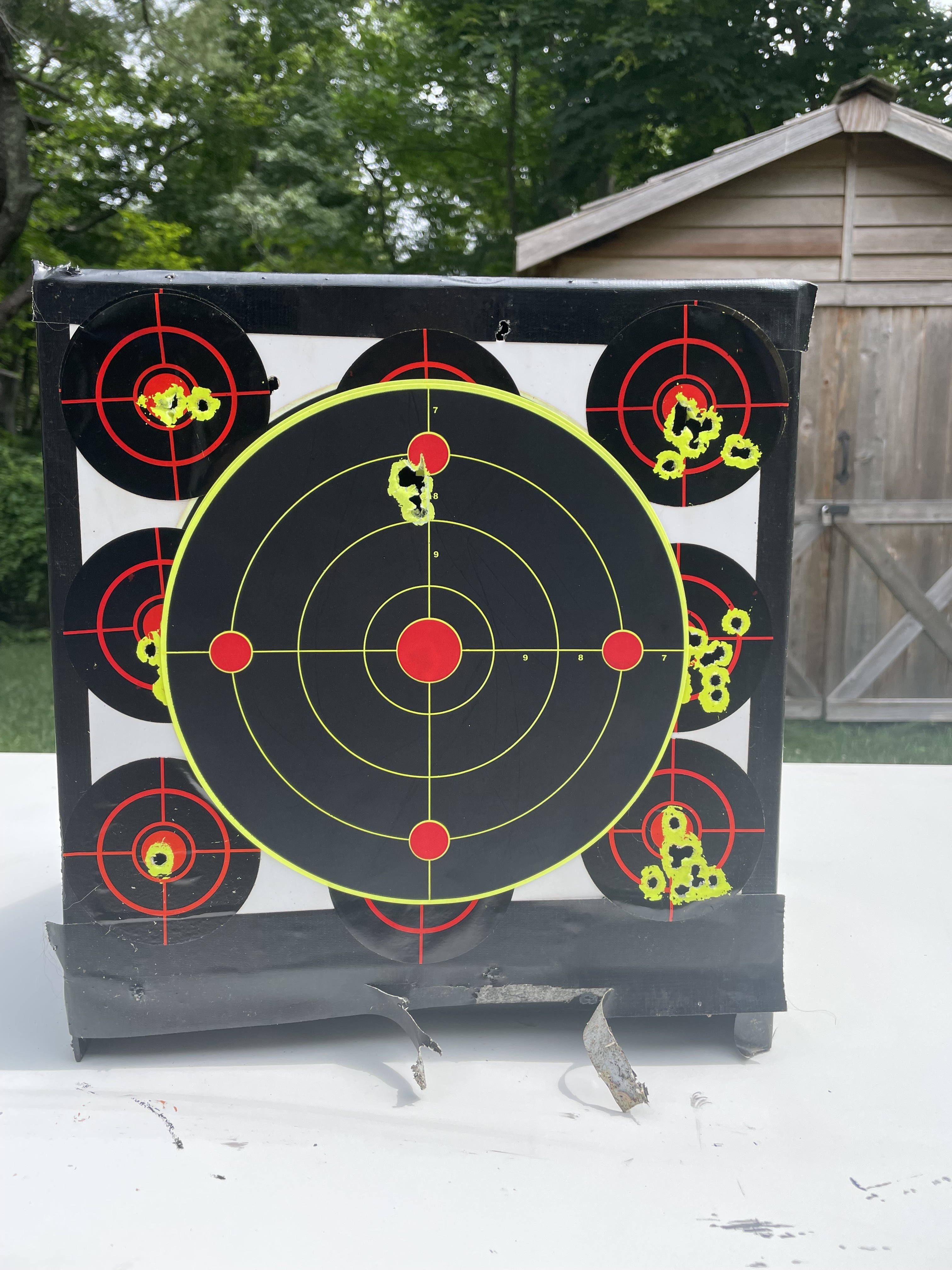

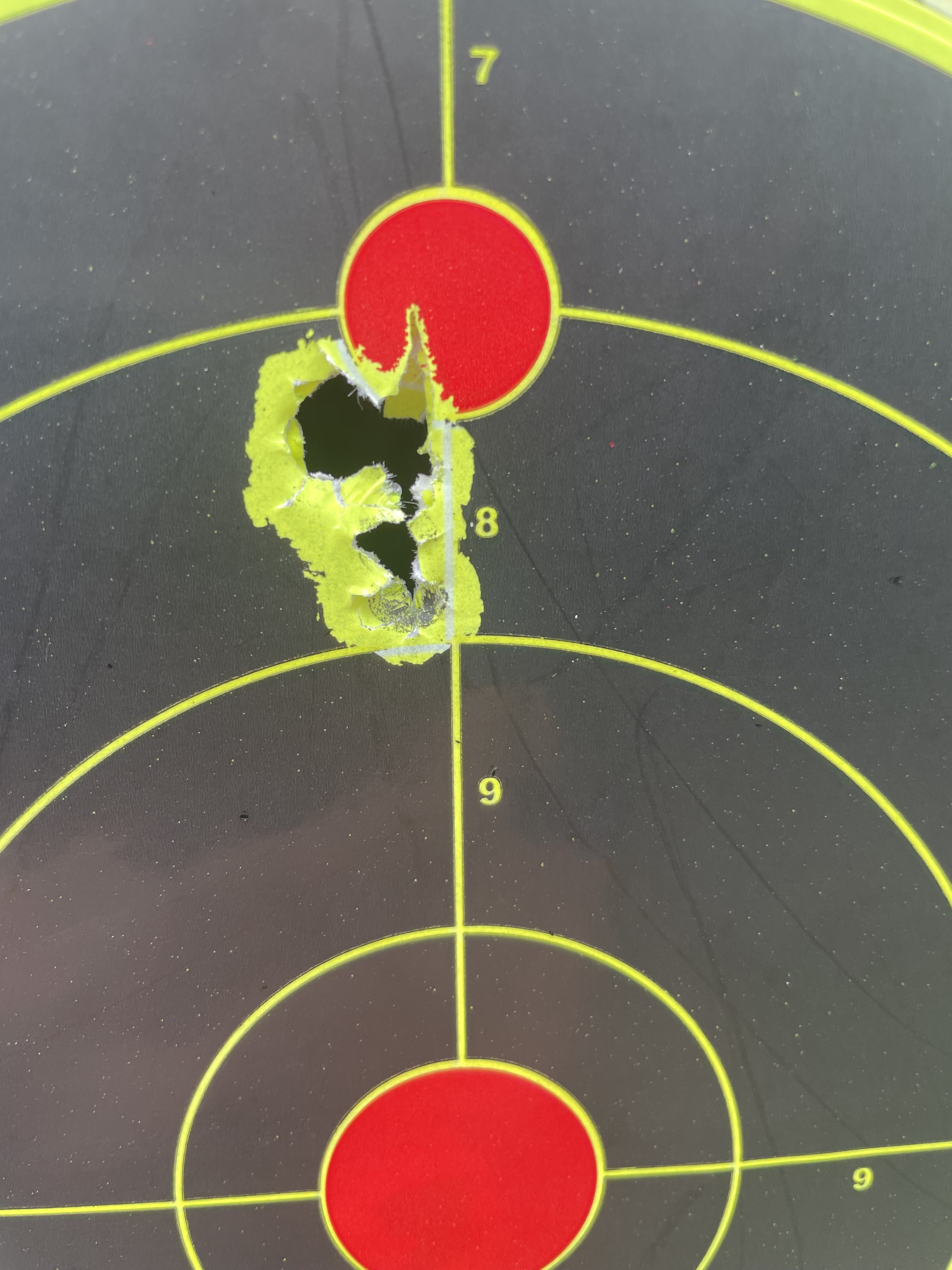

The target was 20 yards down range, every pellet hit the trap and I can't swear to it but I think all 10 are in that group

And why is the antenna on the bluetooth so large?
You can use on board antennas but you have to leave an area under the antenna free of copper, that's difficult to do here because there aren't many ways to place the ESP32 module. In the end it was just easier to have an external wire antenna
