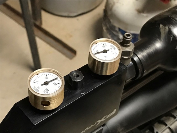

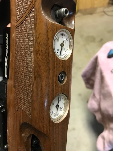

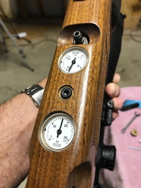

JKing, Received the Wika Gauge yesterday. Used fat o-ring on top of flat disc like you said. Indexed perfectly. Here is picture today after filling to 220 bar yesterday. So looks like that is the ticket. I swapped dust covers with my older Wildcat as it has the removeable inner piece. The Wika fits w/o removing the inner ring. Guess I could take it out. Better than removing material off dust cover or gauge. I doubt you can get those old style dust covers anymore, but maybe.
